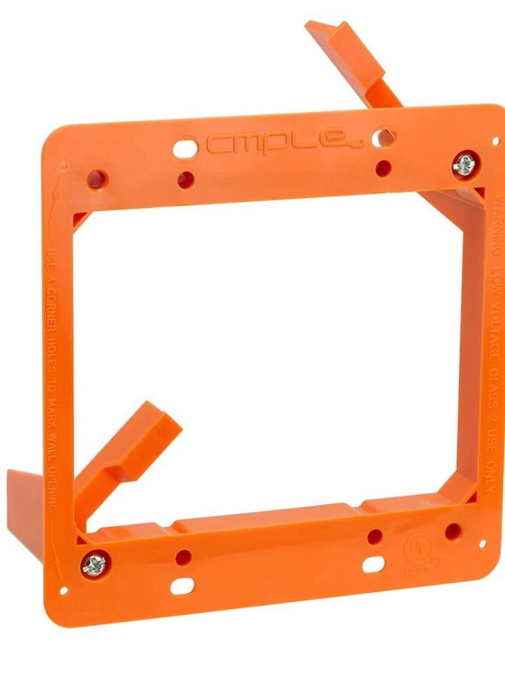

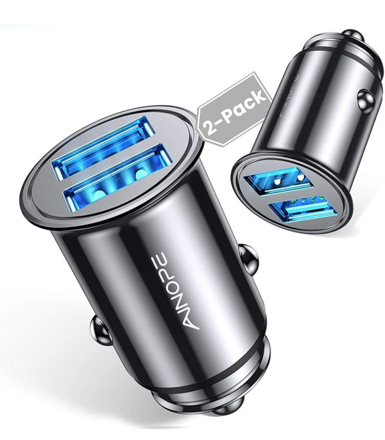

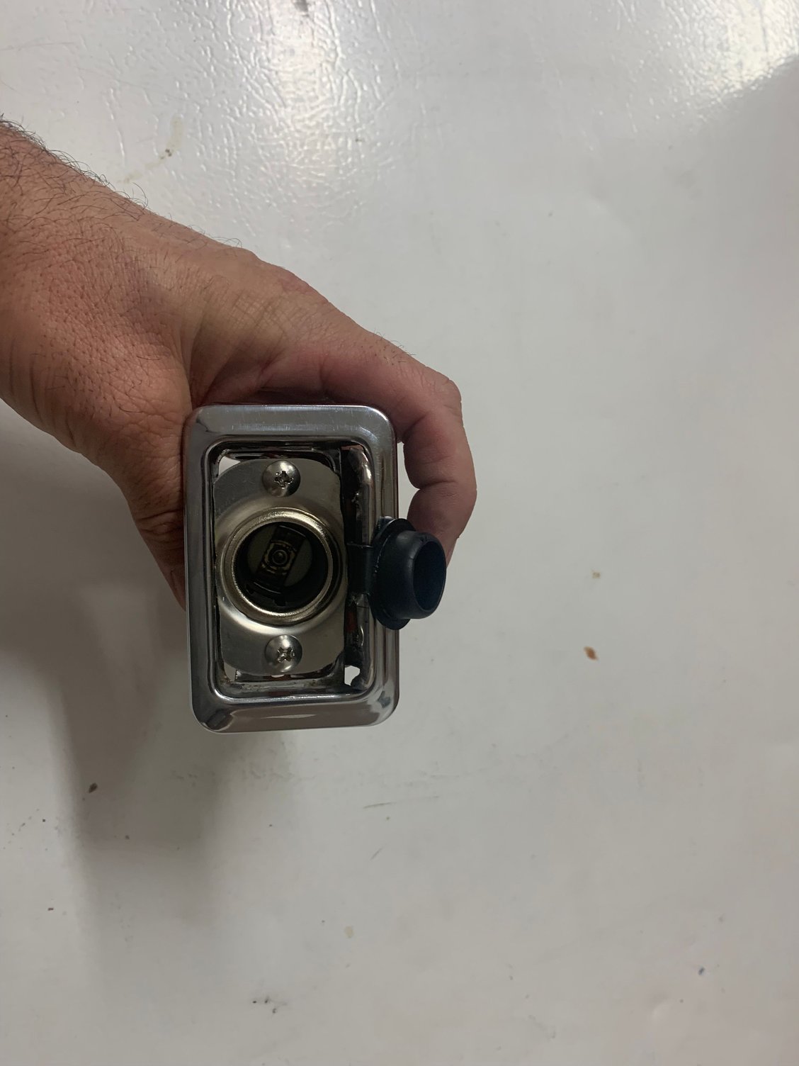

I saw a few other post on this subject recently which got me interested in installing USB chargers in place of the rear ashtrays and front cigarette lighter. My car is a 1970 Cutlass Supreme Convertible. For the front I found a nice USB adapter that has USB outlets and a voltage display. The voltage is off about 2 tenths compared to my fluke directly to the battery. Close enough for me seeing as I only have the ralley pac gauges which aren’t terrible accurate either. I adapted some universal cigarette lighter to fit inside the rear ashtrays. They came with a 1.5” x 2” stainless plate. I had to grind the edges down to just over one inch so it would fit, then I used the wings off a low voltage electrical box to grab the underside of the ashtray housing. After carful trimming the lid even closes with the cover on the outlet. Now I just need to wire them up. I ordered some car chargers with dual USB ports which should be here next week. The front USB was around $20, rear USB adapters about $10 each and the universal cigarette lighters were about $10 each.

Hey Matt, I’m pretty sure your post was one of the ones that inspired me. If I remember correctly you welded a plate to mount the lighter, I don’t have a welder so I had to get creative. I think it turned out pretty good though. Question for you, where did you wire them up to? I am planning on running a new wire, since my carpet is not installed yet it should be pretty easy. I just haven’t decided where I’m going to connect it yet.

I did the same thing to my ‘66 Starfire when I upgraded the rear ashtrays. Nice hidden feature. Clever reapplication of those mud ring flippers!
