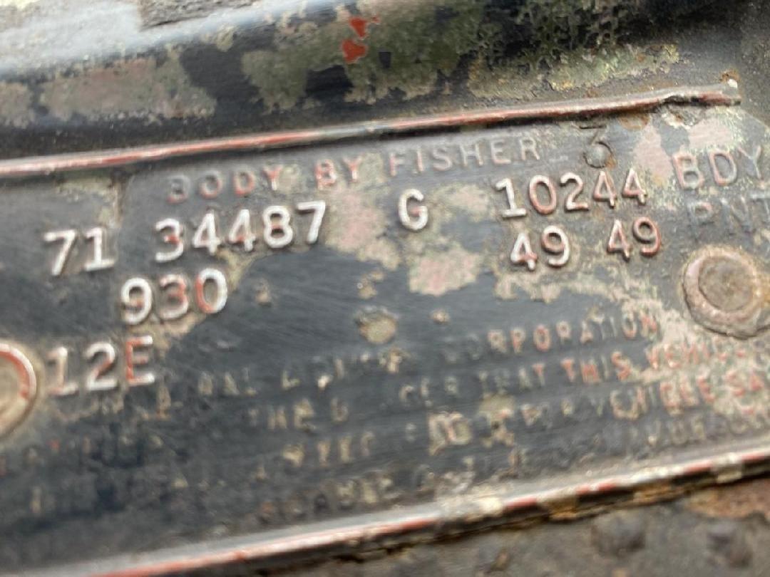

Another Cowl tag to decode
What can you tell me about this?
Looks like Antique Jade for the color.

ST 71 = style/model year = 1971
34487: 3 = GM division = Oldsmobile; 44 = model series = 442; 87 = body type = hardtop coupe
G = assembly plant = Framingham MA
10244 BDY = Fisher body number (has no relationship to the VIN)
TR 930 = interior color and front seat type = black interior with bucket seats
49 49 PNT = lower and upper body colors = antique jade in both instances
12E = time build code = December (12), fifth week of that month (E), 1970

What is it on?

On the cowl below the windshield...
A nonmatching number, 4-speed, rough condition 442 I am considering taking a look at.
