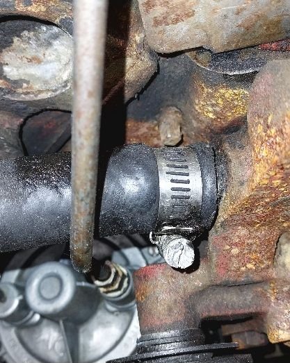

Is that it?
Old Dec 10, 2025 | 04:54 AM
Posts: 18,227
That is the top of your fuel pump and the fuel line that goes to your carburetor.
Zoom out. You can also see the passenger's side head in that pic.
Old Dec 10, 2025 | 05:01 AM
Mikeyt's Avatar
Mikeyt
Joined: Apr 2024
Posts: 356
From: NC
That too but I'm talking about the square head plug behind the hose.
Yes that is the passenger side head

Driver side front. Locate the flat with the casting number between the back of the water pump and front of the intake, under the thermostat housing. It will be on the right side of the flat.
This is what I'm looking at. I can't find the flat you're referring to. I don't see any plugs on that side either.

Driver side front of block.

Mike, I think most have missed the fact that you have a 394 CID motor. I suggest you contact Charlie Jones for the correct location of the oil pressure port. However, you may want to look at his build thread which is as of this moment at the top of the Major Builds and Projects forum and back up to post 220 where he has two videos of initial start up of his 1963 Olds. Since the body is off the frame in these videos it is easy to see that he has plumbed a pressure gauge from the top of the oil filter housing.
Thanks!
I kinda figured they were talking of a different engine.
I just now found a thread on jalopy journal and it confirms the only place for it is on top the oil filter adapter.
I'm gonna log into Charlie's build thread for future reference.
Thanks again👍
