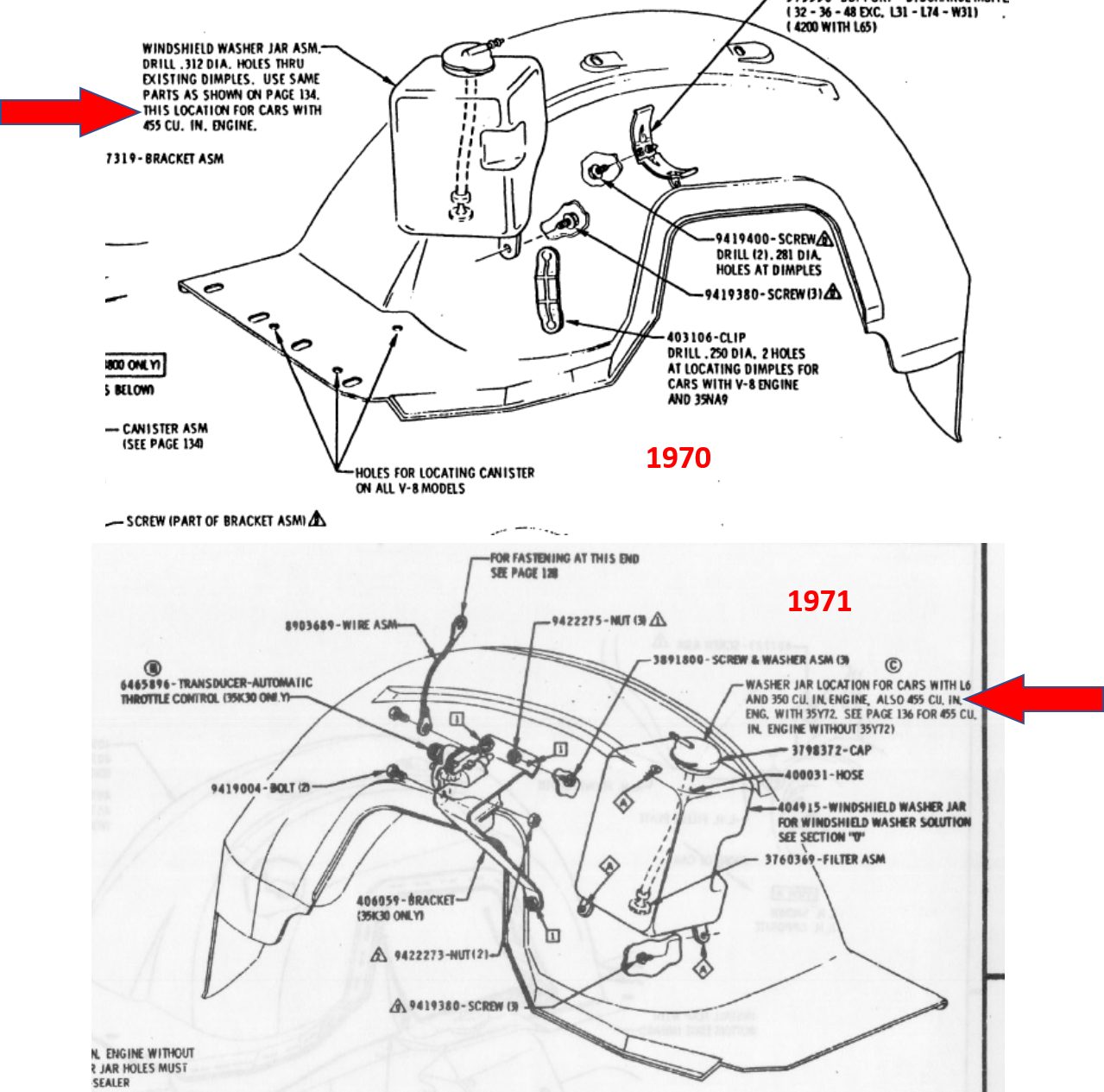

There was a GM designed system. Fusicks sells a replica. This is what could be considered an original-style replica of a dealer accessory.
Old Jan 13, 2022 | 09:36 AM
Reservoir Package, technically listed for the 1971-72 cars. Interestingly, for 1970-earlier, all BBO A-body cars had the windshield washer tank mounted on the passenger side inner fender due to the larger R71 battery. This conflicted with the overflow tank placement. In the 1971 model year, The washer tank stayed on the driver side for A-body cars with BBO and RPO Y72 HD cooling. I believe the 71-72 tanks have a notch to clear the corner of the R71 battery.

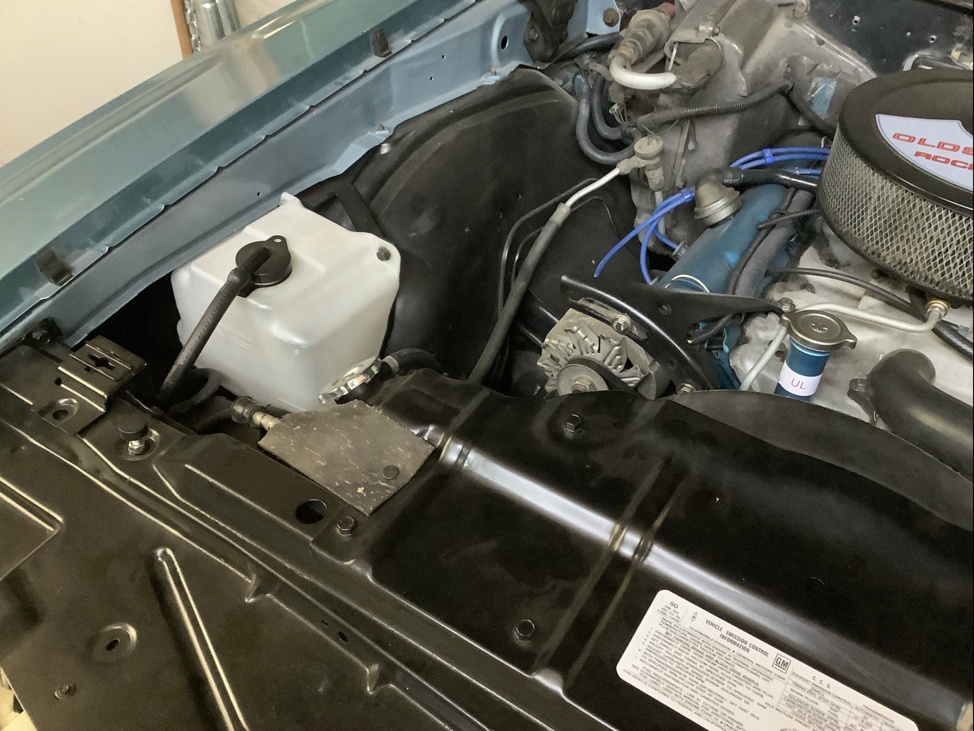

Heres a pic that shows my dorman one, theres plenty of others from them, i just picked one and adapted it

For 35 years I’ve been using OE washer tanks as overflow tanks on small block cars (apparently), mounted exactly like the washer tank on the right fender liner in Joe’s diagram. IIRC some have been black, some “white” depending on the donor car’s model year. Worked and continue to work like a charm but not gonna get you any points at the Olds show.
