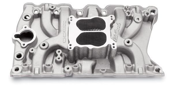

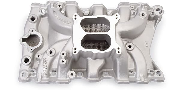

Joe, am looking at two different one's on summit and trying to decipher the difference if any. One says "performer rpm" and one says just "performer" is there truly something different between the two?
Old Jun 15, 2017 | 11:54 AM
Posts: 50,802
Yes, they are completely different intakes tuned for different operating ranges. Edelbrock's web page describes the different design RPM ranges and has photos that show the runner differences. The RPM has a taller carb mounting surface and larger, more direct runners tuned for higher RPM performance. The Performer is only a marginal improvement over stock. I would only consider the Performer for a small motor like a 307 or a heavy car like a Delta 88. The RPM will be a better choice for your application.

Summits catalog descriptions arent always correct. Both the RPM and the standard Performer are dual plane manifolds,but the Performer is for stock level rpms and the RPM is for higher performance
Old Jun 15, 2017 | 03:20 PM
Posts: 15,409
Be aware that the Performer RPM does not have a provision for the factory hot air choke, so you would need to convert to an electric choke. That is a very simple modification - a basic install just needs an electric choke coil and a length of wire to a 12 Volt switched power source.

I am liking my non filled heads #6 heads much better than filled #6 heads. They ran terrible in cold weather. The 2711 non EGR version of the Performer also doesn't have the hot air choke provision. I had a 3711 Performer lying around, I added a 1" open aluminum spacer. I open it up to better match the intake opening. My combo is borderline, maybe I should have just grabbed the RPM off the shelf instead. The RPM is 2" taller FYI.
