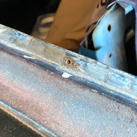

Screw holes in the convertible pinchweld (70-72 model years)

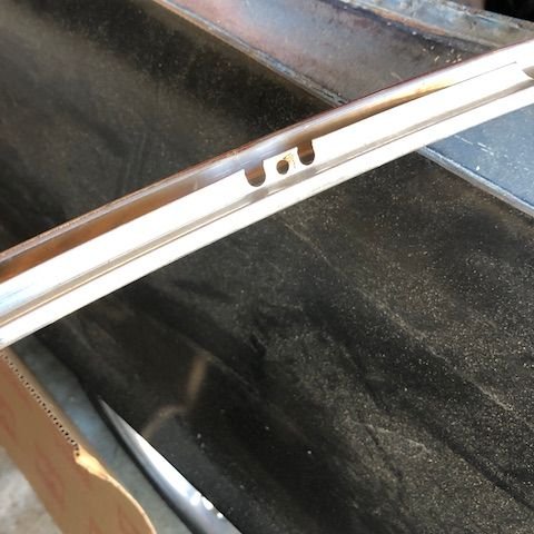

Tabs on the pinchweld molding. The screws go thru the holes in the pinchweld tabs from the inside of the top well.
