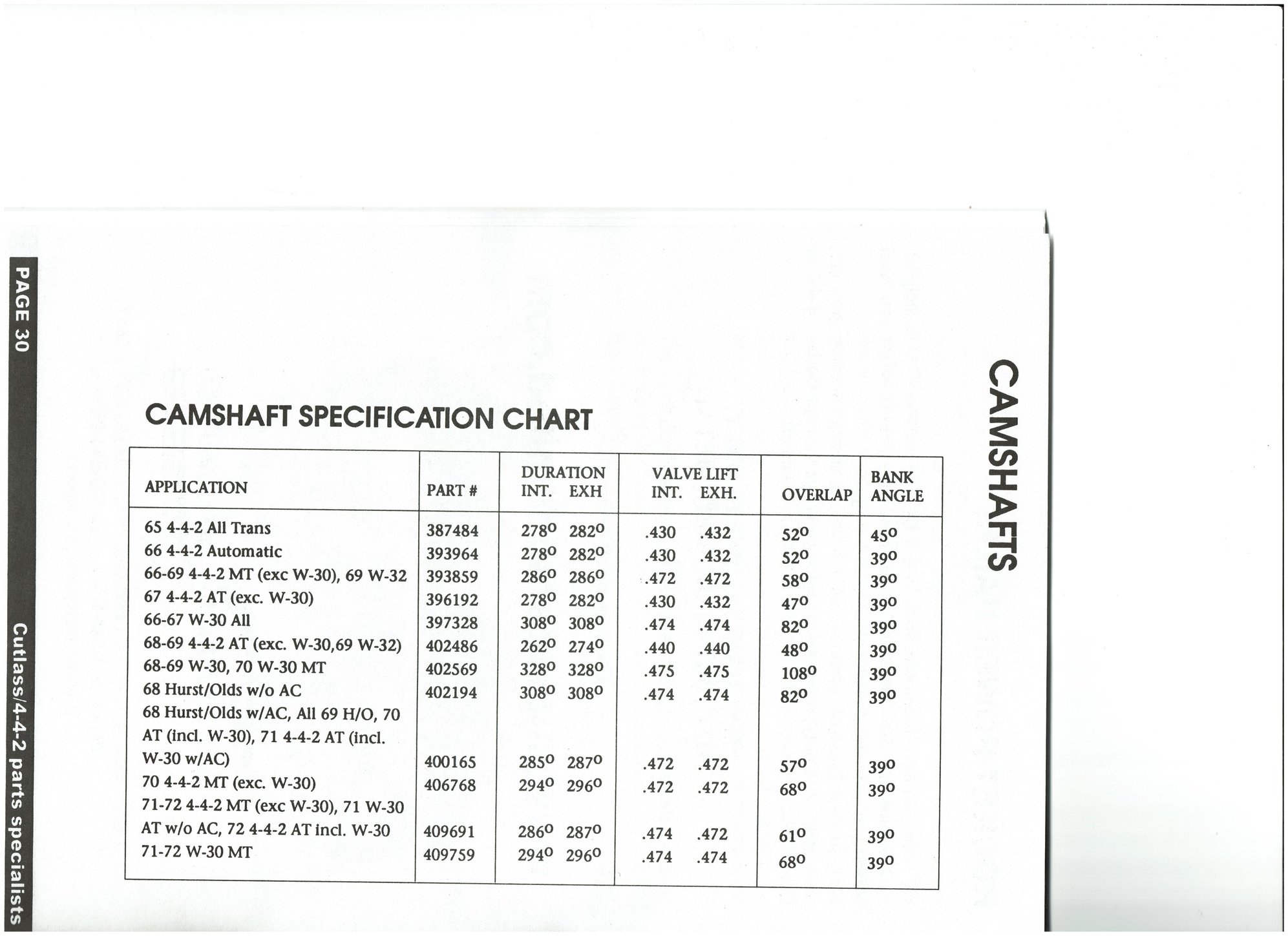

The '71 442 auto trans uses a different cam than the '72 auto.
Old Jun 22, 2021 | 10:07 AM
Posts: 9,483
Old Jun 22, 2021 | 10:09 AM
Posts: 9,483
'71 auto uses 400165, '72 auto uses 409691. Overlap seems to be the biggest difference.

Ok, there's the difference then. People think the pistons got changed or something for the apparent drop in HP.

The problem is that you are believing the published HP numbers. In prior years, Olds made a point of noting the lower HP in the 442 AT motors (325 HP vs 350 HP in the 1968-69 cars, for example). They did not do that in the 1971 specs. The 270 HP/370 ft-lbs (net) shown for the 1971 442 is exactly the same as the 270 HP/370 ft-lbs shown for the 1972 MT motor. Wanna bet that the 1971 AT motor made the same 250 HP/370 ft-lbs as the 1972 AT motor?

The differences between the 71 and 72 cams is in the noise. As for the accuracy of the factory ratings, do you really believe that the 285/287 cam in the W30 AT motor made the same HP and torque as the 328/328 cam in the MT motor? Or that either of them made LESS HP and torque than the Toro W34 motor (with the same 285/287 cam, E heads, and the crappy Toro intake and exhaust manifolds)? And if that's true, why did Olds waste all that money on the unique W30 parts to make LESS HP and torque?
