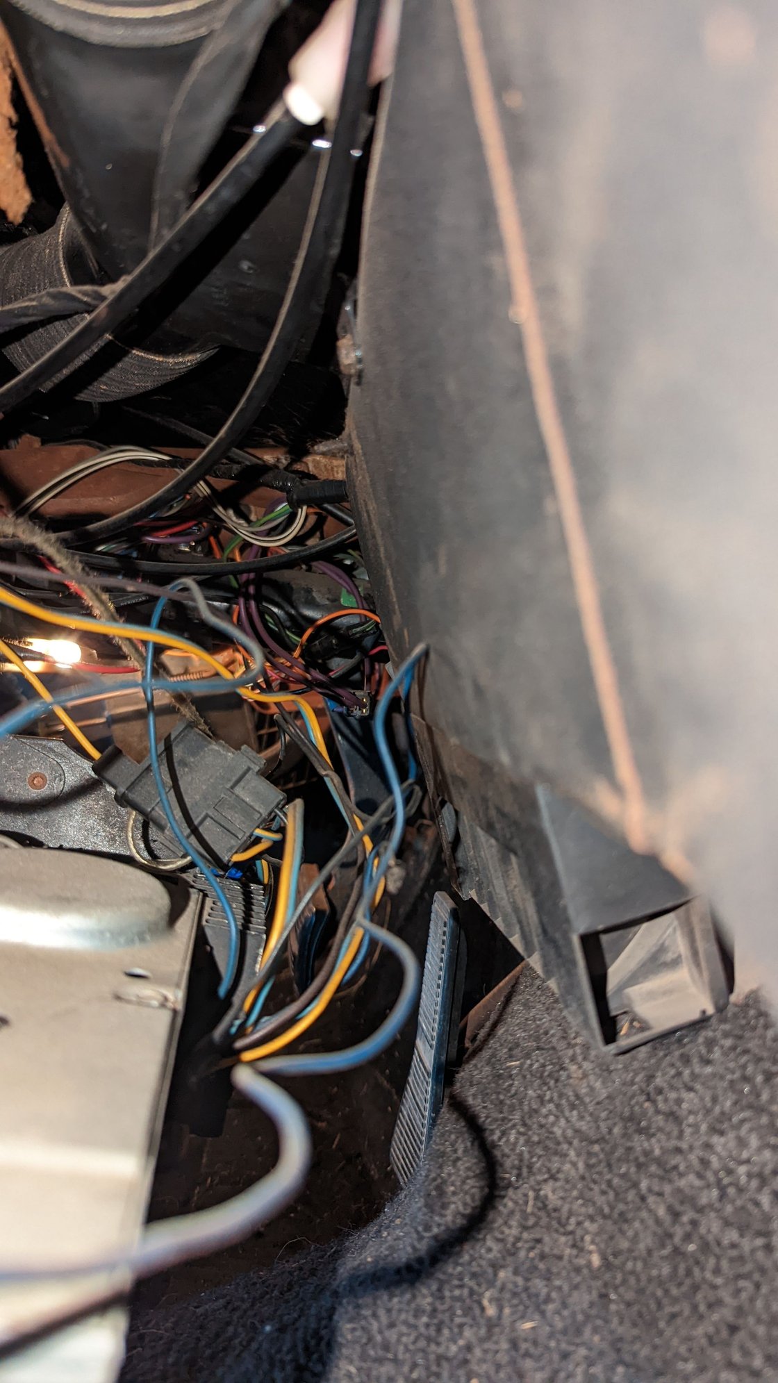

Here's a couple of photos.
Top bolt of side bracket. This up under the dash.
Screw holding 8-track housing and round smooth both head that is other side of the above bolt picture. The appears to God the 8-track to the dash.
​​​​Speaker connectors
behind 8-track housing
Speaker under passenger side dash

Unless you’re a very skinny and flexible person, remove the front seat. Put a heavy blanket on the floor, otherwise the seat mounting studs will shred your back.
Remove the *****, the nuts that retain the radio to the mounting plate will be visible. I’m sure there will be a support bracket to hold the back of the radio. Once your in a position where you can actually see under the dash it should be pretty obvious how to remove it.
