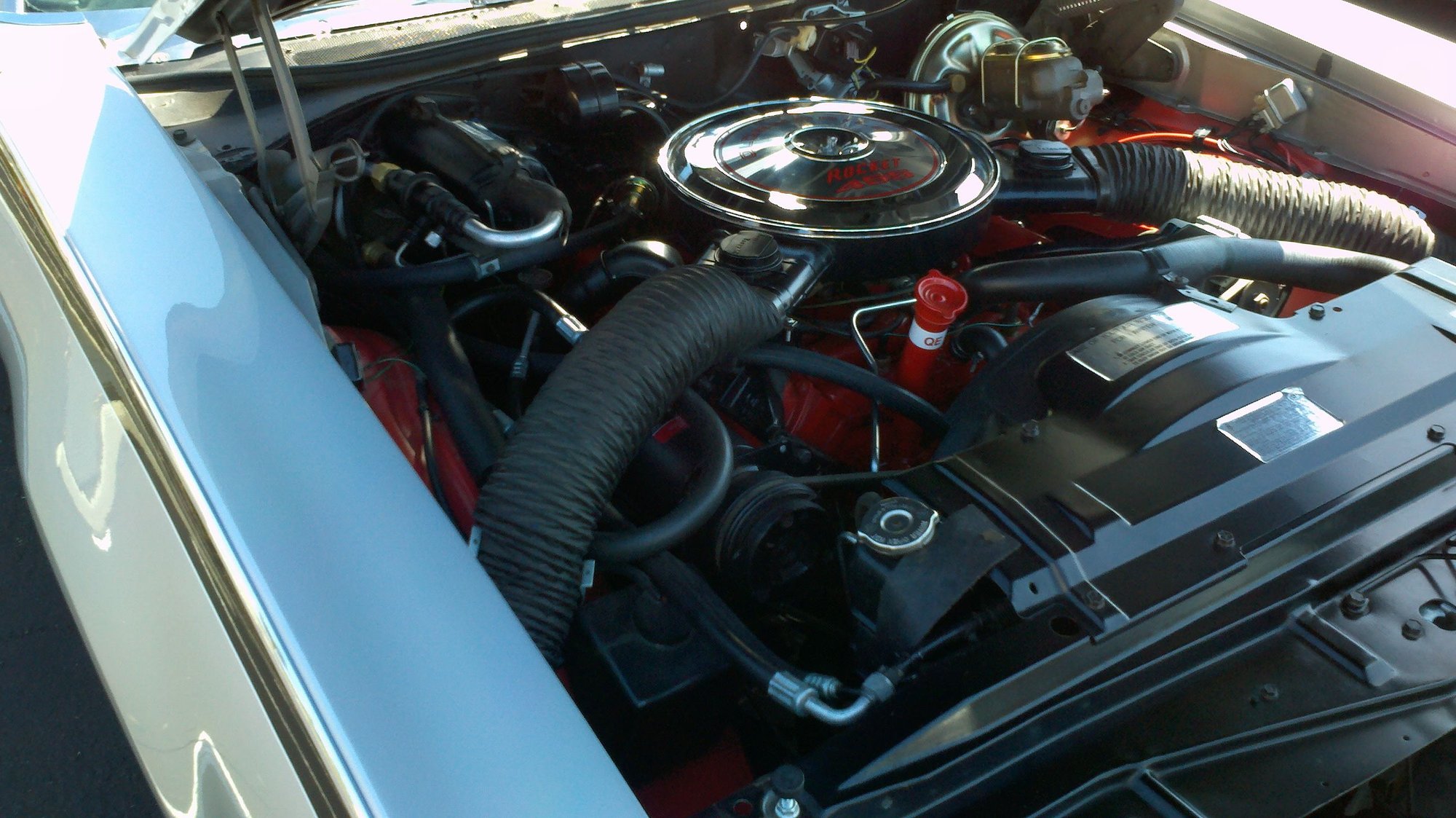

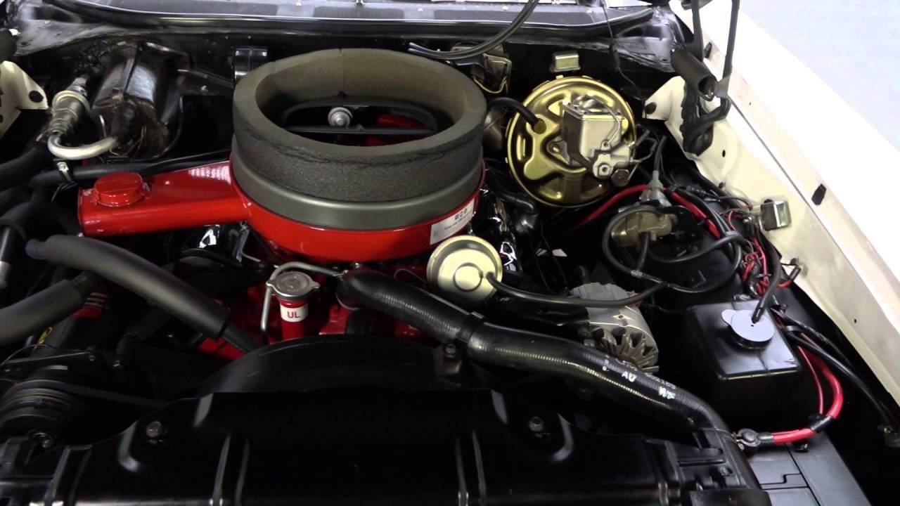

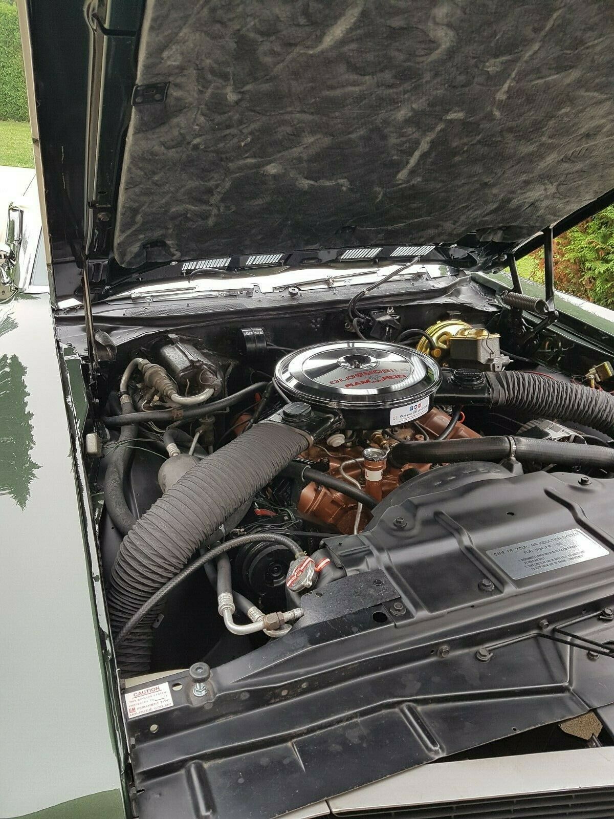

Joe, so the 68 H/O's with AC I think had the same AC OAI collision issue, but, being an converted car, I guess they rolled with it. Hose did look a little smushed on the one I looked it.
The heat riser adapter to the air cleaner snorkel was also sent to Demmer in the trunk, and hammered flat until it cleared the compressor. So it was a bit crude.
Old Aug 14, 2019 | 04:44 AM
Posts: 12,810
Thanks. I've got the OAI setup for my 67 which I want to hang on it. I think I will have to flatten the hose over the compressor, but at least they had no heat risers.
Old Aug 14, 2019 | 05:10 AM
Correct. The 68 H/O was the only 66-69 O.A.I. car that ever came with A/C, and if you've ever looked at one closely, you can see why. It actually isn't the hose that's the problem, it's the hot air adapter under the passenger side snorkel. Demmer had to beat them to crap to get them to clear the rear bracket on the A/C compressor.
Old Aug 14, 2019 | 05:46 AM
Posts: 12,810
Did the 69 have the same issue of the riser?
Old Aug 14, 2019 | 05:54 AM
Not on the H/Os...
Of course, you couldn't get A/C on any other 1969 Olds A-body with O.A.I. The dealer-added A/C on the W-32 discussed in this thread would have the same problem, though the shape of the hot air adapter is different from 68 to 69. From this only photo of the 69, I can't tell if the adapter is even in place under the snorkel.
Old Aug 14, 2019 | 06:11 AM
Posts: 12,810
That's what I thought, thanks.

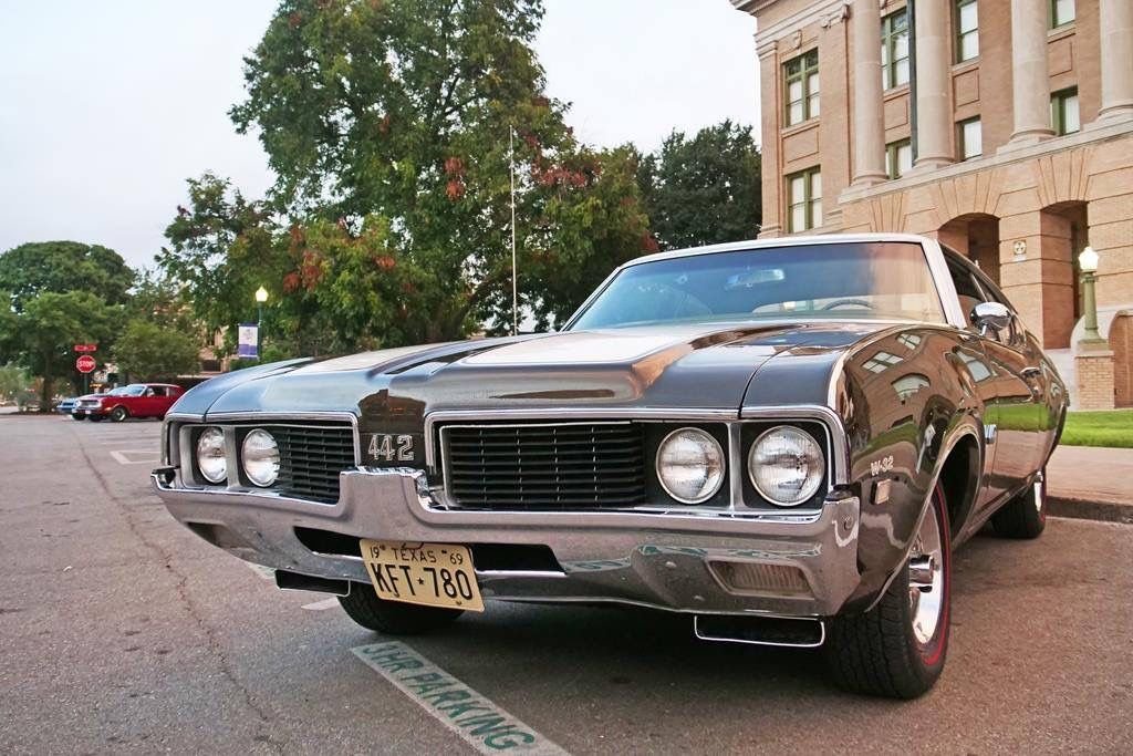

Old Apr 11, 2020 | 08:31 AM
  #32
Richard Miller's Avatar
Joined: Apr 2019
Posts: 20
From: Georgetown, TX
Just thought I'd throw these into the discussion.
Purchased last year from original owner's daughter, original except for repaint in 2017.
