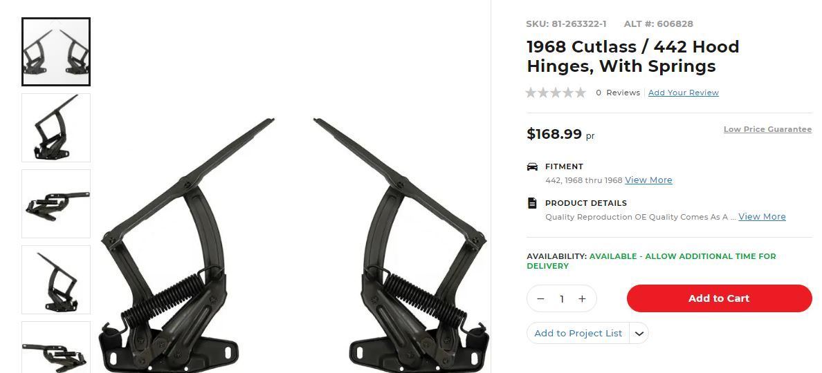

Digging online. Ecklers.com shows 68 hinges with springs.
Anyone dealt with Ecklers before??

Dont try to order these from Ecklers. They are the WRONG hinges. When they arrived they looked good but the mounting holes are wrong.
Looking further at the packaging, they came from Classic Headquarters and their labels say they are for 70-72 Chevelle.

Thanks for the info, I was debating whether to restore my originals or order the Ecklers. Guess I'm going with the restoration option.
