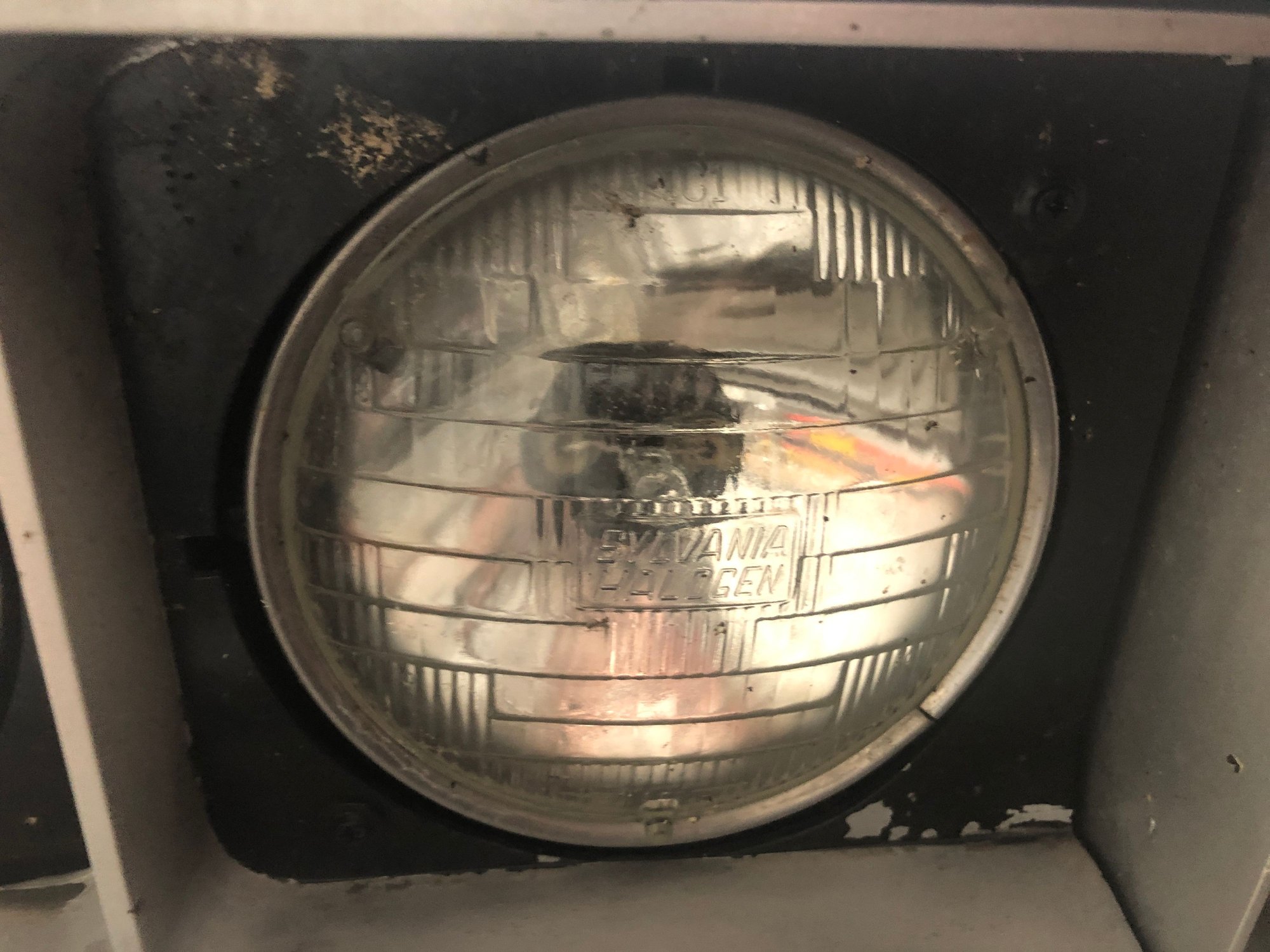

The silver paint seems to hold up pretty well, the black flakes off pretty easy. Last time I painted them I wet sanded all the old stuff off, used some Comet and a scotchbrite pad to scuff the surface, mineral spirits to clean, then laquear thinner to ensure to grease on the surface before painting. This is the current condition after 2 years
One of the little projects this winter while the Olds is in hibernation
