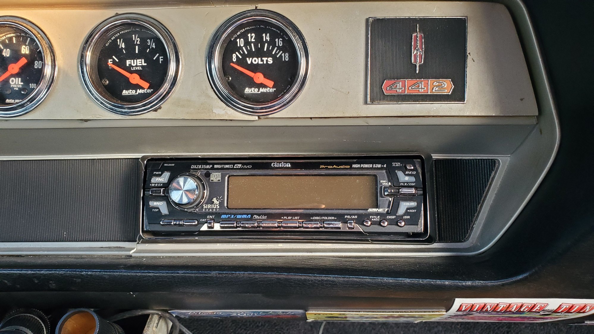

Got one in my 67. There's usually a threaded hole for a stud or screw to mount the rear on a strap or bracket, but it's not always necessary. Ignore the floor mats.

A Metra installation kit for 87-98 Chevy trucks' AC vent delete plates match the ribs in the lower section of the dash.
Also, before the butthurt starts, this dash had a broken speaker grill where the small gauges are, so nothing was ruined that wasn't already. Future plans are to make a mold and carbon fiber blank from another good one I have.

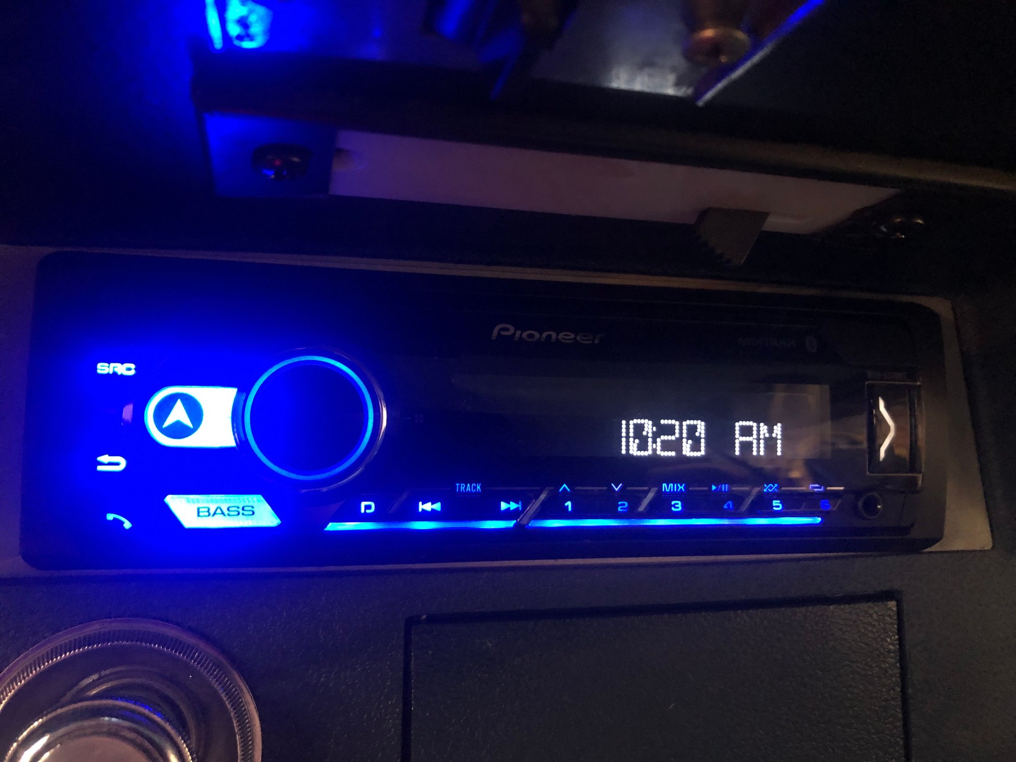

Rather than hack up my dash, I installed a double-DIN deck in a box mounted on the transmission hump ahead of the console and added kickpanel speakers. Bonus points for retaining factory AM radio functionality and if I want to revert to a strictly factory look, the head unit comes out in ten minutes' time and nobody's the wiser.
Downside: nothing to do with the deck, but the Custom Autosound-supplied kickpanel speaker housings have a resonant buzz that I have been unable to quiet.

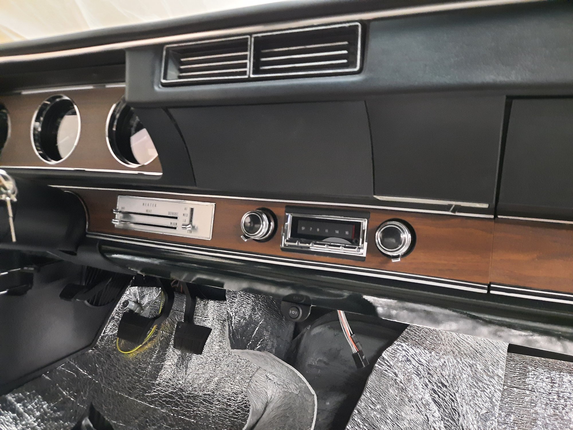

Thanks everyone for the tips. A friend of mine has a correct 68 am/fm radio I’m going to get and install. After doing some research, Most likely I’ll get a Bluetooth amp and just attach my speakers to it and do that. Thanks again for the help though guys!

I put a retro autosound long beach model in my cutlass. It’s not a powerhouse. But it works really well with some good speakers and the bluetooth connectivity is the best of any stereo I have owned. I can park the car in the garage and two weeks, when I start it up and the bluetooth picks up right were we left off in the playlist.

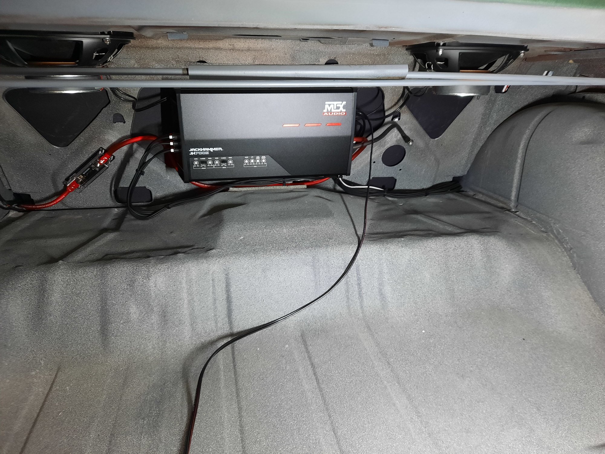

I installed 6 Focal speakers, a 12" JL Audio sub and a 500 watt 5 channel amp with a Classic Car Stereo head unit and love the sound and ease of use. No crazy menus to deal with. Once the setup is done....plays like an old school unit with the channel memory buttons and etc.

Is that that the fuse for the amp? Is the battery located under the hood or in the trunk? If it's up front I would move the fuse as close to the battery as possible.

Thanks. Yeah....battery is up front and I know to always fuse at the source but my feeder cable from the front was a little short so I added a second fuse in the truck for a neat splice of two red feeder cables. So....I have two fuses....one at the source and one in the trunk. It works for now and I used the supplies I had on hand.
