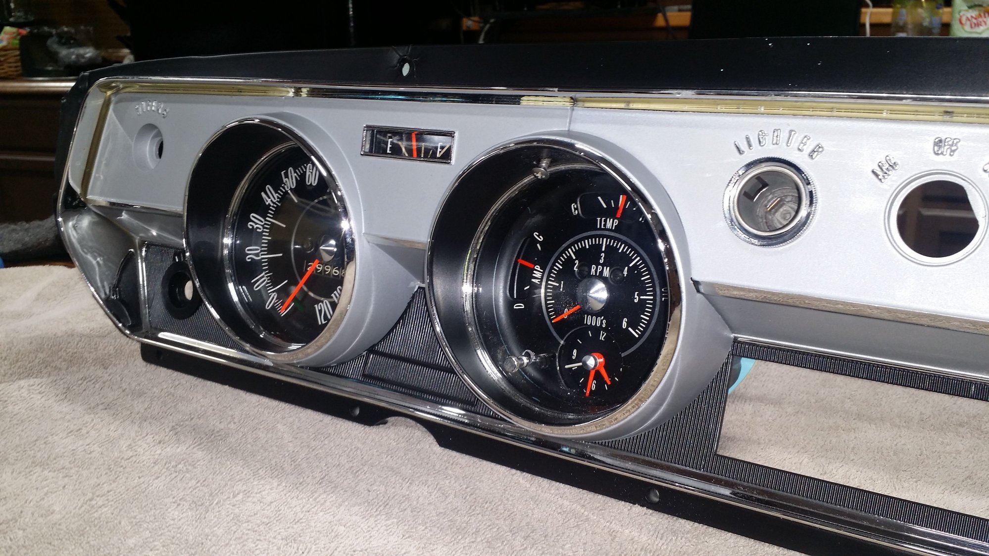

Here is mine after it was painted with the rattle can chrome and matte silver and matte black. It is presentable but by no means the same as having it restored correctly.
I am looking forward to installing the one Ron is doing now for me

What is the thing just to the left of the gauges?
Old Oct 2, 2016 | 03:55 PM
lemoldsnut's Avatar
Posts: 3,345
From: Redmond, Oregon
Double power ports so we can charge phones, GPS and such
Old Oct 2, 2016 | 04:07 PM
rroth01's Avatar
Joined: Mar 2008
Posts: 721
From: Orion Township Michigan 30 Miles North of the Murder City
Wiper Switch Port ..Light Switch Port ..
