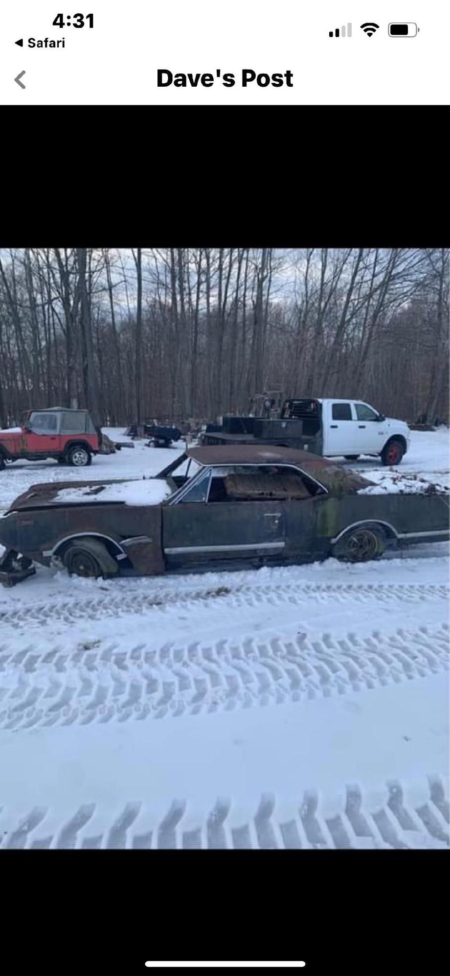

Was looking through some picture folders and found this I forgot having.

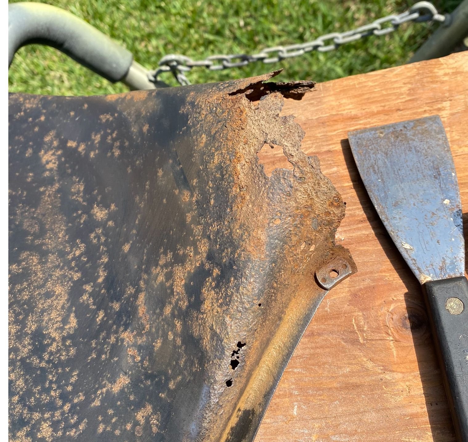

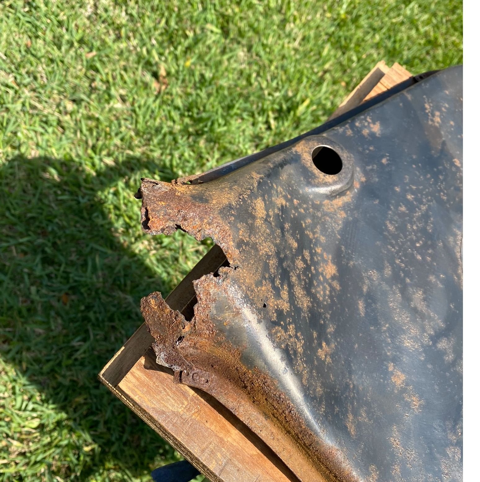

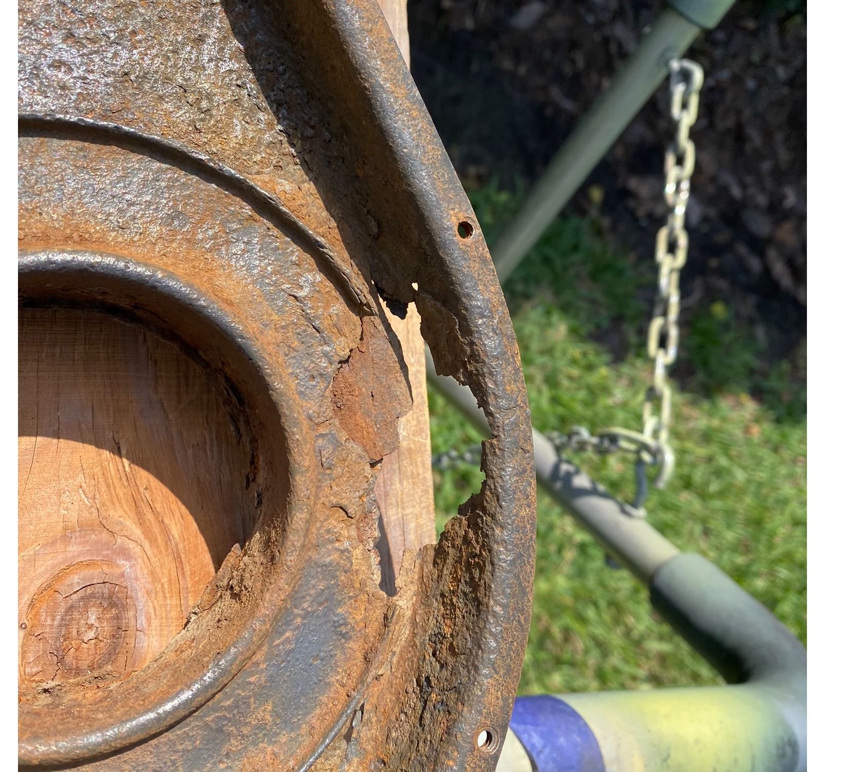

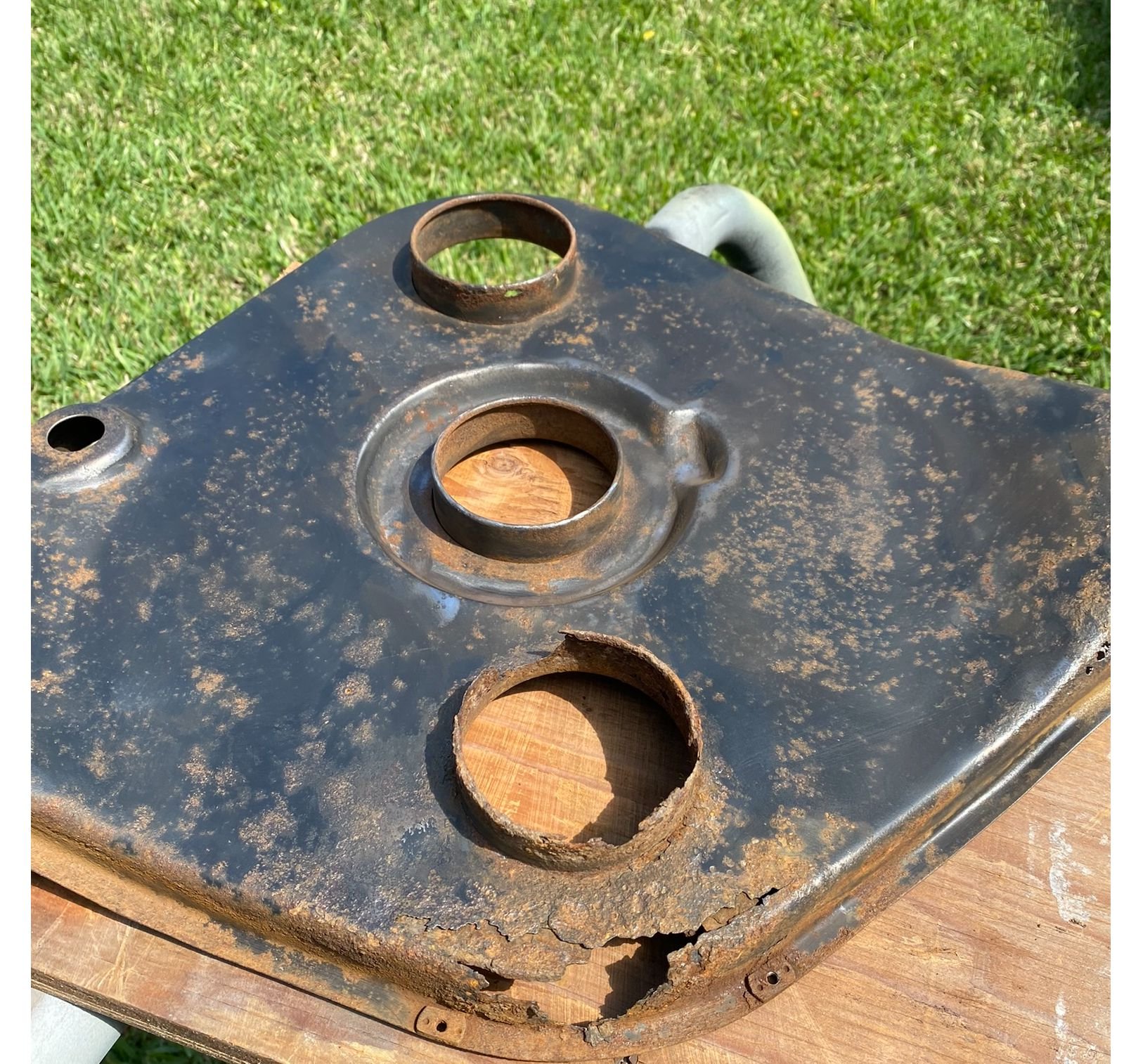

Before restoration pics of 66 shroud

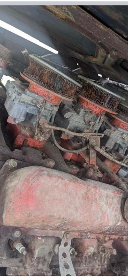

Those carbs look like something I built.

‘that’s hilarious..lol

yea the shroud was pretty rough..looks great now

WOW! You had a lot to fix there.

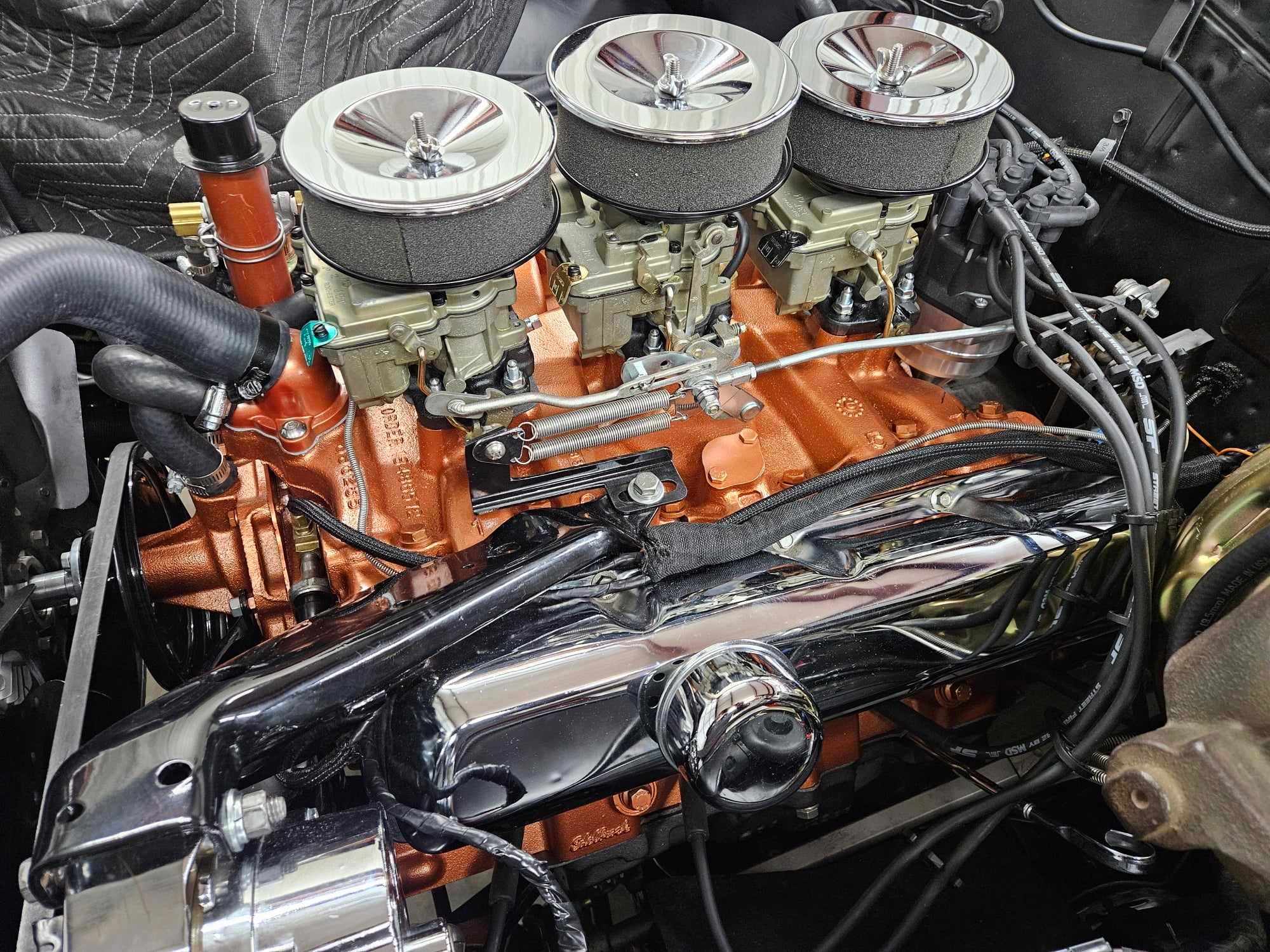

Here they are now after you shined them up

chrome shop had to cut and patch holes and weak spots but the did a darn good job.

Very sharp, did you use fusicks bronze paint?

Yes, with ceramic satin clear high temp

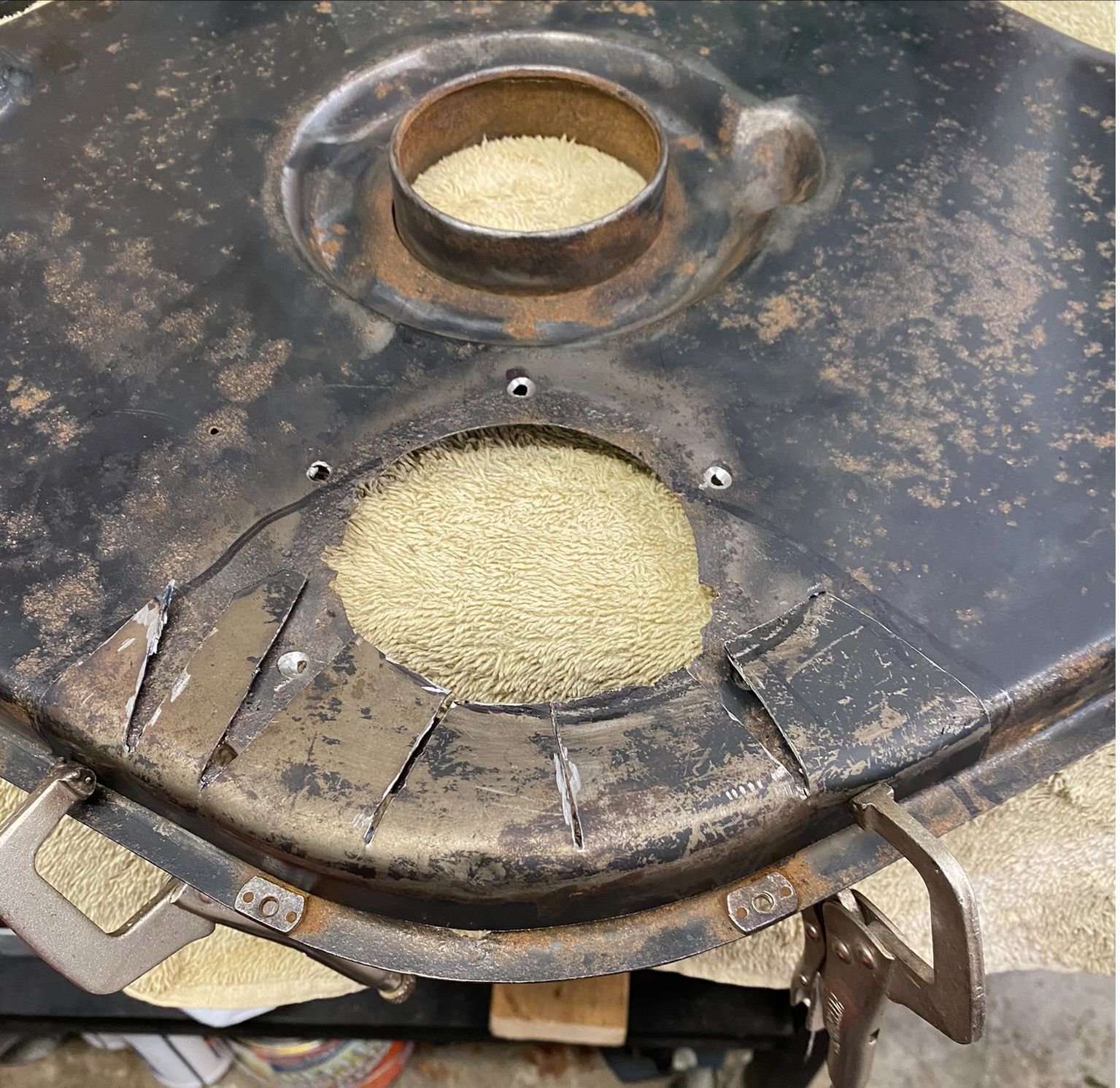

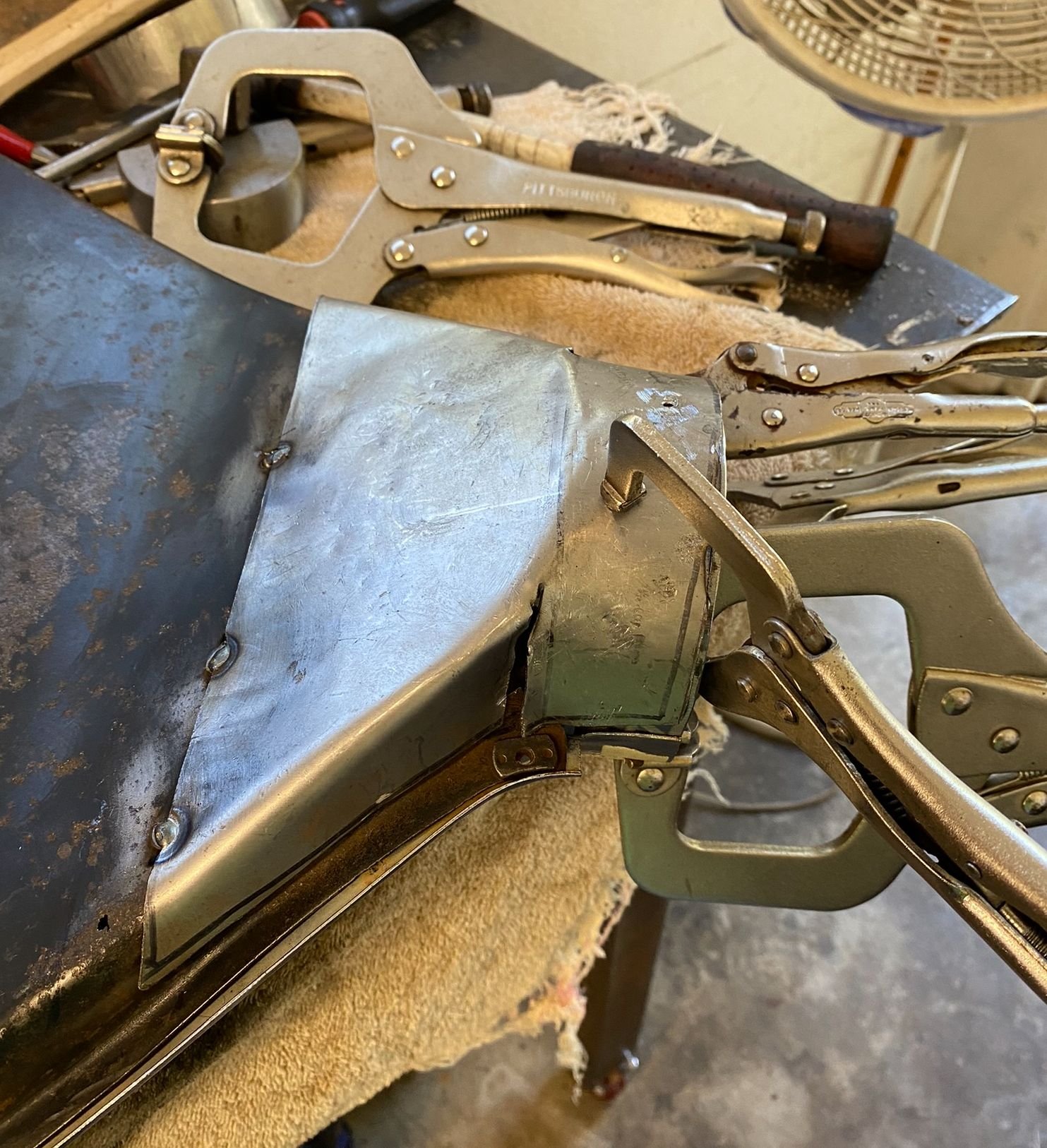

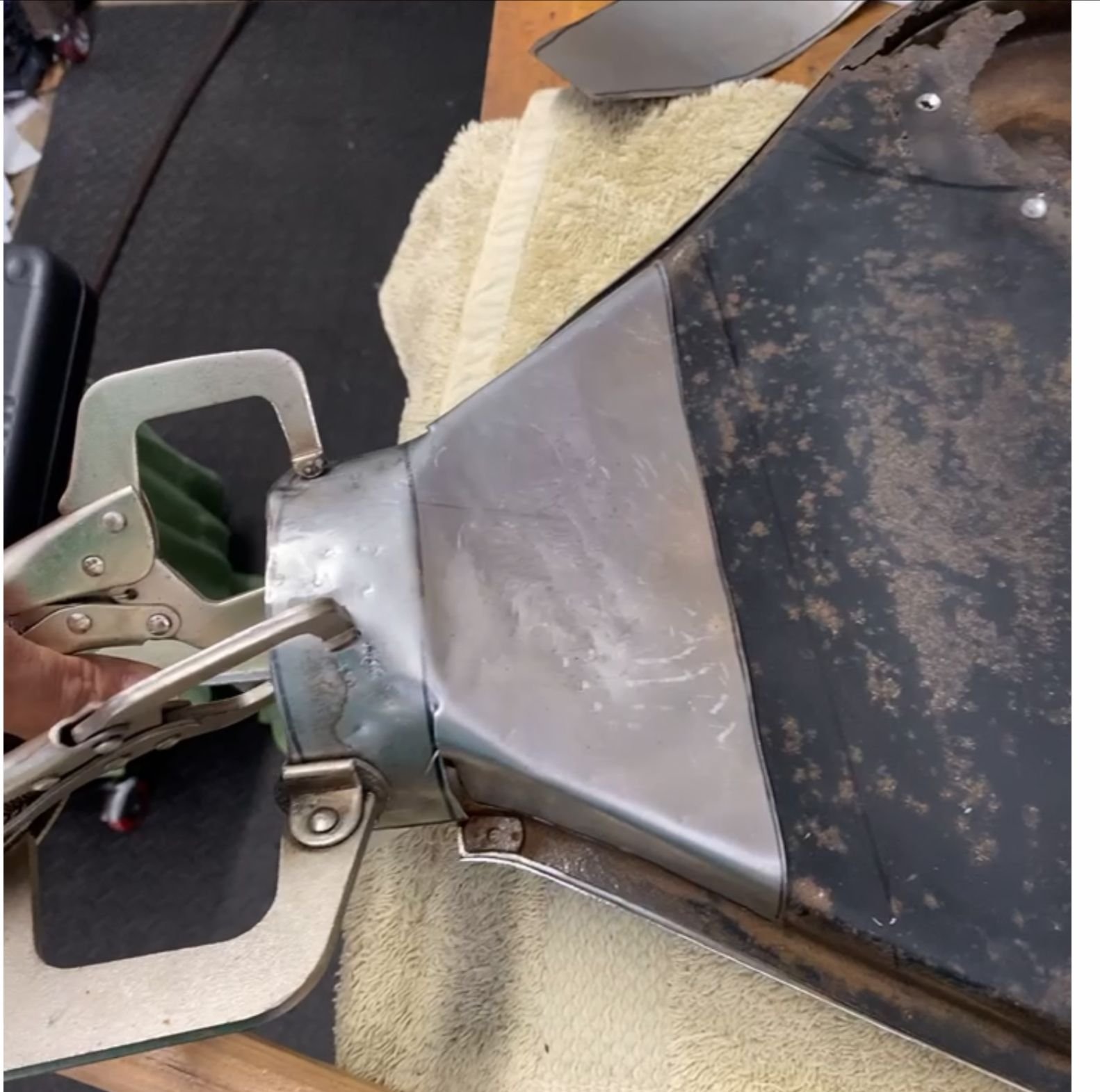

‘Yea I had to get pretty creative, I fabricated both ends out of sheet metal, the center of the shroud where the end carb rests I was stumped on that for a bit. Mike Richards and I were talking about it and we both decided maybe if I could find a old air cleaner from the 60s for mini brand that maybe had that same curve and bend to it that I could cut it out and welded into the center carb resting area. so I was looking around and I ran across a VW bug air cleaner, and the curve in the bend was almost identical, so I bought that, I cut it out and grafted it on and of course I had to replace the whole centerpiece where the carb rests into and all that and luckily, I had extra one from an old Pontiactripower years back. it was quite an undertaking but I enjoy doing that kind of stuff. So instead of spending 8000 for a shroud, I spent a hell of a lot less just took me a week and a half half of work to do it maybe two weeks.

‘Looks super sharp..

That's a great way to lessen the gloss of the Fusick paint. The engines were not gloss from the factory.

A few pics as I worked my way through how I was going to do the repairs…a lot of hand manipulation of sheet metal.

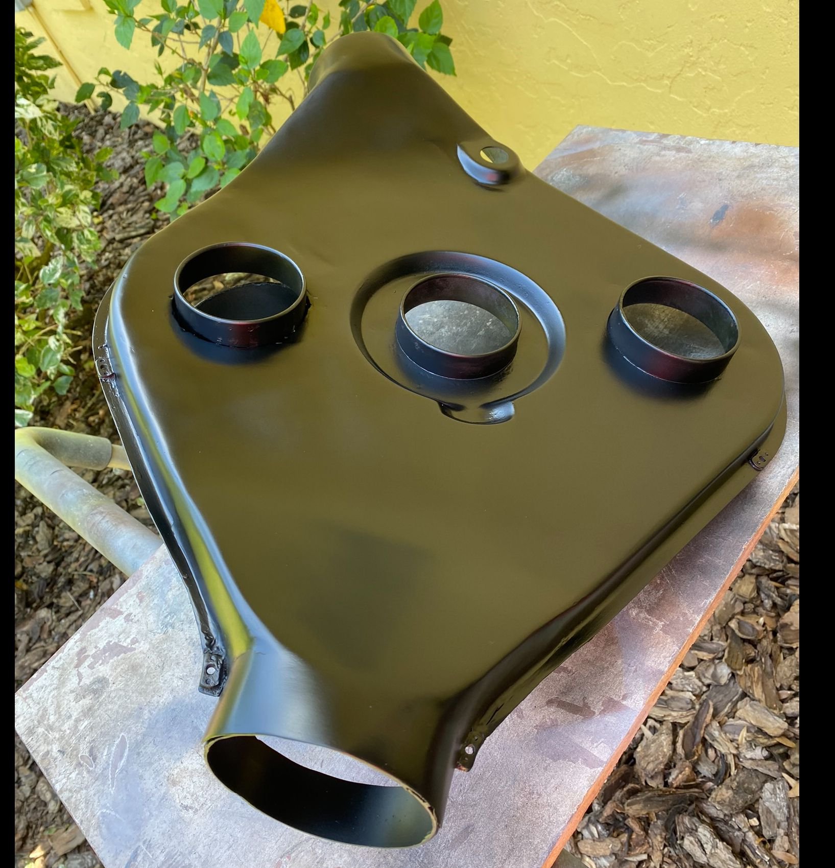

after some bodywork and paint

It's great that you saved this piece from doom and I saved the carbs and intake also. It's a shame someone didn't save the car

Wow, not sure I ever saw the car. Love to know the history of it
