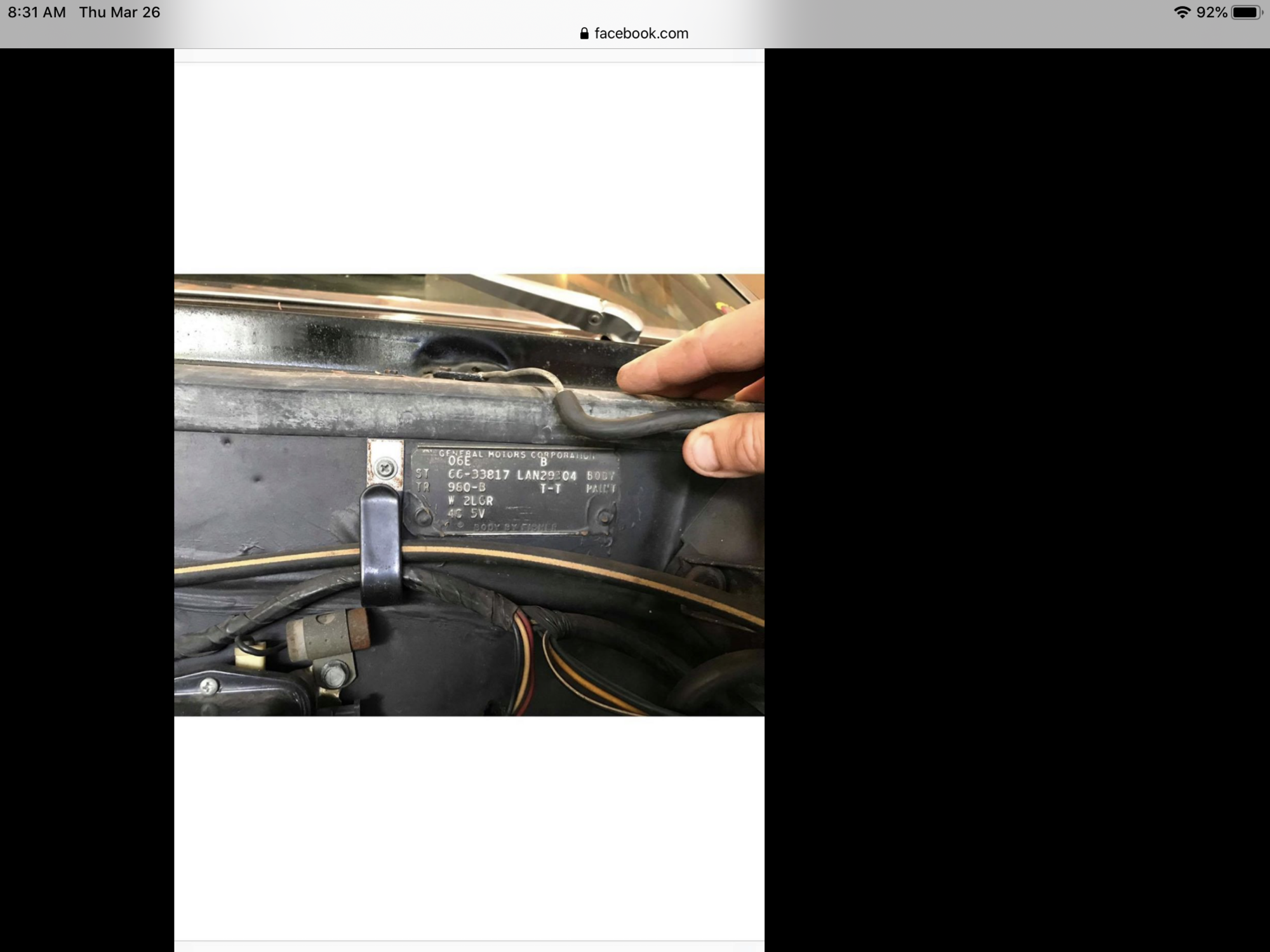

Trying to see if i did this correctly.. lansing built, june build , f85 deluxe ,5v=442, t-t color is sierra mist, interior black bucket seats, console floor-shift, tinted windshield, Is that basically correct? Thanks, Andy

Trim tag decode looks correct, it is actually in the front of the assembly manual.

Its actually a 442 option, cowl tag shows the 5v.. its a car i am looking to potentially purchase.. the trim tag pic i posted is the car. Its black instead of sierra mist.

06E = 5th week June build date
33817= Holiday coupe (hardtop)
980-B=black bucket seats
T-T = Siera Mist top and bottom
Group 1
W=soft ray tinted windshield "only"
Group 2
L=Cut out for 4 speed
G=Console
R= Rear seat speaker
Group 3
nothing
Group 4
C=Chrome side window sill moldings
Group 5
V=442
Hope this helps

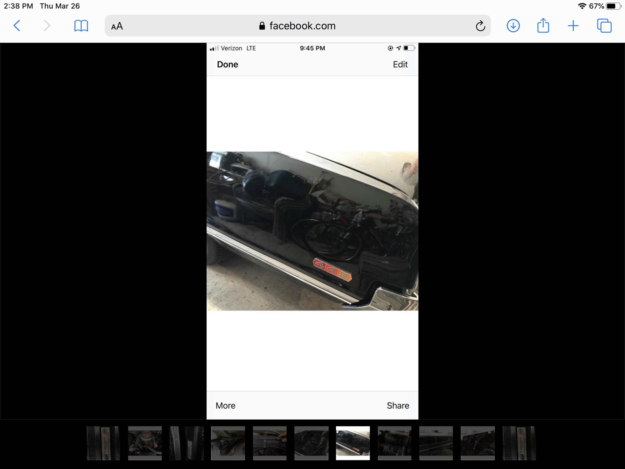

Thank you, looks like I missed a couple things.. first time deciphering trim codes etc, can get confusing.. I will be looking at this car, owner has had it 30 years, says it was sold to him as all original engine etc but he has never verified it. Am I basically looking for B heads etc? V in the cast numbers by the filler tube? Appreciate any help..the photo I posted looks like an aftermarket air cleaner for sure

air cleaner top looks original but base is not. Looks like it has a holley carb on it. this not stock, air cleaner hold down should be chrome and can be bought aftermarket reproduction. valve covers are aftermarket, Should have V code on the right head, B heads, 390390 intake, E code 400 motor, no vin on these to "numbers match" but if the original protector plate is in the warranty book, the V code on the head would be in it. IF all original and only proves one head is original. Nice car, Hope it works out.
