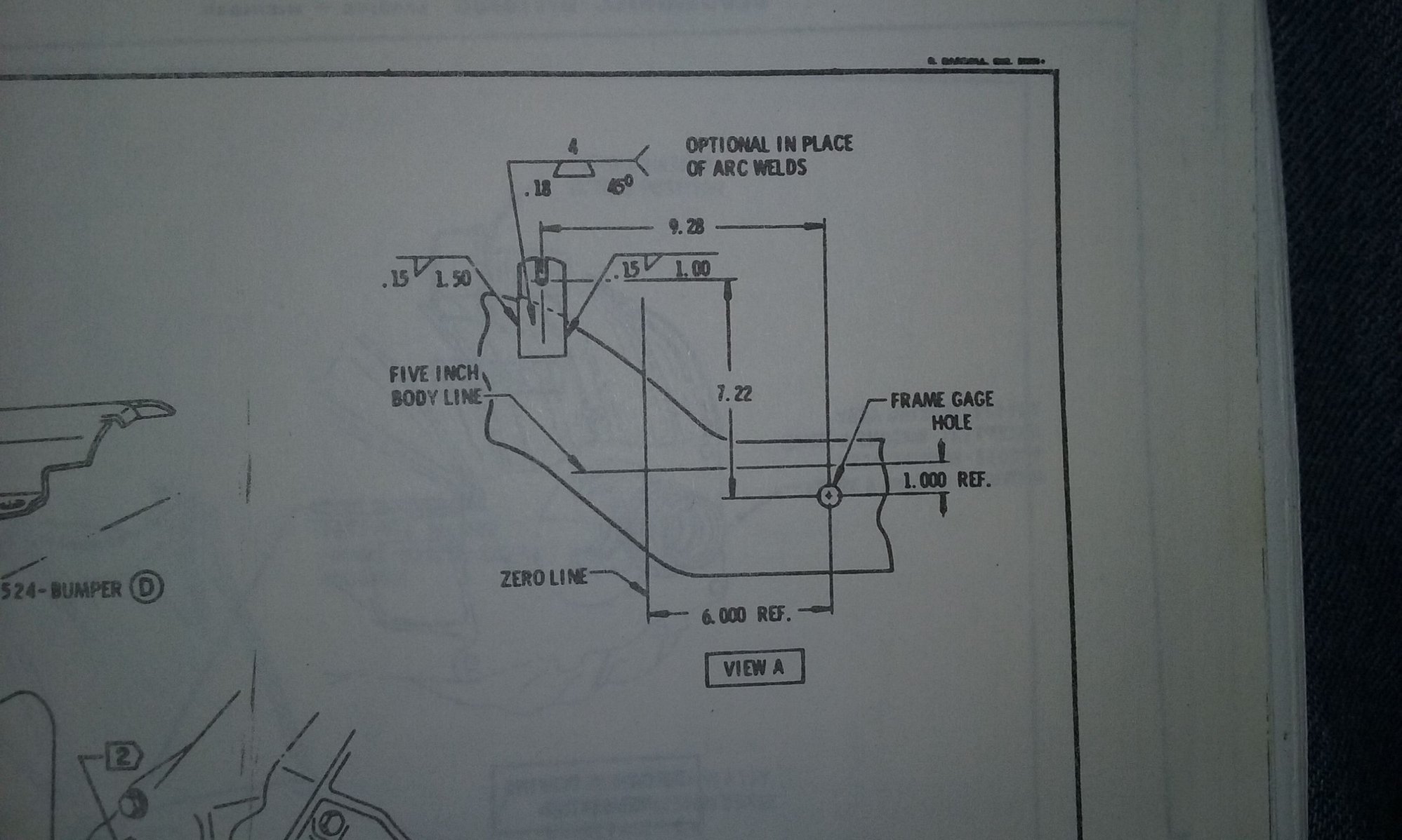

Does anybody have dimensions for welding on The clutch Z bar bracket for a 65 cutlass 4442? Thanks in advance Brandon
Old Mar 28, 2020 | 04:26 AM
From the PIM:

Awesome thank you Joe

When I welded a bracket, I had a stick and an auto 66 frame side by side and still was not completely happy with my attempts to place the bracket perfectly. I installed a block/bell housing/trans and lined up the Z bar to get the bracket lined up.

Could mount tab to scrap of metal to allow some adjustment and just elongate mounting holes.
