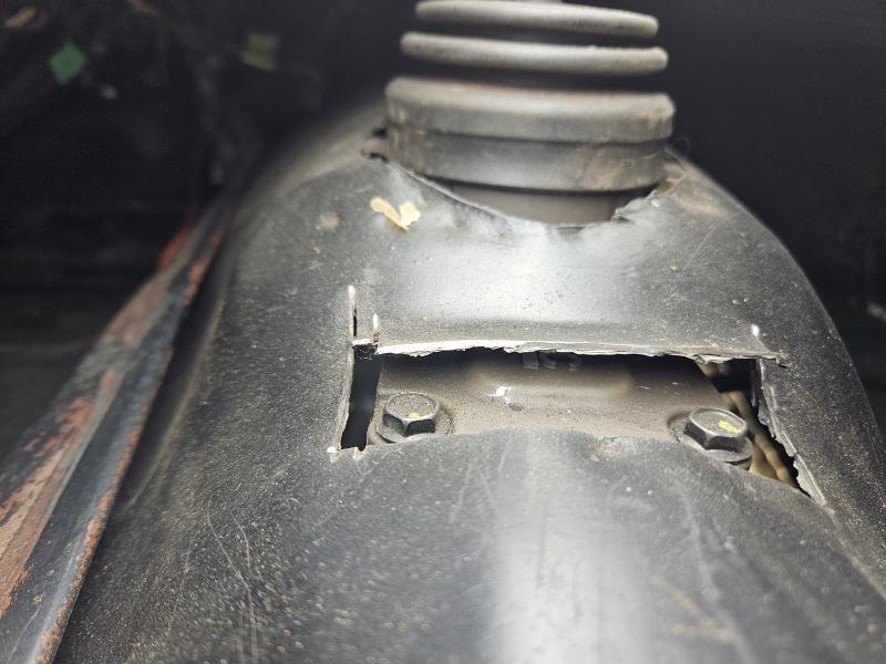

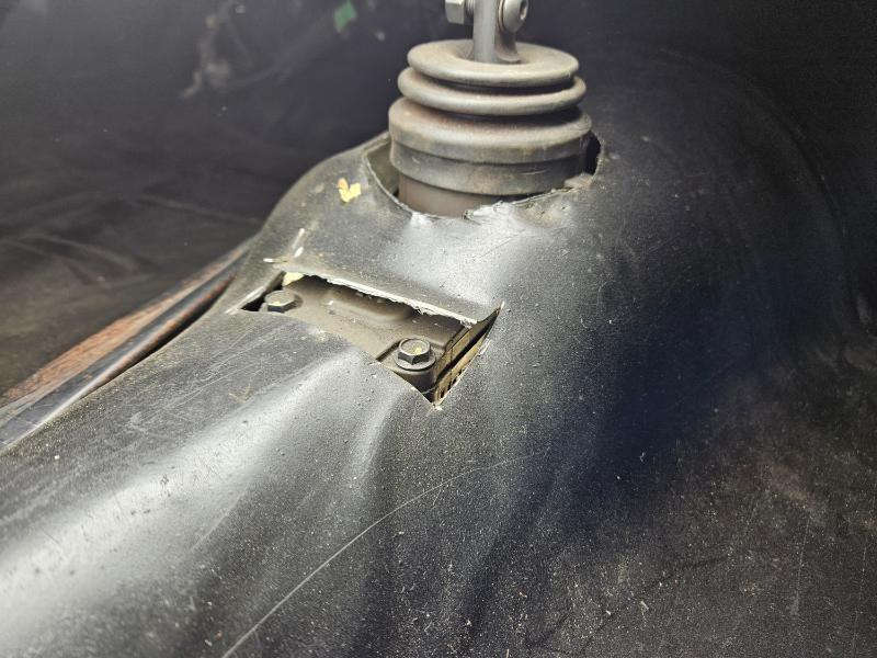

The TKX was designed with a slimmer profile to be an easy fit into most applications including the GM A Bodies. Some members here have been able to install the TKX with no issues whatsoever. In my case, I had to cut a small relief on the top of the tunnel just behind the shift level. Very minor and completely invisible once carpet is down, with or without a console. I talked to my vendor's tech support and apparently it isn't uncommon for there to be minor clearance issues.
I should mention that I have all new body mounts, and the body was lowered onto the frame after the engine and transmission were installed in the frame.
If using the TKX, you don't need the transmission hump that was factory installed for 4 speed cars, and if you're replacing carpet get carpet for an automatic transmission.
The final hole was a bit bigger but I can't find the photos right now. I made a slightly domed plate to fit over top the hole and used some weatherstrip and self tapping sheet metal screws to secure it.

Originally Posted by VI Cutty
The TKO, which is available in both 5 and 6 speed, requires tunnel mods.

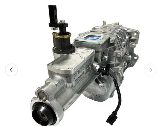

Thanks, that echos what I have read. I wonder if this version would have fit better?
What is "that" version? I'm afraid the photo isn't self explanatory.
The TKX is the one you want if you wish to avoid any major tunnel mods.
Counterboring the cover looks like an advantage to me over bolt heads.
Old Apr 15, 2025 | 06:09 AM
The bolt heads are the same height in both cases. The countbored cover is thicker. Note that the non-counterbored cover has steps where the bolts sit. The photo you posted has the offset shifter location to better fit cars that were originally Muncie-equipped. Any five speed trans will be longer/larger than a Muncie or T10 to accommodate the extra gear sets. You can play with trans mount height but that compromises driveshaft angle.
