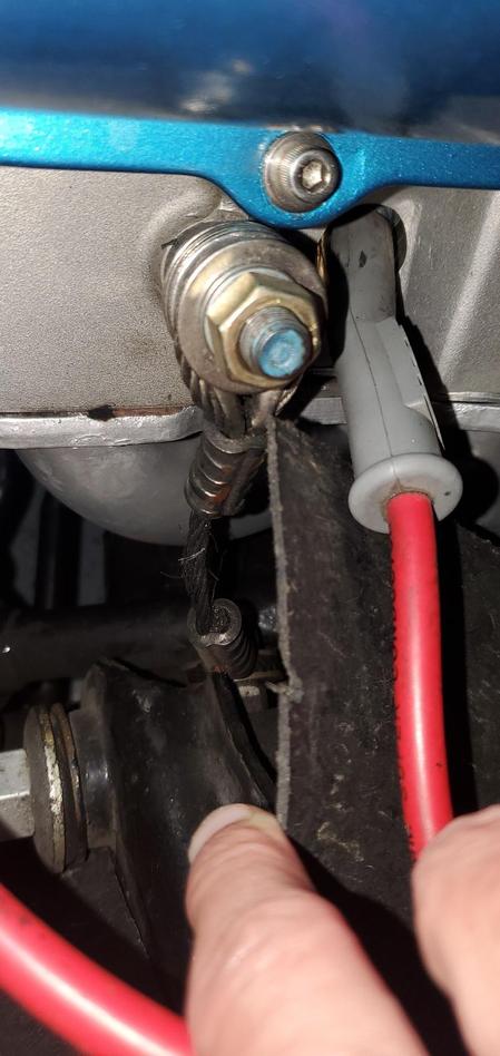

Well, after 20 years, the drivers side torque strap cable is starting to break some strands. Where can one purchase such a cable today?

I used to have a piece of chain on the front of the head to a steering box bolt.
That one looks to be on a head bolt? How do you maintain the torque? Not a fan....
I have head studs and I've never had any issues with the strap connection. Nut never loosens. Only issue after 20 years is some of the strands broke on the cable. Still holding but would like to replace it in the future

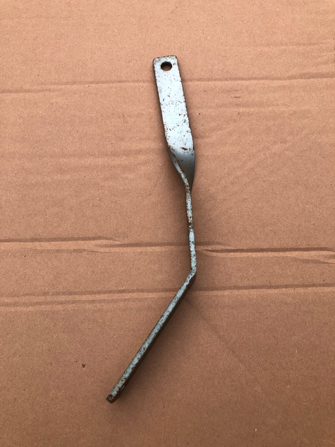

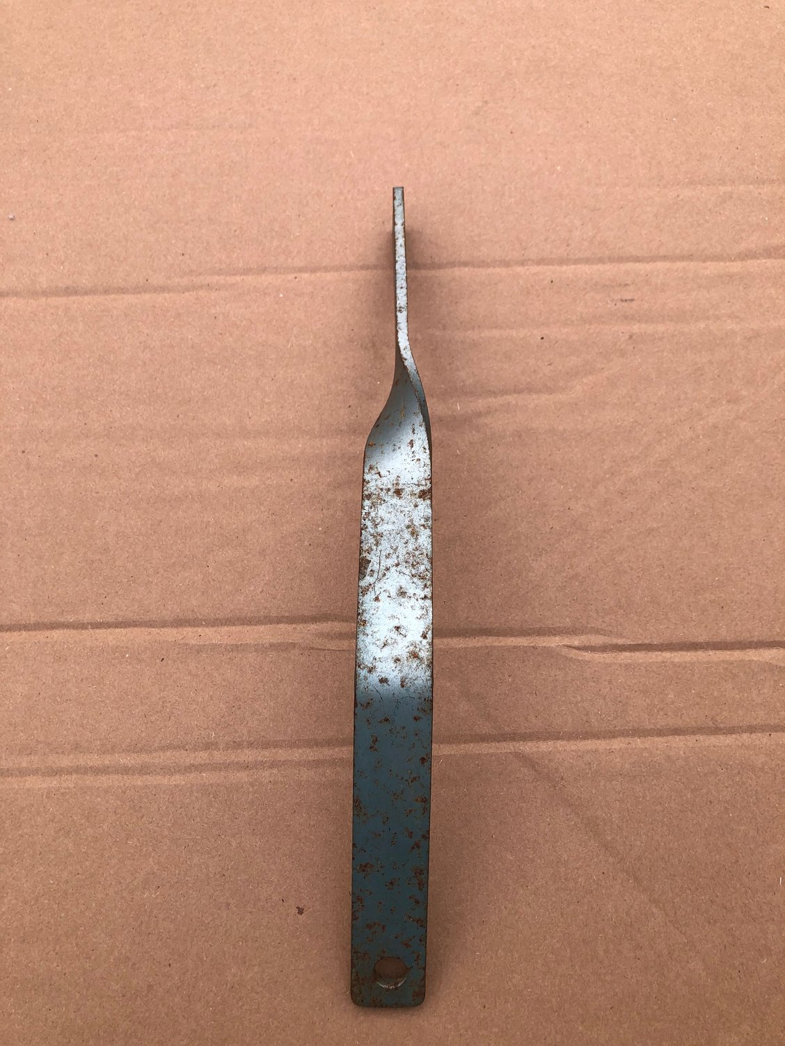

Old Sep 25, 2022 | 01:42 PM
ELY442's Avatar
Posts: 2,223
From: Brooklyn, NY
Originally Posted by ELY442
Mondello sells a flat bar with some kind of a bend. I bought one but never had it installed. I had a friend weld a chain onto a frame and bolt the other end by the headers.
I was cleaning my tools and found this in the back shelf that I bought from Mondello a long time ago. It’s a torque strap that connects one end to the upper control arm to the cylinder head bolt
