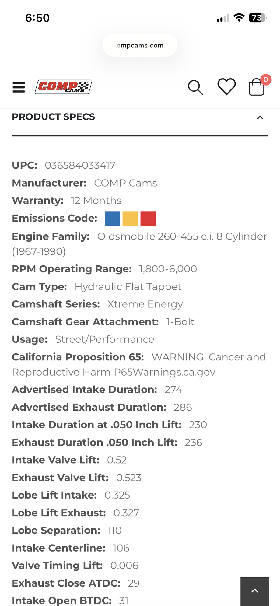

Hi All, Need some ideas on camshaft. I have a 65 442 that has a 455 in it. Block number 369021F, J heads, Edelbrock performer intake, Holley carb, Long tube headers, 3:73 rear gear, 4 speed, Power brakes. I'm looking to get a little more low to midrange. Don't want to aggressive to lose vacuum but I do want to hear the lope. There are so many manufacturers ( Isky, Comp, Lunati / Edelbrock, TA, and the list goes on ) along with many choices. Has anyone had success, and if so what would you recommend? Is a stock 1970 W30 cam the best option?

I have a comp cam 42-224-4. I’m pretty happy with it. Choppy

I think that's a bit too much cam for your purposes. What's your compression?

Comp cams xe274 will give you plenty of chop and is a very good cam Or the slightly milder 268h ,both very good street cams. The 268h series be better with your compression be my guess. I used the 268h in a 421 pontiac, it had that slight chop at idle, mild converter and 323 gears..great combo.

With that compression (if your estimate is at all accurate) I would keep duration at or below 225° and lift under .500.
Maybe do a compression test ... it won't tell you your ratio but cylinder PSI will provide a clue as to how much cam your engine can support.

If this is the case then compression would be 8.5:1.
So, yeah. Stay conservative.

Any reputable cam manufacturer (read: one you've heard of) with numbers in the ballpark should be fine. A lot of people here on CO don't like Comp Cams (too Chevy-centric?) but I've had an XE 262H (218°/224°@ 0.050, .462/.469, 110° LSA) in my G-block for years now and been satisfied. Its numbers might be about right for you too.
