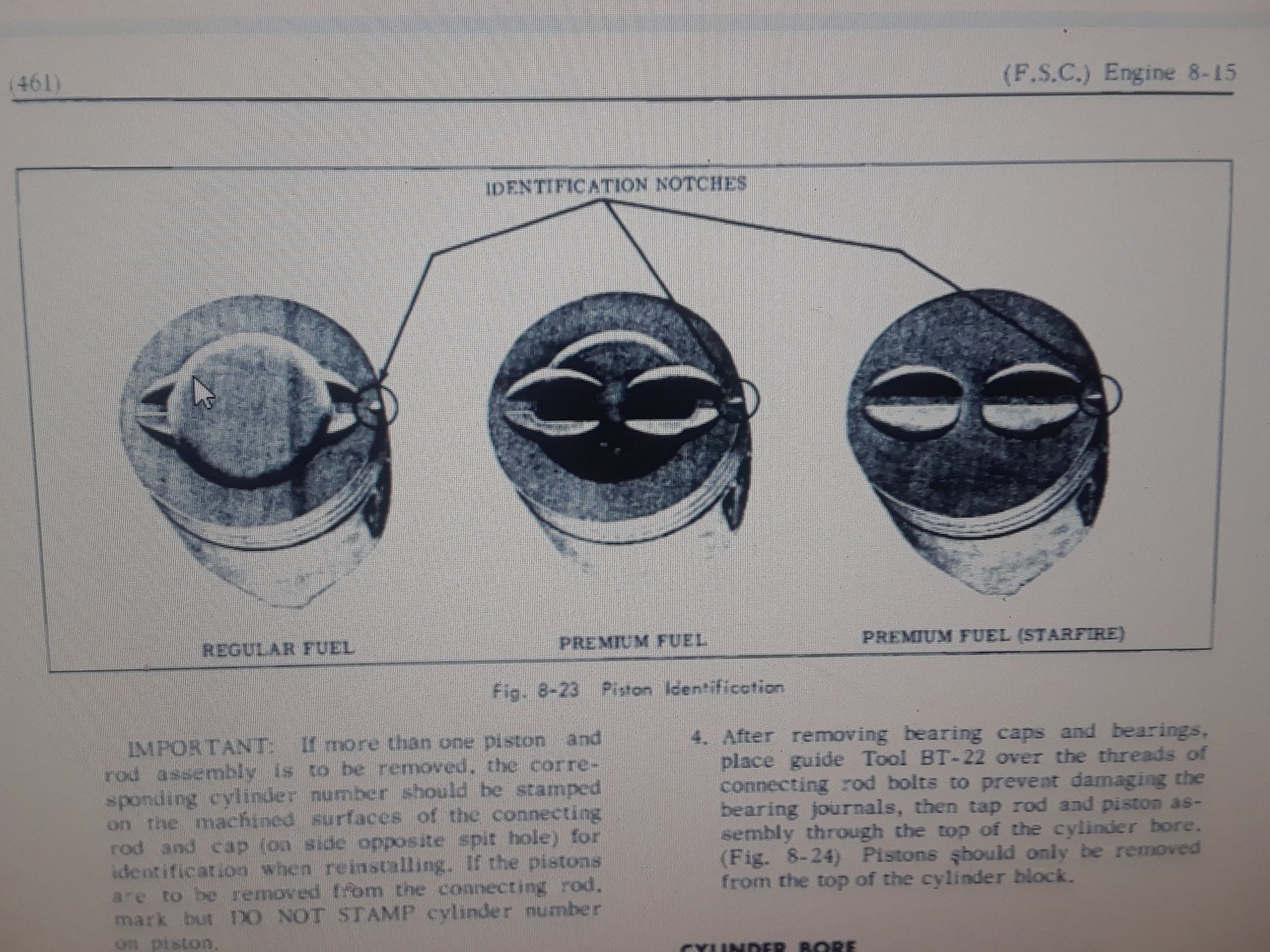

This 394 engine block casting number's ending in "4 1/8 with the number "20" on the heads which is a 1961 Starfire engine, low compression, so a 394 engine block casting number's ending in 4 1/8 with "23" heads is a 1962-1964 Starfire, high compression? Am I close

The 1961 Starfire had 10.25 to 1 compression and #20 heads .
All 62 thru 64's had #23 heads , whether they were high or low compression .
The piston dish depth , or lack of one , was what determined the compression ratio '
1962 and earlier engines had cast iron timing chain covers , 63 & 64 were aluminum .
