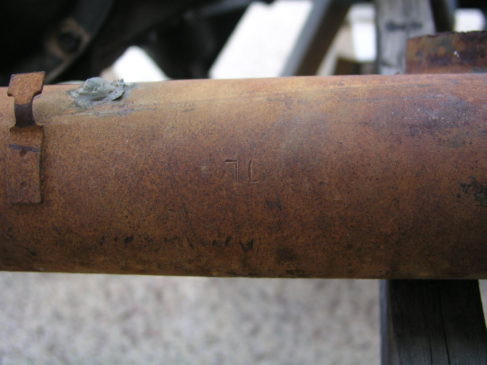

I think CFD is for Central Foundry Division. This is on just about every cast iron part.
As for the axle ID codes, they can be difficult to see due to being lightly stamped and rust, dirt, grease, etc on the tube.
Here's some shots of the codes on a couple of my O-Types:

Thanks for the pics Fun71. I'll have to go look again for codes.... Rrrrrr.
