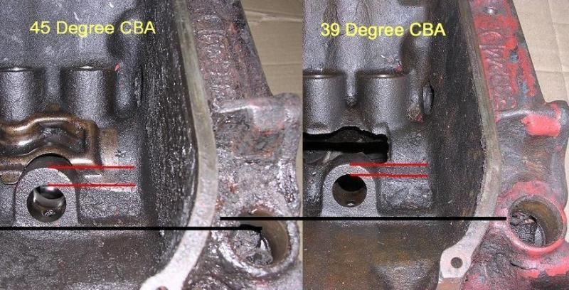

What are the differences between the two other than bank angles and .921 versus .842 lifters? Can you see the difference in the blocks from the outside? Same deck height?

The only meaningful difference is the lifter bore location.
One picture is worth a thousand words! Do these .921 lifter bore blocks have a special casting number?
One way to tell from outside the block is they have a drill spot right next to the oil tube:

^^ This, any 39 degree block will have the drill spot.
To clarify, that's any 1966-67 block. All 68-up Olds motors are 39 deg and don't have a drill spot.
only two big blocks came with .921” lifters. The 66/67 400 390925E and the 66/67 389244D in the Toronado which should have the identifying drill spot. both are 39CBA.
neither one of those in the pic are .921” lifter bores…just so you know
another thing is don’t trust the drill spot as proof a 66 or 67 425 389244D .842” block is a 39CBA…like has been said here. proof is the pic on the right, no drill spot. I’ve got a few myself. You’ll need to have the intake off and check
dont trust the casting thickness around the lifter bore either. I have some 389244D .842” 45 deg blocks that do not have a thicker cast area like that pic on the left.
all 39CBA blocks are 42LBA
all 45CBA blocks are 45LBA
