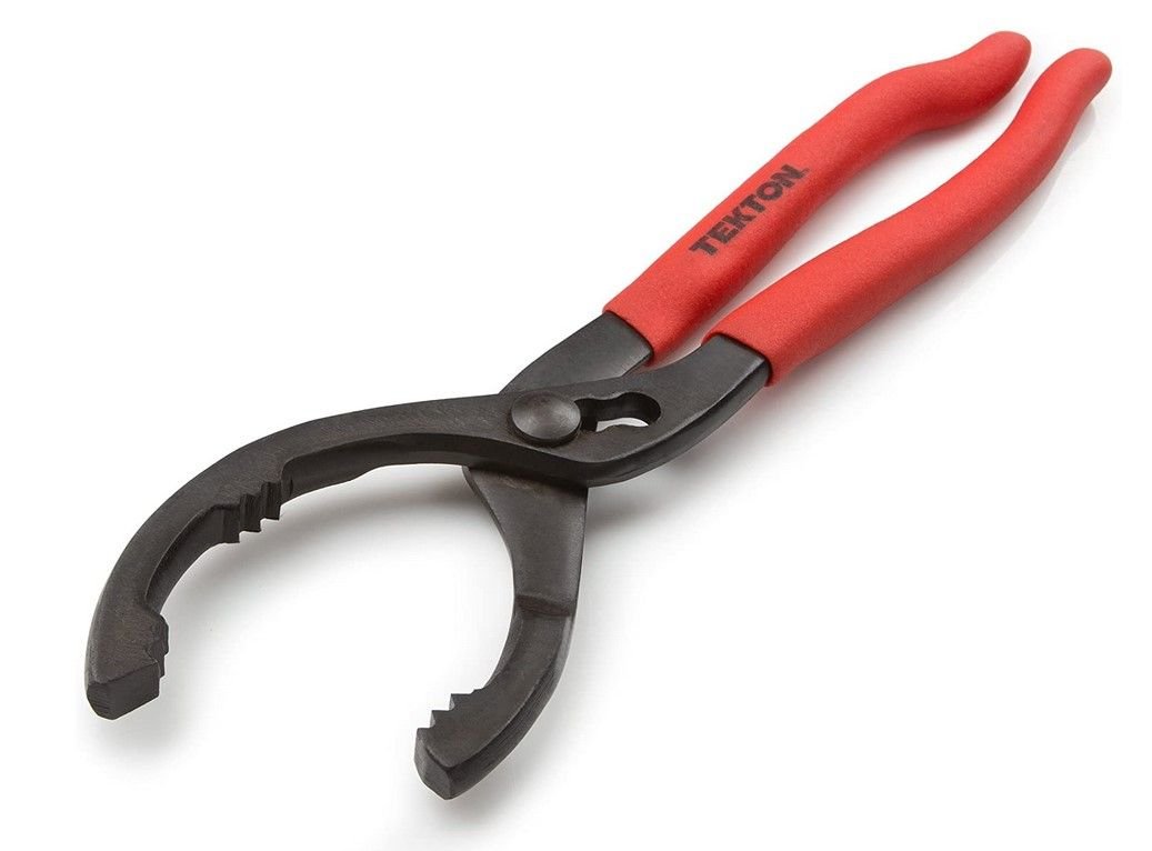

Posts: 26,049
This is the type oil filter wrench I own/use. It can be used for many situations. You could try to muscle out the distributor by turning it with this type oil wrench. You can wrap a couple wet cotton cloth shop towels around the distributor, then use the oil wrench to squeeze and rotate the distributor. Just another possible method of madness.
