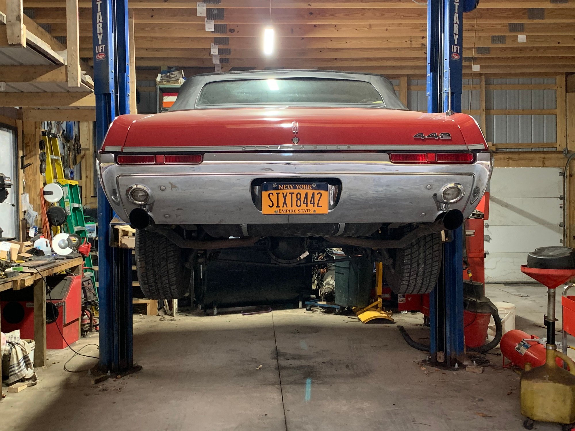

I have a 9000 lb Rotary SPOA9 two post that I purchased at a Ford dealership auction for $800. They had built a new building next door and sold everything that was used. The only advice I could offer is that if you buy used, purchase one that you can operate before the purchase. Check for leaks and inspect the safety cables as best you can.
The dealership had 7 lifts for sale. I approached the service manager a couple days before the auction and asked him if he'd give me a tour of the old garage space and if he could recommend which of the 7 he would buy. He was happy to do so. The lift I purchased was the last lift auctioned and it was the one the service manager recommended as being the best.

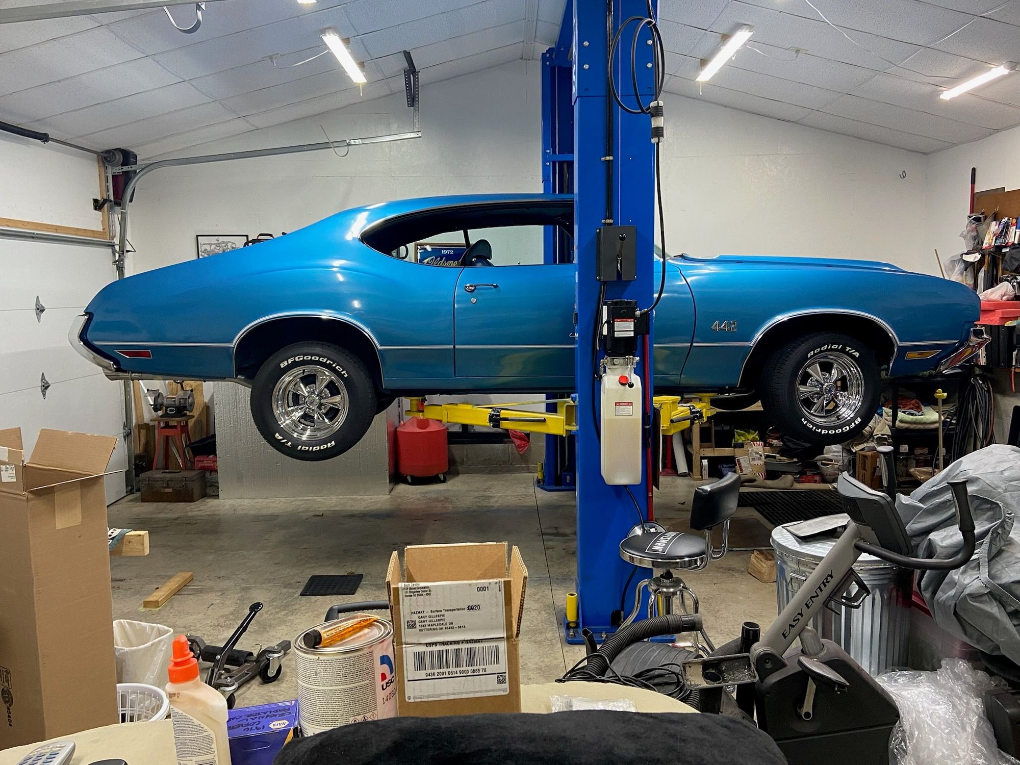

I bought an Atlas PV10PX 10,000 lb lift capacity in about 2017 and had it installed in my new 24 X 30 garage. It's way overrated for the cars I own. I looked at the actual weight of the lifts and used that to get the heaviest weight lift they offered. That told me the lift wasn't a lightweight construction. It was adjustable height wise and it had I used steeper trusses; I could have gotten 6 to 8 more inches height lifting of vehicles. It works for me though!

I'm pretty sure that's either the same one I have or slightly bigger. I have an SPOA9 (9000 lb asymmetric)

Originally Posted by OLE442
I bought an Atlas 10,000 lb lift in about 2017 and had it installed in my new 24 X 30 garage. It's way overrated for the cars I own. I looked at the actual weight of the lifts and used that to get the heaviest weight lift they offered. That told me the lift wasn't a lightweight construction. It was adjustable height wise and it had I used steeper trusses, I could have gotten 6 to 8 more inches height lifting of vehicles. It works for me though!
SO I noticed you got the omega tire lift arms on your lift arms, do you like them ? I am thinking of getting a set. I also see you put those way into the lift arms for clearance maybe ??
I do not really care for them. The idea is good but IMO, they don't really work out in real life. Not really enough room once you get all 4 tires on them especially truck tires. I never use them. JMHO!! YMMV!

I was just out in the garage and looking at the tire lift arms and was thinking I actually could make them work by moving the arms the opposite way and moving the clamps where they're located to a different spot! BUT THEN, I realized that any car that doesn't have hubcaps would not really work. If the wheels have center caps, you'd have to remove all the center caps to hang the wheels on these and then re-install all of the center-caps on all the wheels. And the kicker is that to put the wheel centers on, you'd need to take them off the holders to re-install the caps so they would need to be picked up again! LOL!
All but one of my 5 cars has wheel cover/hubcaps and only one with center caps is removeable from the front of the wheels (Corvette Rally wheels)!
