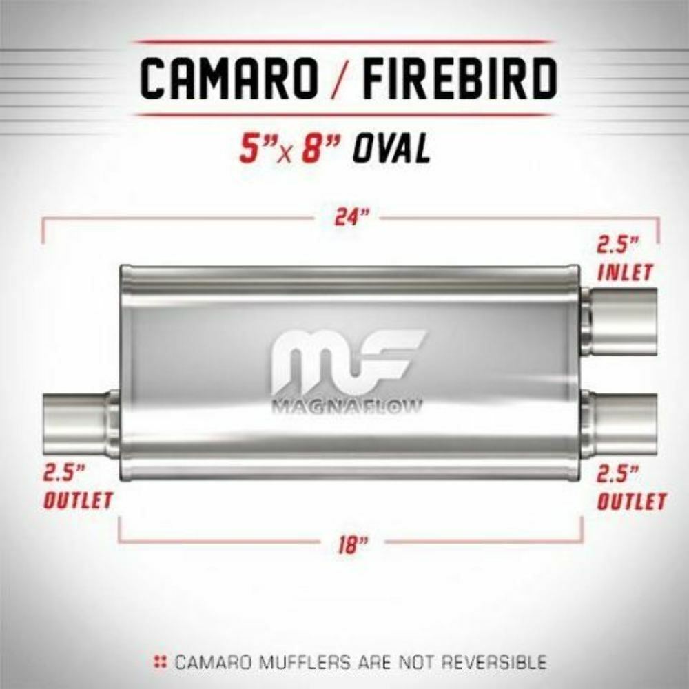

Old Jun 16, 2025 | 02:05 PM
Posts: 50,802
If you want a compatible performance muffler, the "Camaro" style transverse muffler is common in the aftermarket, since F-body cars used that setup. I have the Magnaflow version on my 62 F85 wagon, for example. There is also a Walker Dynomax version. They can be had in 2", 2.25", and 2.5" pipe sizes. I have Magnaflow 12265 on mine.
