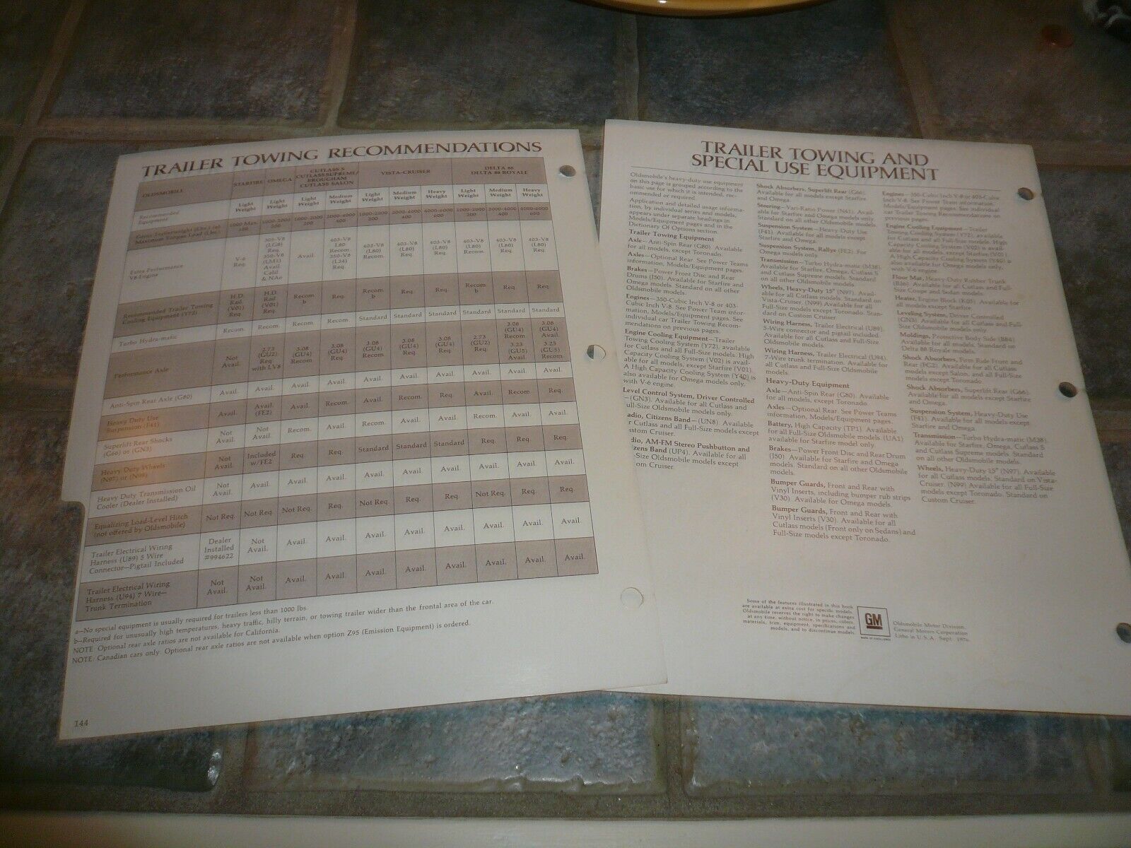

Oldsmobile did not sell factory trailer hitches, but they did publish a trailer towing guide every model year, which provided the trailer weight limits for each model and the required or recommended equipment for towing that weight trailer. A copy of the guide for the 1977 model year is on ebay right now.
You can pretty much make out the data for a 1977 Cutlass. Note that the max recommended trailer weight was 4,000 lbs. Additional equipment such as HD cooling, engine size, rear axle ratio, etc are also covered, depending on trailer weight. Also note that an equalizing hitch is recommended for trailers over 2,000 lbs.

If you scroll up and look at the 1977 Towing Brochure that I posted above, they absolutely DID publish towing capacities. Olds did this for every model year, at least back into the mid-1960s.
