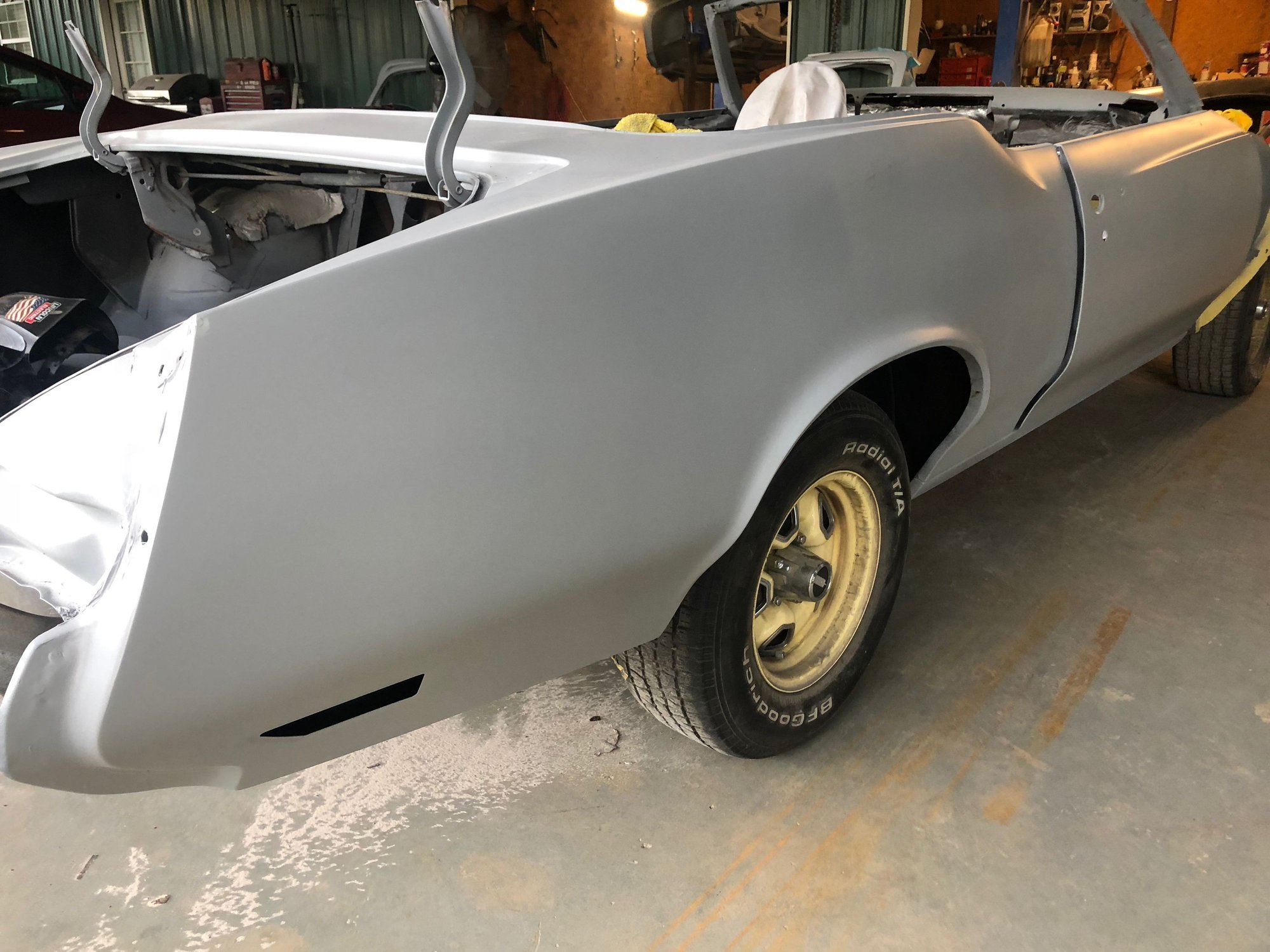

Alan, I’m back! The car needed some body work. After we sandblasted the car, the Canadian history came out! What are your thoughts on painting? I searched all the painted threads. It’s been sandblasted and fixed up, no rust. How many coats do people put on? Clear Coat? I know that Clear-coat was not a thing in 1972. It will not be a show car. Basically looking to drive it on weekends, etc.

Welcome Dave, if you haven’t already you might to join the North Texas Olds Club, they’re a very active group and several members have restored 70-‘72 Abody Oldsmobiles.. Lookup 70post, costpenn, and a few others..these guys know these cars, are will be glad to answer your questions..
BC/CC is pretty much the standard nowadays so you don't have any choice. It's more expensive than the old single stage enamels and lacquers that were used back then but the good thing is the clear acts as a better barrier to minor scratching. It's easily buffed to look great again.
I like that you're going with original color. As the body shop for their professional opinion about how many coats. Most shops will apply 2-3 coats. I'd only go with more if the car is going to be wet sanded and polished to show car quality (more $$$$$$$$$) but I remember you're not really looking to go that route. Also remember that the more CC that goes on the car, the harder it will be to reinstall some of the bright work on the deck lid or cowl ridge at the back of the hood. Speaking of the hood, have the body shop tweak the way it sits so the rear isn't sitting up so high. They can also adjust the hood bumpers at the front to bring it up a bit. If they don't know how to adjust the hood height, I would be worried about the rest of their work.
Stripes? My opinion is that the W30 stripe package looks really awesome on that car, even though it's technically wrong. The W29 stripe package is much more subdued. Both of them are in the 72 Cutlass Assembly manual. The stripes also go on the deck lid and quarter extensions at the back.

Dave,
Is this an original 56 code Sunfire Yellow car? Don't know why I'm drawn to the Saffron/Sunfire yellow....even on a Velle or a Vette.
This one loaded down nicely. Makes one wonder why the W29 & M20 option boxes didn't get checked?
Really dig the Cragar SS wheels. I do like the PO2s from 72 but the SS3 and Cragars win.
Try the hood without the stripes. You can always add them. Buy the vinyl decals and lay them on the hood for contrast to see if you like it. White and Black. Mock it up with the decals before the clear goes on. Then you can paint them on. Or Stick em on after the clear. I've seen a few 70-72s without the wide hood panel stripes. It kind of stealths the W25 hood. I think it looks great like that on a non W30 car, light or dark colors.
Consider the thin pinstripes around the outside edges of the hood scoops. Also, consider the 442 thin stripe option on the body.
White stripes look good on a yellow car with a white gut and top... but black doesn't suk either. The top kind of dictates the body stripe color IMO I had a saffron 68 442 vert with a pearl gut, black top, and thin black body stripes just under the stainless moldings. It looked cool. Google Images for a look.
As far as paint you are worrying us if you are asking that kind of question...unless you're a first-timer applying the paint? A seasoned painter would know what's needed. There are many things to consider from the correct primer, correct and time-consuming prep, then the paint. Compatible chemicals are most important as well. If the prep sucks so will the paint. Block sand your *** off. When you think it's done block it again. Then at last...the Paint. I have seen 2-3 coats to 10+ coats of base. Most of it gets blocked off. 2, 3, 4 coats of clear. It all depends on the process and how long your willing to wait for each coat to off-gas(cure) how many wet sand setps your willing to take and how "wet" you want the car to look. Are you shooting for a factory look or a super show look?
Fusick, Year One, OPGI are the three places I rely on for restoration parts. This sites classified section for used restorable parts.
PICTURES! we are picture junkies! Hopefully, you've taken pictures of the body & paint process. Always cool to see before & after shots.

Posted some pictures. The last one is where it is at now. Some of them aren't in order. Thank you! Great Advice.
It is an original 56 code Sunfire. We wondered the same thing about the W29 and M20 boxes.
I will not be painting myself! Don't be worried I am a first timer but know what I don't know and I know I wont be painting! Just trying to learn from you guys and make sure I don't get hosed up on what they are doing on the paint.

Wow! That's a serious teardown. Didn't realize the rust was so bad; still have a long way to go by the looks of things. Good work, and keep it up! Be careful with that jack and block of wood lift, it looks pretty sketchy. Don't get hurt

Updated pictures
Here is the update. Off to paint now.

Looks good - Where is the front clip? As you probably know now from fitting the quarter panels, the door gaps on these cars isn't the same as new car standards. Looking forward to the after pictures. Are you planning to keep the SSIII wheels? IMO they look great on these cars especially when they've been cleaned and painted.

Yeah, I was wondering about the wheels. Now would be a good time to paint them.
