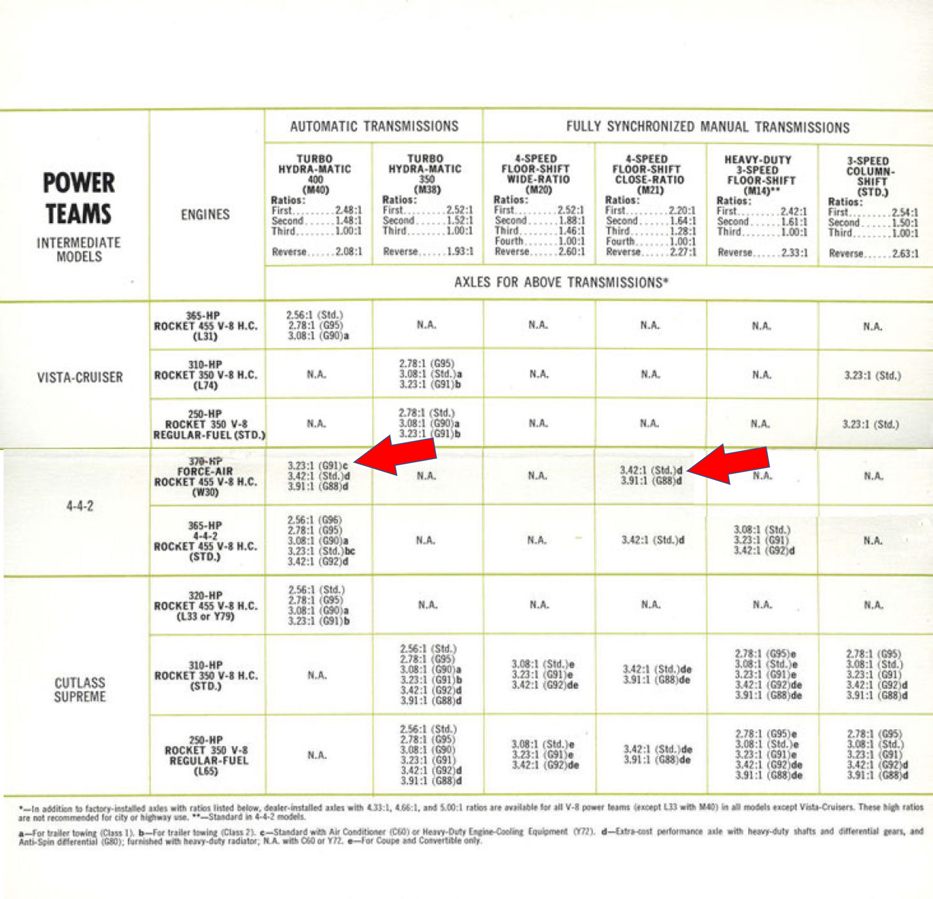

Hey guys, can someone tell me on a 70 w30 4 spd. w/o a/c with an O rear. was the 3:42 and 3:91 ratio available with 4spd. ?

That’s all that was available in the 4 speed cars.. no air offered in 70 w30 4 speed cars either. So yes
