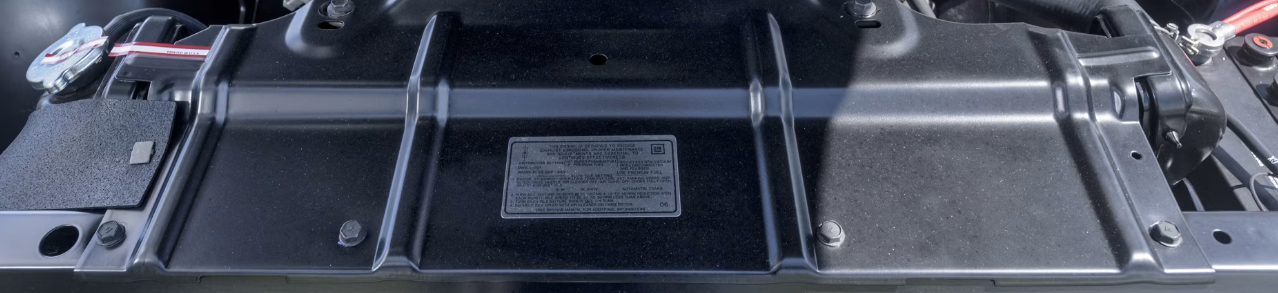

Speaking of missing things, I'd want the radiator seal on the driver side, too.

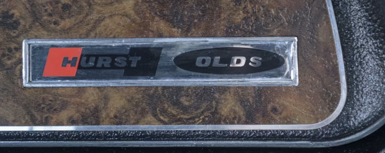

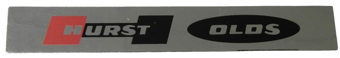

One thing I did notice is that MOST restorations use repro glovebox decals. Which is ok. Gotta do what you gotta do. Only main drawback with those is that they don't require the thin, clear plastic "window" that affixes on top of the decal. When I got my car, the edges of the original decal under the window were delaminating and looking like crap, similar to this car's. The decal is actually sandwiched in-between the glove box and little window with adhesive on both sides, but any 69 owner with a good eye knows the little landing pad for the decal has a slight groove around the edge as an aluminum plate would normally go there. The decal typically doesn't age well along that grooved edges. I painstakingly was able to carefully remove mine from the glovebox, and send it to a decal company to replicate it. Even after 3 attempts of their art department trying, it's not perfect, but it's better than all the others I've seen. I still had a few tweaks I wanted them to fix but they were ready to tell me to F.O. so I took what I could get. I couldn't get the double adhesive though, but it was on chrome mylar. I still have my little window so I'm trying to figure out the best way to apply adhesive to it to look as close to orginal as possible. Lost the decal pretty much once I removed it. Maybe I can get some made to size with crystal clear adhesive on the back side...
You can almost always tell the repros if you look close enough. The shape of the "S" normally gives them away.
Repro (Don Hartman):
Repro (OPG):
Repro (Fusick):
Repro (The Parts Place):
And my own repros from my orginal:
This car's original:

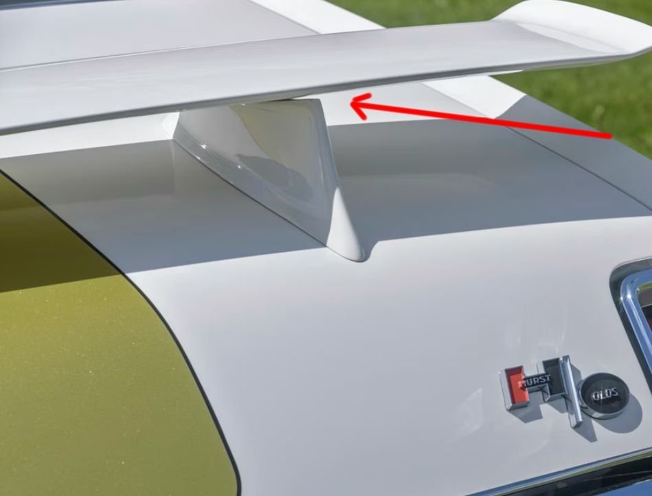

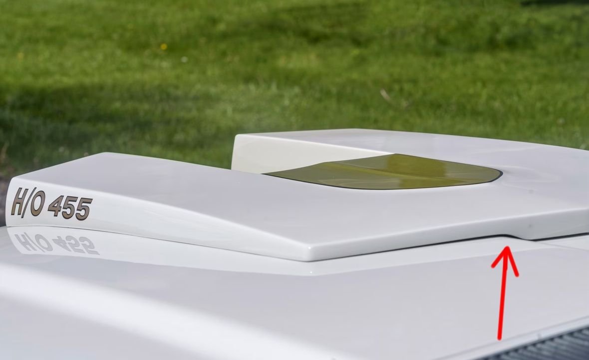

Nice car, clean.... bold price.
All what someone is willing to pay, or bid it up to.
Fair enough, I'm nit pickin' but a few items I would want not to have given the "Concourse Frame Off Resto" and the price....
