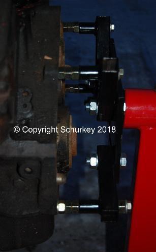

I suppose you've figured this out by now...but...you should buy MUCH longer bolts, and then add some nuts or tubular spacers, so the flywheel end of the block has plenty of room for tool clearance.
I buy 5"--6" long bolts. Three half-inch nuts on each bolt between the block and the stupid-short standoffs on the engine-stand arms works out nice.
http://hbassociates.us/Cheap_Engine_Stand_02.jpg

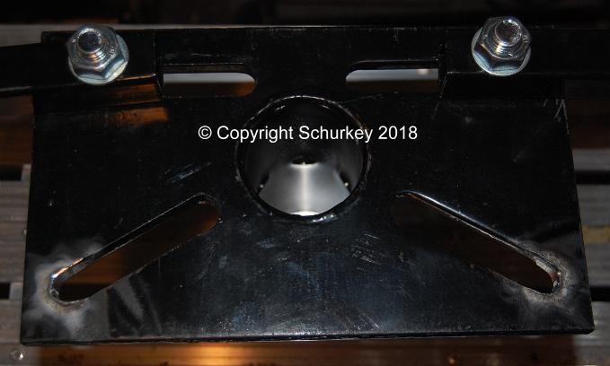

The next thing you'll have to deal with is lengthening the slots for those arms, so you can lower the block in the stand. With the heads on, the engine is too top-heavy otherwise. The rectangular steel plate is just plain too small, but you can get a little more slot length.
http://hbassociates.us/Cheap_Engine_Stand_03.jpg
