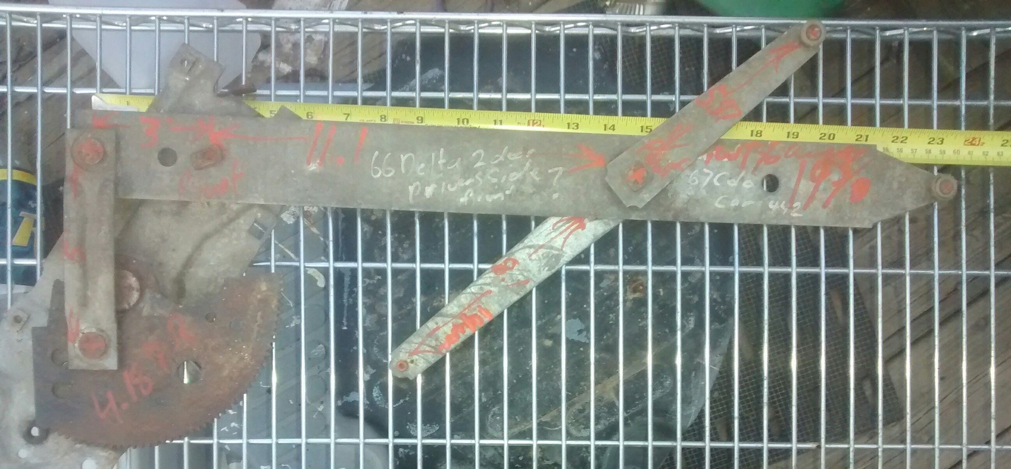

Lh & Rh are mirtor images
If you need measurements / comparisons
when Parts hunting there is no such thing as too much information if you need to know where your parts may be located I can send you a picture of my backyard or the side yard maybe the front yard in Lansing Michigan
