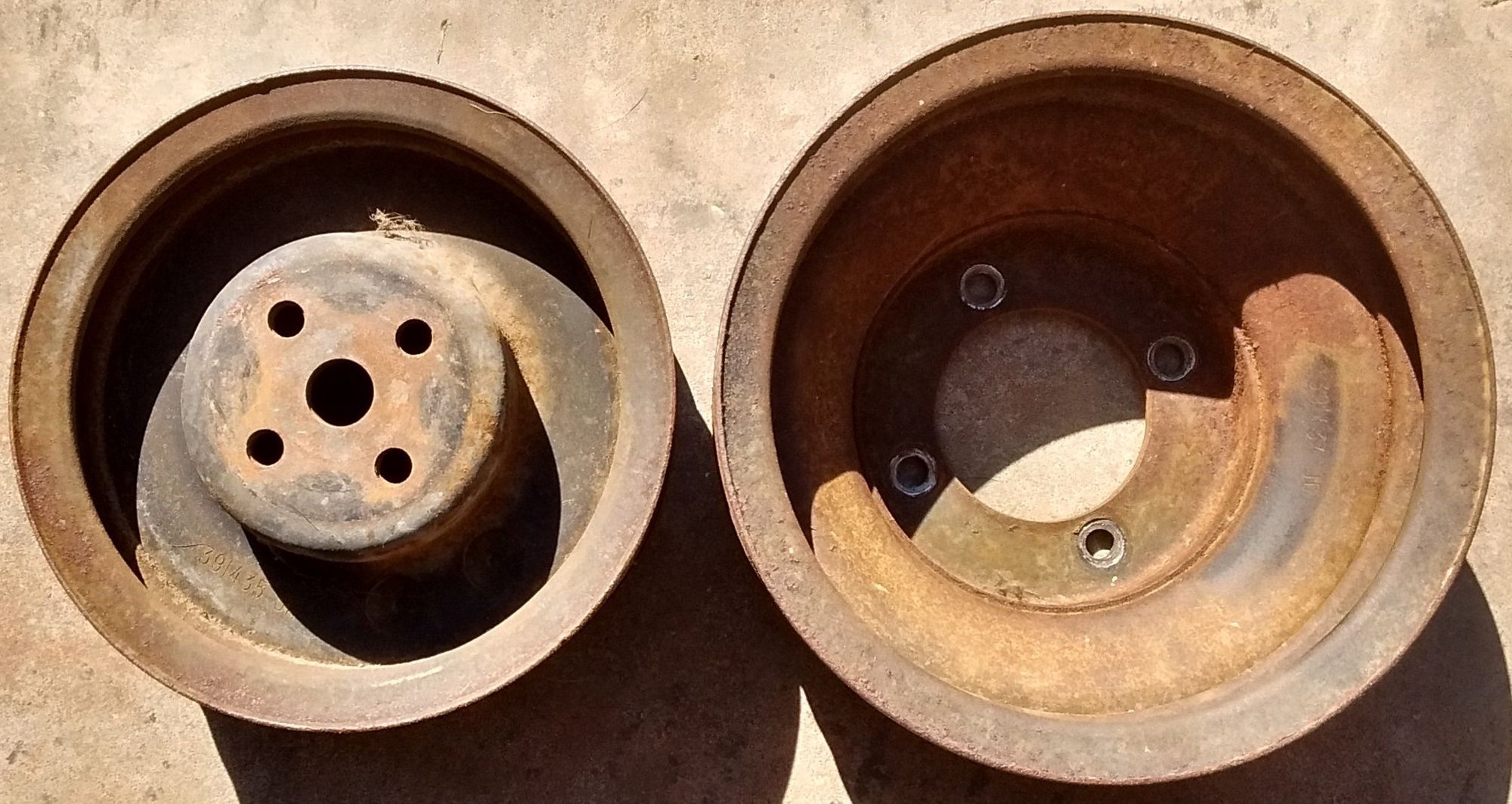

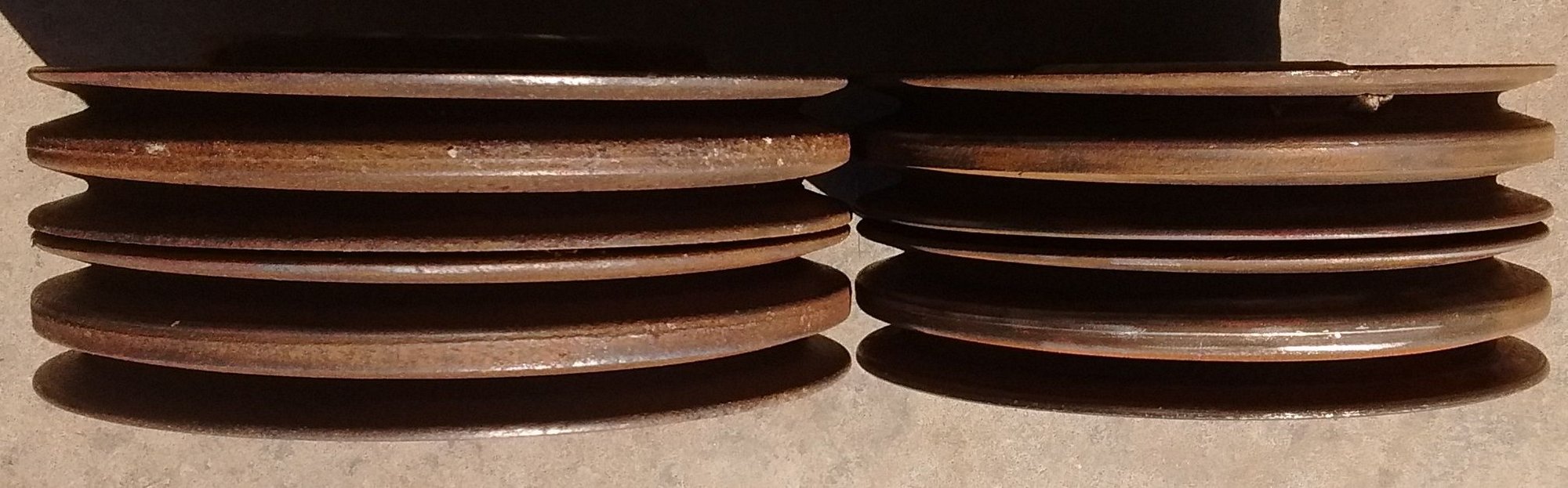

I was pulling some parts off my parts car and found these pulleys. The car appears to be original and I've never seen any like this on CO. The pulleys are 391434-JD (7 3/16 dia) for the crank and 391435-JK (6 3/8 dia) for the WP, they are 4 groove pulleys for the short WP. I've never seen 4 groove pulleys before, what were they used to drive? The car has PS,AC, and Alt, it doesn't have a smog pump. Did some use a double belt for Alt? Curiosity has me asking? Any value or are they wall art?

The 4 groove pulleys are for the A.I.R. emissions cars with an injector pump. Look in the 67 PIM for application.

66-67 California with A/C and A.I.R. only. Pretty rare items, but no demand for them either.
