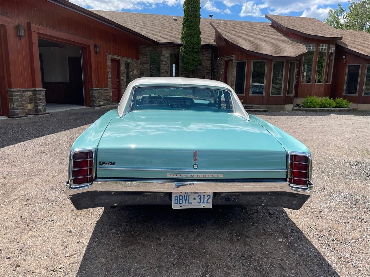

As I look into this further, this is more likely the incorporation of the die case panel at the back of the trunklid. F85 Deluxe and Cutlass cars got this panel, which requires the same holes in the trunklid as the 442-specific panel, so there's no need to call out that hole drilling separately. The base F85 cars got a different trunk trim that did not use the die cast panel, so this may be the indication that the Deluxe/Cutlass style trunk drilling was required to install the 442 panel.
Base F85:
F85 Deluxe and Cutlass:
442:
