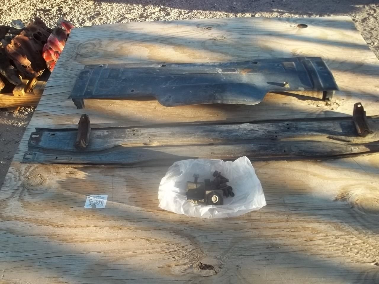

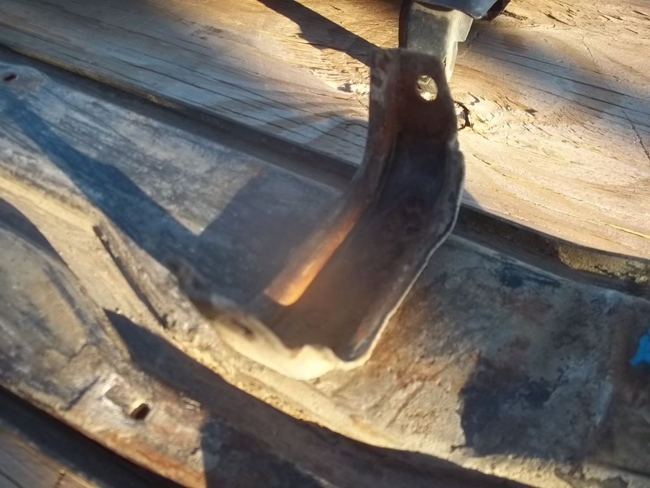

These parts are from a '66 AC car. I frankly don't know the difference between, or if there is a difference.
Old May 30, 2025 | 08:35 AM
Posts: 12,804
The difference would depend on the radiator. AC cars got heavy duty cooling, which contained V01 bigger radiator. I don't know if the cradles were different on it, probably 2 vs 3 core tanks. The condenser bolts onto the actual core support, not the radiator top and bottom plates shown here.

There isn't any difference in any 66 radiator support. The A/C cars have additional bolt in brackets for the condenser and the upper and lower plates are the same except the 6 cylinder cars. 2 row and 3 row radiators have the same tanks, so the saddles are the same.

To expand on the above response, the upper and lower plates are the same on 6 cylinder and v8 cars, except for where the saddles are welded to them.
