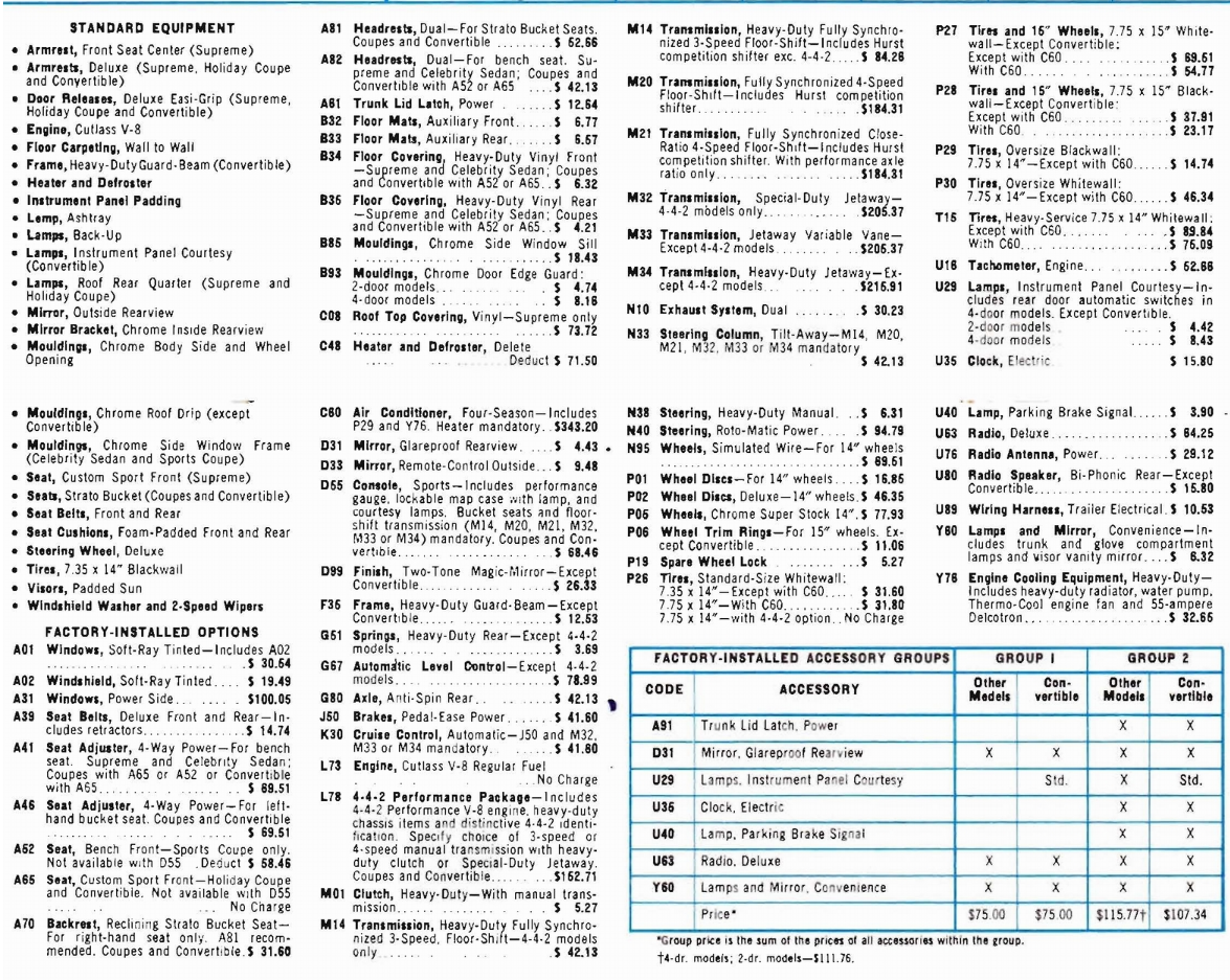

not trying to be obtuse but what's not clear about this information that was posted in your other thread???
Column 1
W = Tinted glass - Windshield only - (A02)
Column 2
X = Floor mounted Automatic Transmission - used with (D55)
Column 5
Y= Deluxe front and rear seat belts (A39)
From the 1966 Cutlass SPECS
Old Dec 13, 2018 | 04:34 PM
Posts: 12,810
The tinted windshield is a slightly blue piece of glass. GM tint is not much.
The transmission code is for an automatic, floor shifted, transmission, probably a ST-300 two speed.
Deluxe seat belts are the same belts, but a steel chromed buckle and a polished steel cover plate with a Fisher Body carriage on them.

Hi Allan,
Thanks for the info and sorry about the repost!! What is the name of the catalog used on your reply. I could not find this information online.

That is an excerpt from the 1966 SPECS booklet.
