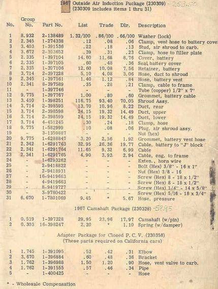

Does anyone have a crisp clear OAI kit from the dealer list sheet?

Here's the 1967 page
I have a decent copy..Curt Anderson gives you a packet that includes the factory OAI kit for both 66-67 I believe along with factory instructions on install. When I track packed my 66 442 I bought the bezel and hose kit from Curt. Its a copy obviously and not a frame worthy copy. I can verify ifyou want.. You can have it. Its not as nice as the doc Joe Padavano posted above

It is widely believed that all '67 W-30s came with a K-19 delete engine assembly, which had the plugs in the heads and a curved oil fill tube, though some say they have seen K-19 engines without the curved tube.
Notice on the list is the rarely mentioned power steering hose.
