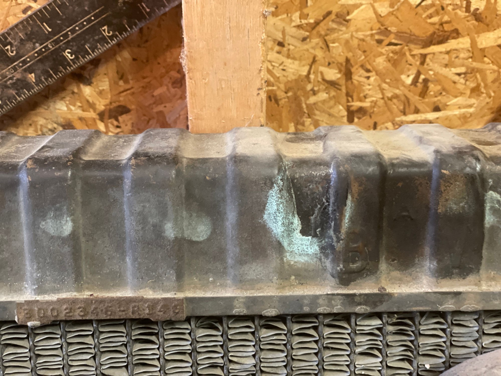

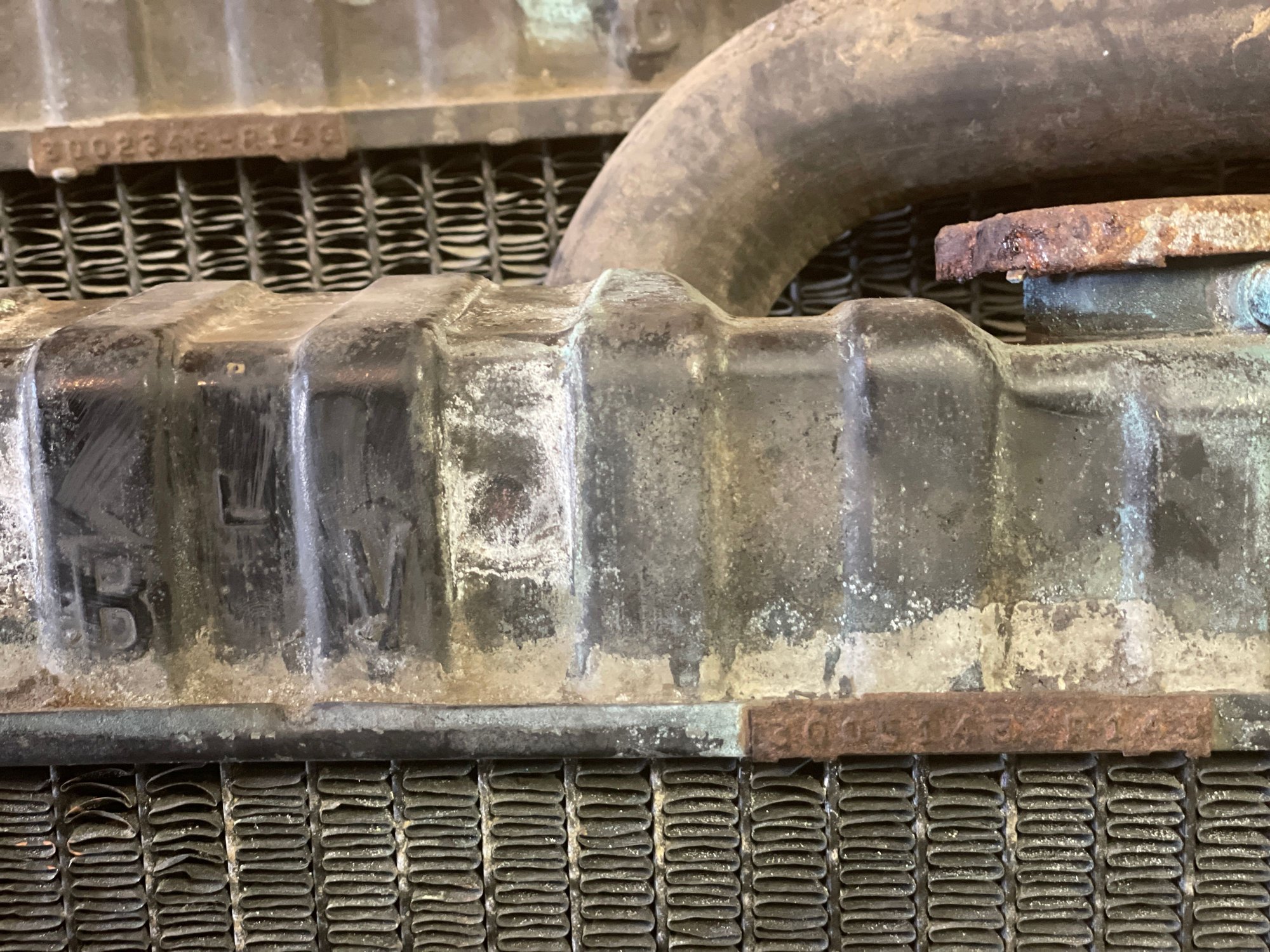

I have 2 65 442s both needing to be restored. I'm currently refurbishing parts for the more complete car and I'm ready to take one of the radiators to be re-cored. The car I'm working on now is an automatic with A/C (12B build date) car that has a Harrison radiator part # 300143-R143. The tank is also stamped BLV. The other car is a 4 speed non-AC (05A build date) car that has a Harrison radiator part # 3002346-R146 and the tank is stamped BAV. Both radiators appear to be identical to my untrained eye. Can anyone help identify either of these part numbers?

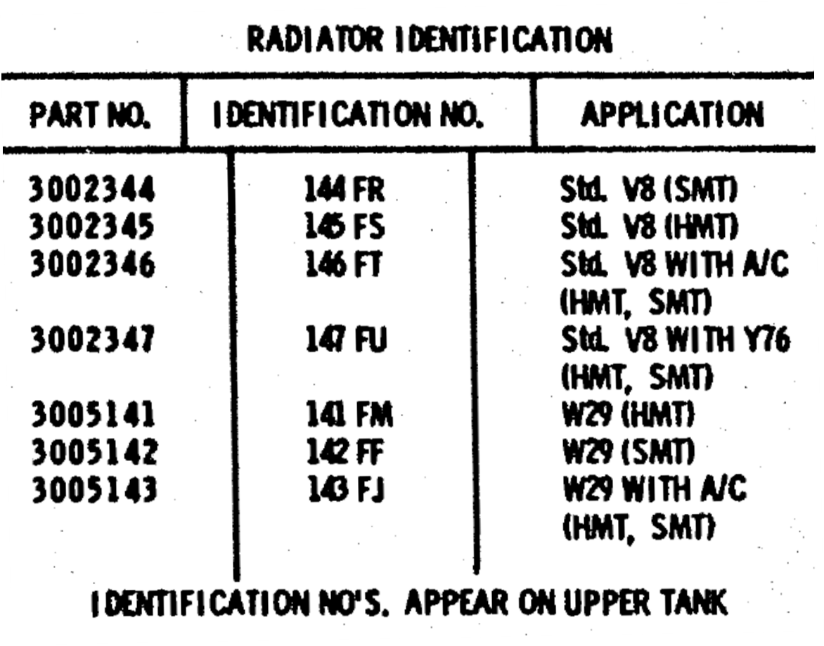

From the 1965 PIM:

this post just help confirm that my radiator is a 3005142 for the w-29 smt for my 65 442. sweet.

Thanks for the information guys. I ordered a 70 A-body PIM from hairyolds last night and a 65 PIM this morning. Guess I could have eventually figured that out for myself. So 3002346 is not original to a 442. I bought that car from a salvage yard 5 years ago and it came without a motor or transmission. I'll go ahead and have the 3005143 re-cored as that was original to the barn find 65 I bought at auction a few months back. That car had been storage in a closed honky tonk since the late 70s. No trunk lock when I bought it. When I got the car home and opened the trunk it was full of old Playboys from the late 70s and early 80s. I'd post a picture but that might offend some.....
