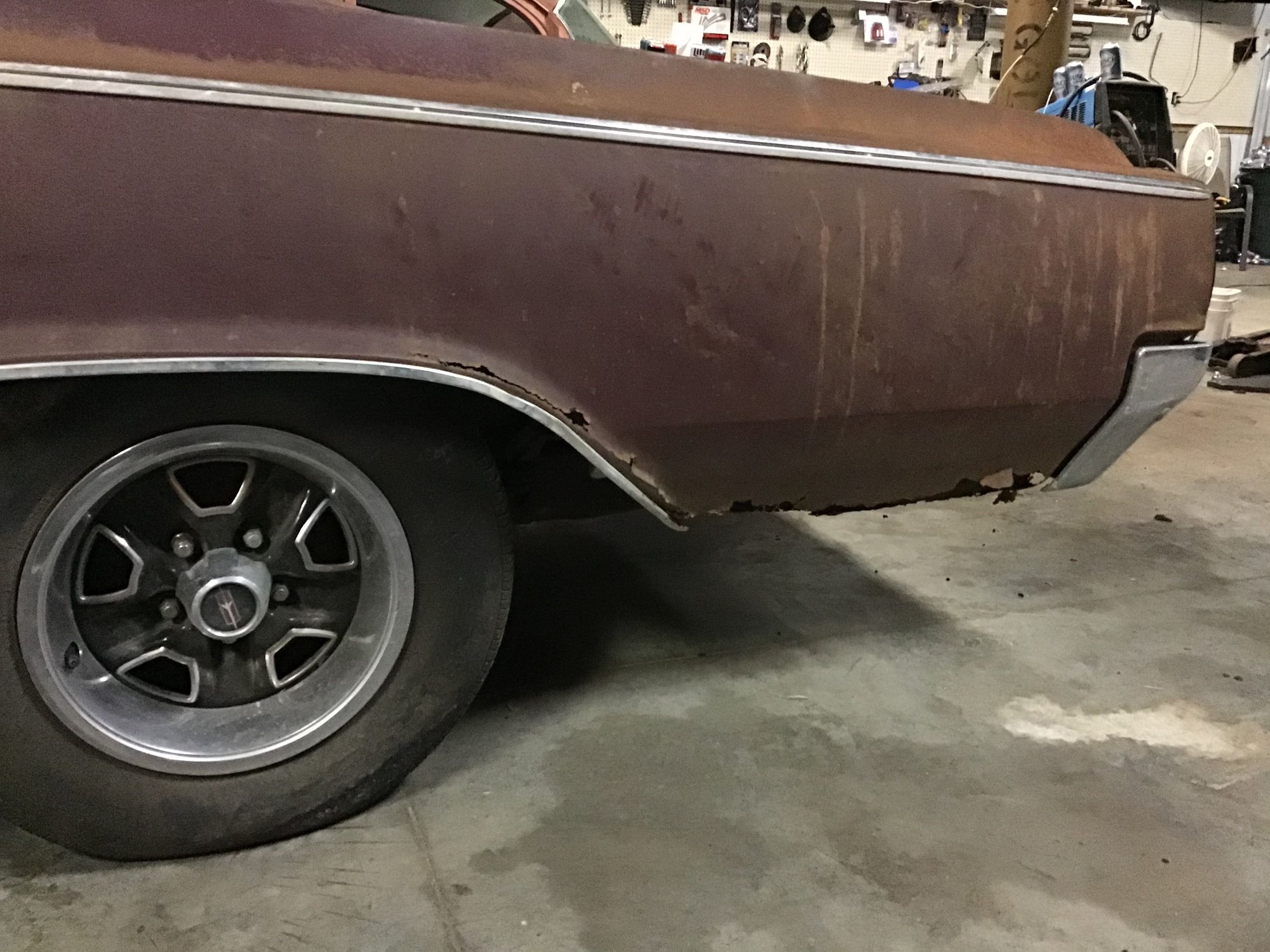

The car is solid, needs a patch panel drivers side lower quarter panel behind rear wheel. I still have to go through everything in the trunk but all the trim is there and looks to be in good shape. It is missing the front bumper though so i have to find 1of those. I will post pics pics tomorrow. The old owner mentioned it was 1 of 120ish so i will post up the tags to see what we can find out.

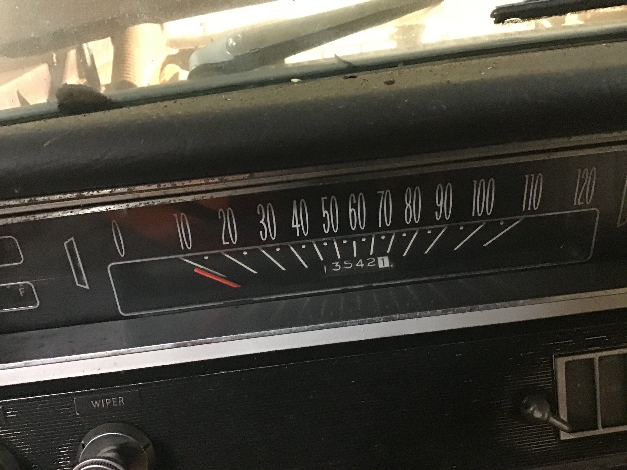

Decided to run out to the shop and grab a few pics.

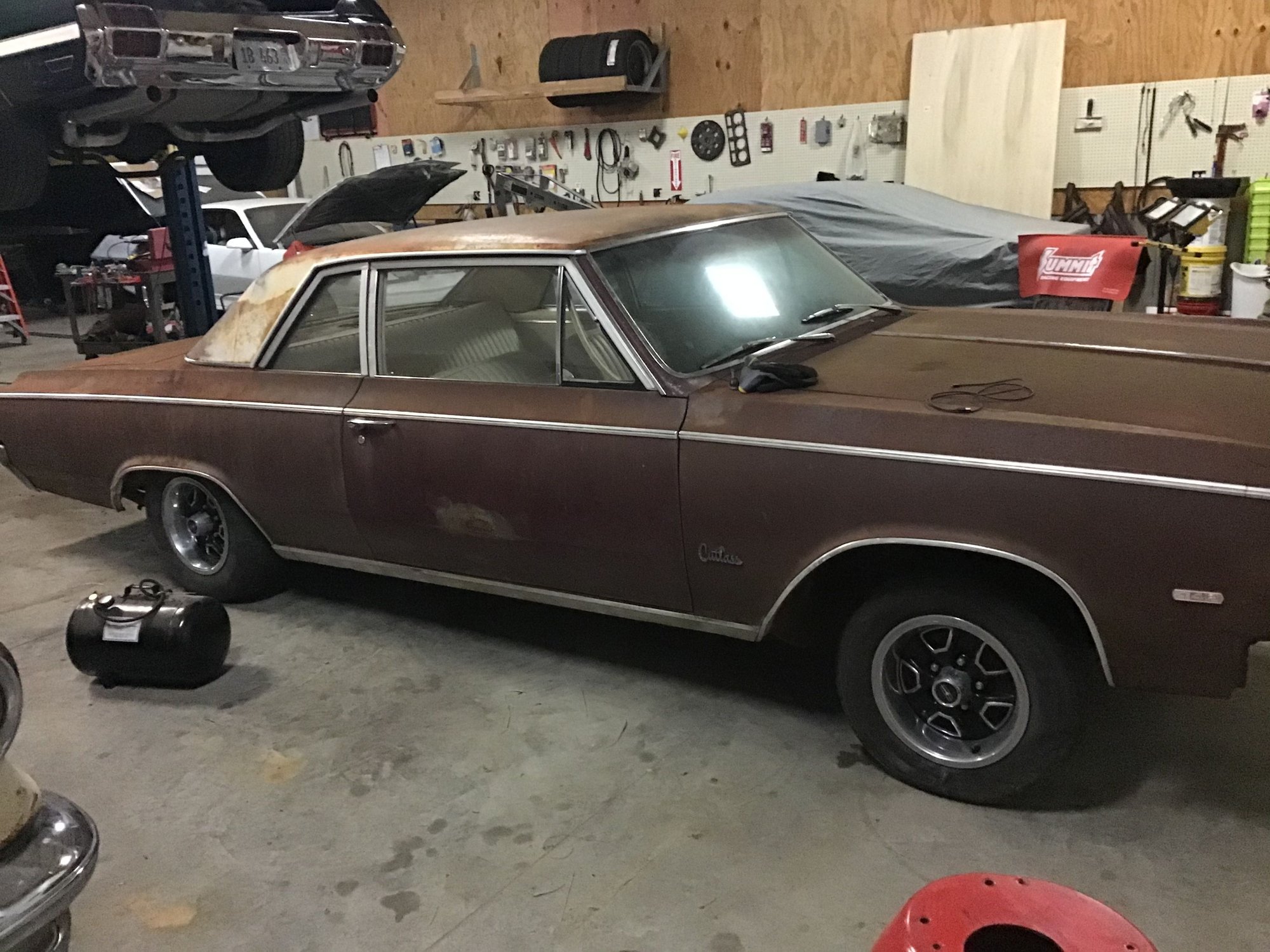

A few more.

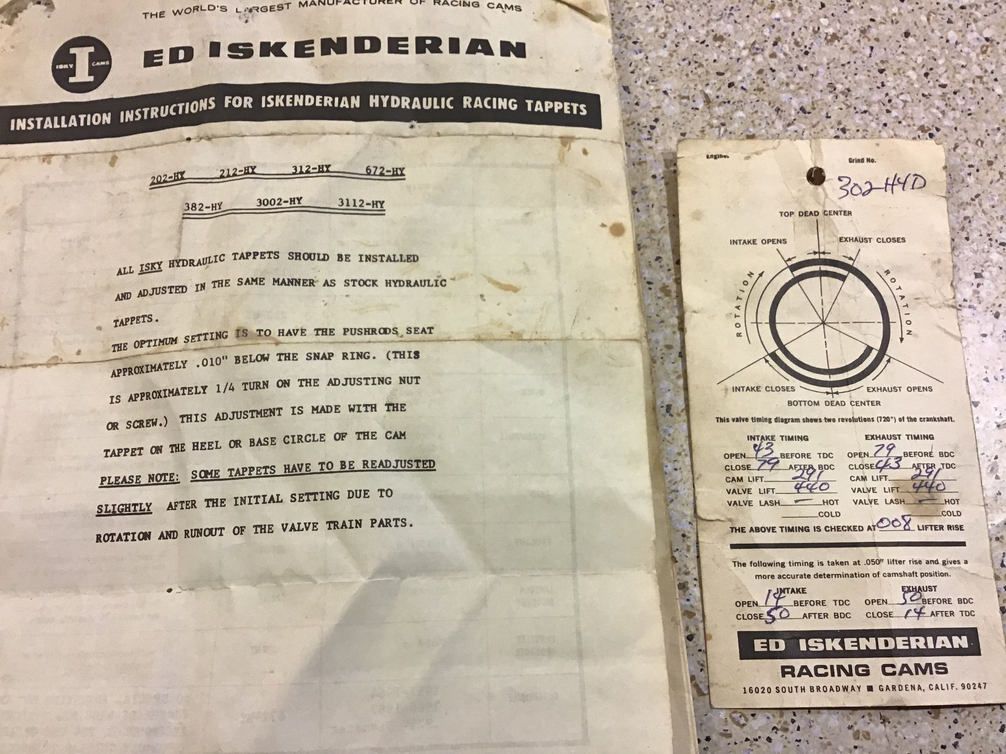

I finally got a chance to go through the trunk. All of the parts are there except the starter and valve covers. There is also a couple gasket kits, carb rebuild kit, plug wires and u joints. The clutch is in great shape as is the pressure plate. In the glovebox i found a cam card and a offenhouser intake installation paperwork. The exhaust has a homemade cutout installed.

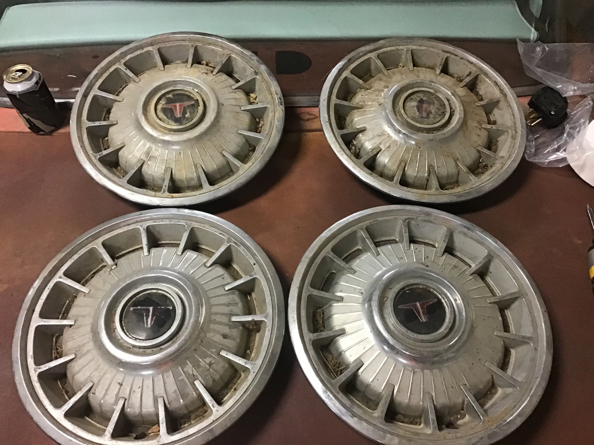

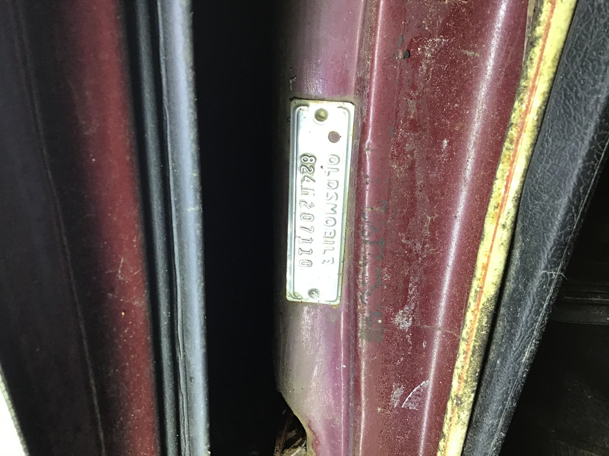

A few more pics, also does anyone know if these would be original in 1964? Would my car have come with a bench seat?

it came with a 947 seat according to the cowl tag

The hubcaps are 64 for sure.

Yep 64 for sure and a picture of the 64 1 year only "dog dish" hub caps.
