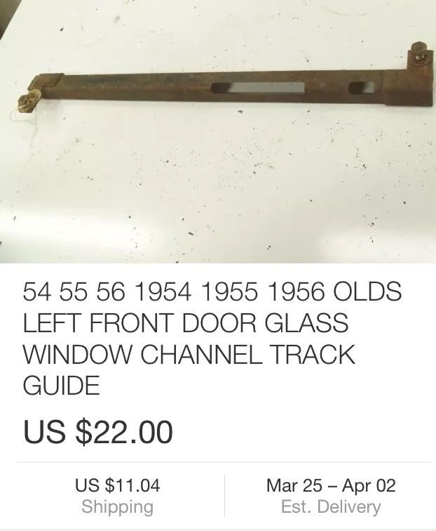

I was hoping someone could help me identify a piece that is missing on the driver, and passenger side door.
At the very top of the door there is a hole (picture) that looks like it should hold the windshield into a "channel". When I drive or close the door....the windshield rattles back and forth. I have to "carefully" close the door, or it rattles around.
I just KNOW there is a missing piece here, and I'm turning to the good folks here who know what it called, or part from Fusik???

There is an oblong hole beneath it.....do the two hold a track for the window? It's 12" down from the top hole.
Appreciate the help gentlemen, would LOVE to know what I'm missing / need to order.

Straight off eBay. The other hole you need to use is the oblong one half way down the door to attach this channel to

Here are a couple pictures of the holes you mentioned filled up with the parts.... Tedd
