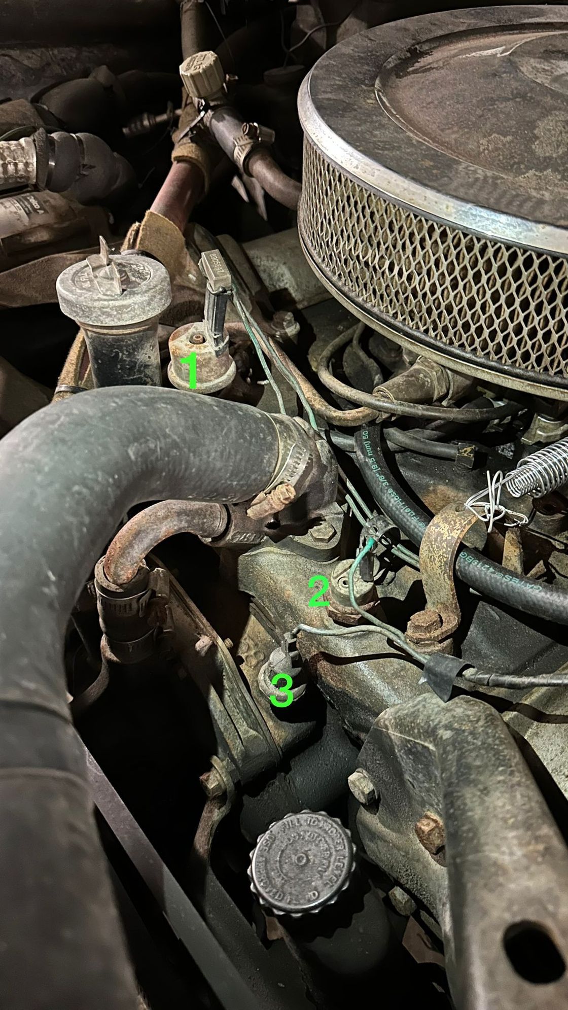

Hello! Could somebody please tell me what these parts are? Marked as 1, 2 and 3

#1. Thermal vacuum switch for the transmission controlled spark (I think).
#2: coolant switch for the hot light on the dash.
#3: oil pressure switch for the oil light in the dash.

What model year & engine is this? I could guess - but, I won't. Currently #1 in your image is non-functional if it has no vacuum hose hooked to the top (as depicted in your image). Therefore, the electrical connection can be removed. Can't see how the vacuum hoses are being routed on the side of the transmission controlled spark device from you image, none-the-less it's non-functional w/ no vacuum hose connected on the top. The image below is ONLY an example - since we don't know your model year & engine. Therefore, use w/ caution. These devices are all contained/specified and labeled in the CSM.

Oh yes, sorry, the engine is from 1971 oldsmobile cutlass supreme, 350 cu in (5.7 L).
As the #1 is non-functional would it be ok to take it off and replace it with some sort of a plug if I manage to find one?

As stated (Jesse) there really shouldn't be any question regarding the benefits of the CSM. Purchase a used original paperback 1971 Oldsmobile Chassis Service Manual. It is your bible - absolutely nothing comes close to delivering the information you require in addition it includes the original color wiring diagram/schematic.
Yes, it is fine to remove #1 (Distributor Vacuum Control Switch/Transmission Controlled Spark) & plug the hole with a standard water pipe fitting. You can then remove the wiring to the DVCS - most just wind it up, tie it off near the firewall (could be the chance "someone" may want make use of it). You'll need to route your vacuum hoses appropriately. I have a thread on the routing for a DVCS delete. I'll have to search for it. The fitting is a standard water pipe fitting.

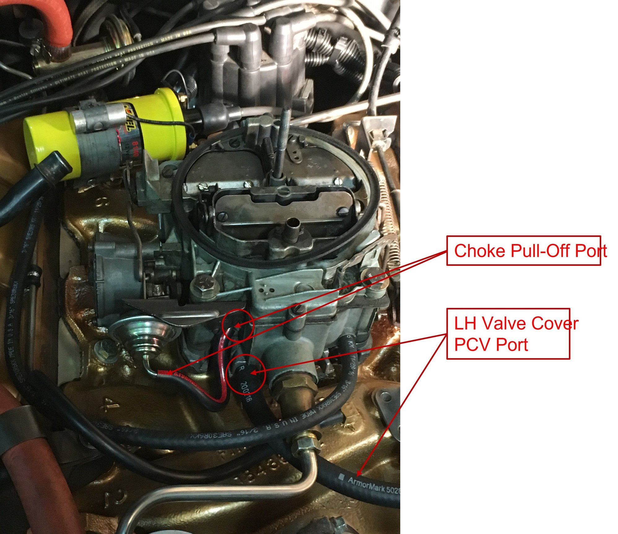

The following images should get you through the correct vacuum hose routing for a 1971 350cid Rochester 4bbl carburetor with A/C after deleting the DVCS. As noted in my image(s) below, there are two ports on the back of the Rochester 4bbl carburetor - the topmost port is for the stove choke pipe filtered air source (rear right hand [passenger] side of carburetor) - nothing changes to this filtered air source. The rear left hand driver side of the carburetor needs to be capped as it will no longer be attached to the top of the deleted DVCS. Note also the one port is capped on the front of the carburetor (see images).

I forgot an image. This image simply notes the location of the LH PCV hose connection to the front of the carburetor. I don't use a LH RH PCV connection. None-the-less, this image simply demonstrates location of the LH PVC hose location. It also demonstrates location of the choke pull-off vacuum hose which you do not change.

Thank you for the pictures! I think the previous owner of my car has done the vacuum hose routing but for some reason left the #1 in place. I found a fitting standard water pipe plug from a local hardware store and replaced #1 with it!
