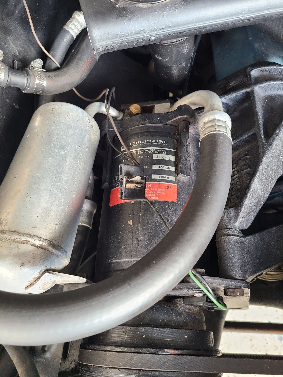

Hi
The prior owner removed the heater core and bypassed it.
The blower motor works perfect. The vent switch works.
The a/c had no belt on it and he said it hasn't worked in years.
I got the belt on, but there appears to be an extra plug on top, not sure what is for? See photo
Any advice? Thanks

It's for the thermal limiter fuse. Follow the tan wire and it should be connected to a pin switch on the compressor rear head.
Its purpose is to shut the compressor off if the refrigerant charge goes low, either from normal leakage or a catastrophic loss of refrigerant. They'll also blow for no good reason.
You'll either have to install the thermal limiter fuse or install a jumper wire in its clip to get the compressor clutch to engage.
Suggest getting the 71 factory service manual if you don't have one. Airconditioning section covers the thermal limiter circuit. CSM actually recommends removing the fuse and installing jumper wire when charging the AC system.
One reason can be starting the engine with the AC on. You can start (or restart) the engine with the AC on a dozen times or more and not have a problem. Start or restart the engine that one time and the thermal limiter can pop. Why? I don’t know. This was pointed out to me many years ago and I’ve had it happen to me. Lesson learned. Shut the AC before shutting off the engine.

Update, so tried starting it with the belt on and the compressor must be seized/frozen. Won't turn at all.
So looks like might be time to convert it to 134.
