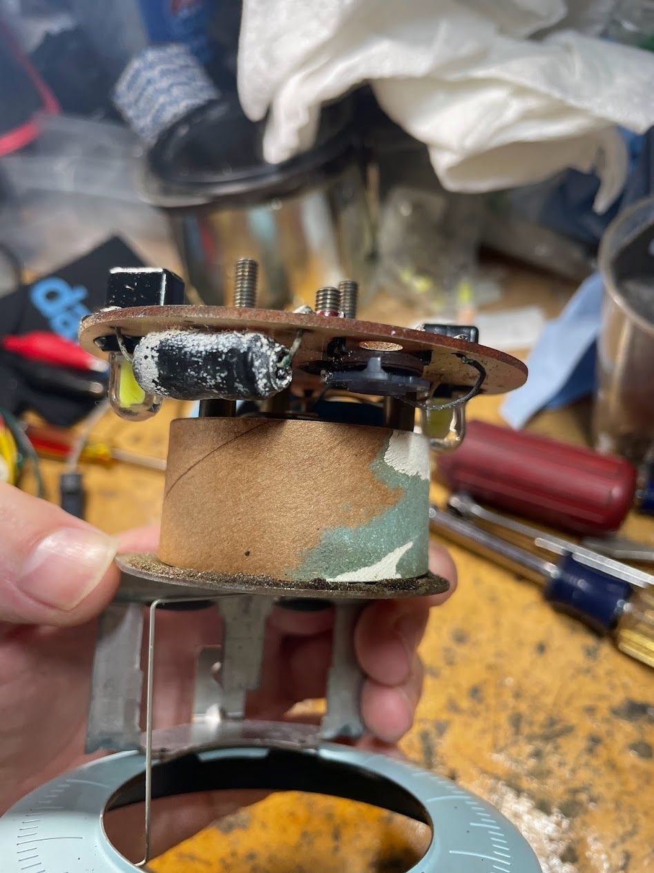

I have a 1968 Cutlass Convertible that has a factory Tic Toc Tach. The tach works but does not always display the correct RPM (off idle it reads to high). I have narrowed down to what I believe is a bulging capacitor(s) on the tach circuit board. I would like to replace them but have no idea what their ratings might be can anyone lend a hand in determining what capacitors should be ordered and replaced?
Black capacitor I knocked off all the white powder but now idea whats its ratings might be. Looks like it might have been leaking too on the cardboard tube.

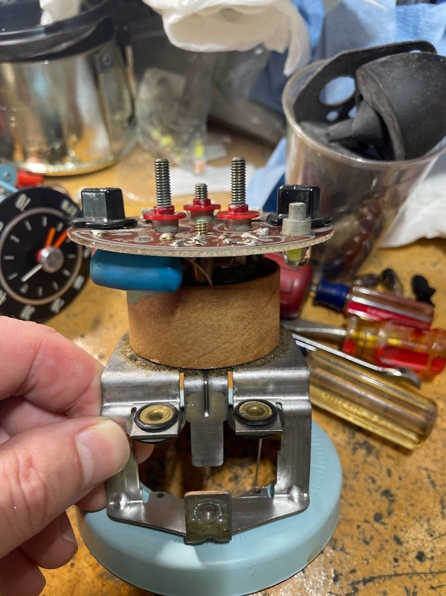

The blue capacitor looks OK but still really can't tell. I guess I could remove and do some ohmmeter testing?
Any thoughts on how to approach this problem would be appreciated.

Most capacitors have markings on the component body with the voltage rating and capacitance value. Not sure if any of that is still visible on your parts.

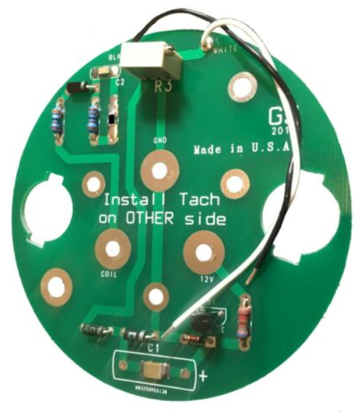

https://www.ebay.com/itm/14328556703...mis&media=COPY

That is awesome! I would have never thought someone would be making new circuit boards.I will contact them I have a few questions like, I can't tell from the photo if the new circuit board will provide power to the clock and why is there no traces to the light bulbs? I will find out and let you know how it turns out.

There are traces on both sides of the board.........

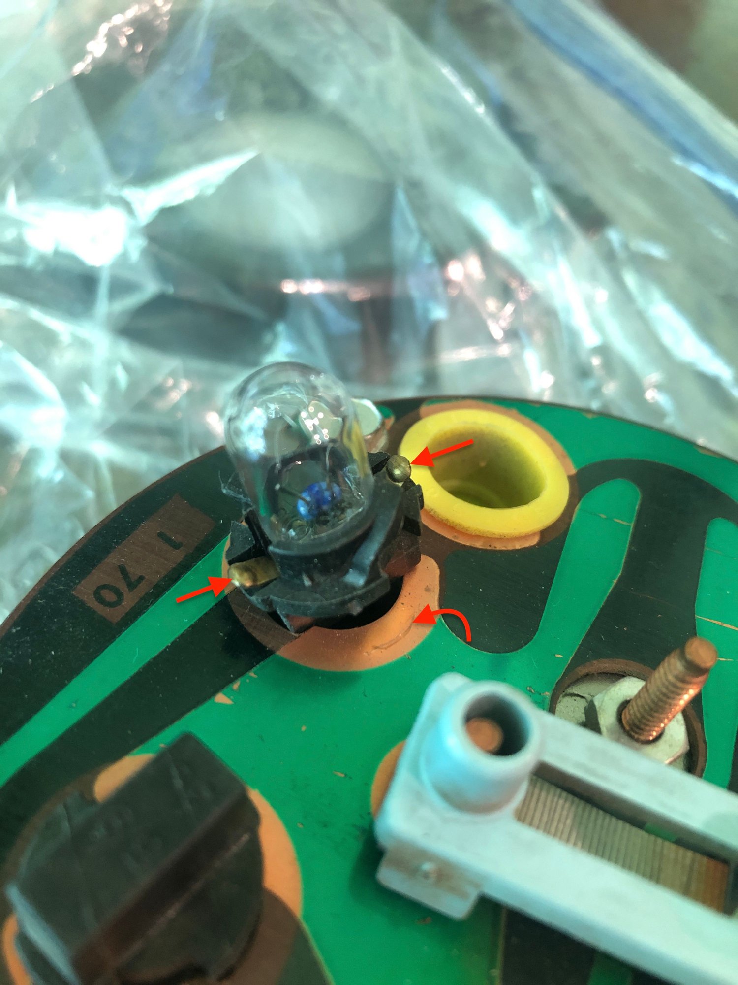

Fun71 this is a pic of the rear of the idiot light pod. If I understand your question correctly, when the bulb that is inserted into the fixture is turned upside down and twisted into the opening the two prongs at 2 and 8 oclock make contact with the positive side of the board. The ground is accomplished through the dash. As said, this is the backside of the idiot light pod, almost certain the TTTach lights are the same.

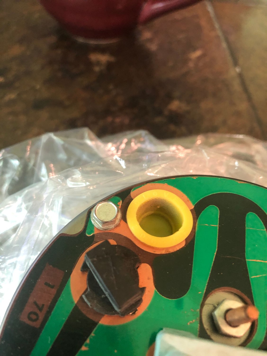

The lights fit into their connector that go through the holes in top of the board just like the rest of the gauges. The traces for the lights have to be on the top of the board because that is where the lights socket expect to make there electrical connection. This cannot be reversed or the light will be shining inside the dashboard instead of through the gauges to to your eyes.

You are correct about the "twist in" bulb sockets - they need exposed copper traces in order to make electrical contact. I just did not know for sure if the tach used that style or the clock style that I posted.
This thread may be of interest to you:
https://classicoldsmobile.com/forums...repair-125300/
It shows the bulbs are indeed the twist in socket types and there should be surface traces for the electrical contact.
Also note you can see the large capacitor markings - it's a 4.7µF 16 Volt electrolytic capacitor that you should be able to find at any electronics supply store.
