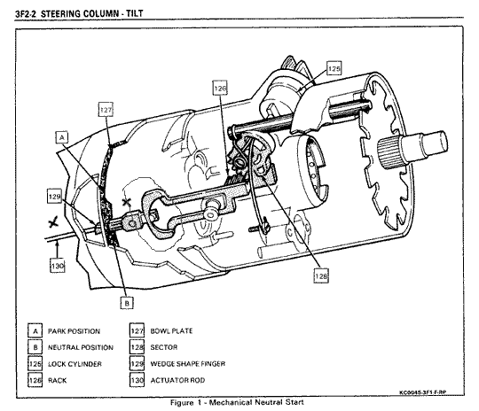

Unfortunately, it could be one of many things. The switch could be bad, the linkage rod could be bent, the rack and pinion at the lock cylinder could be damaged, or the return spring could be damaged. Also, would this happen to be a column shift car converted to floor shift? If the backdrive linkage isn't in place, the collar on the steering column can vibrate out of position and cause the rod to bind. Is this a tilt or non-tilt column?

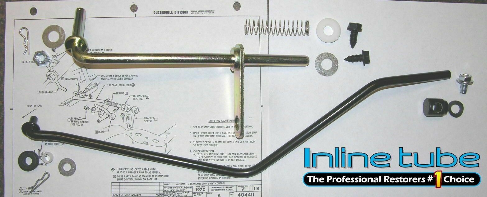

Is the backdrive linkage still in place (may have been removed over the years)? If so, are the plastic bushings worn, causing slop in the linkage?
I'm not entirely sure where the backdrive linkage is located? Is it inside the column? I haven't disassembled it yet.
Old Jan 14, 2022 | 01:26 PM
The backdrive linkage runs from the steering column to the shift lever on the trans. It looks like (and is) the same rod used for a column shift car. This is to lock the floor shifter with the key, as required by federal law.
Old Jan 14, 2022 | 07:04 PM
Posts: 15,409
It is underneath the body, connected from the steering column at the firewall to the transmission shift ear.
