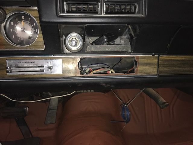

So I have been working through the interior of my recently bought 72 Cutlass. Previous Owners have chopped up the dash and installed a Craig radio. Looks to me like they sawed part of the dash away to do this? I would really like to go back to an original AC Delco radio. I don’t care much about how well it sounds. I’m more into how it looks. So I am wondering what it would take to mount an old radio into this dash? A few pics.

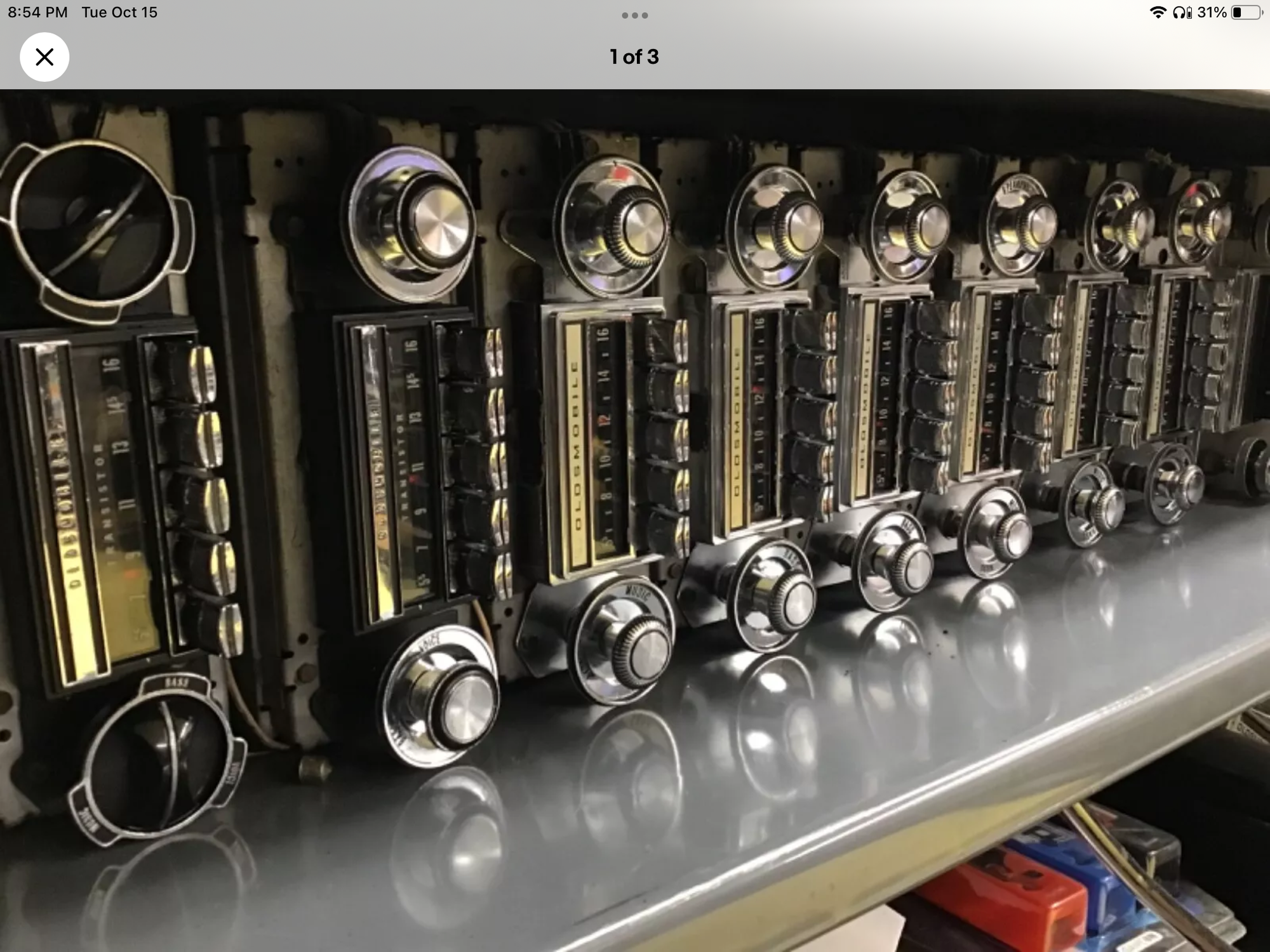

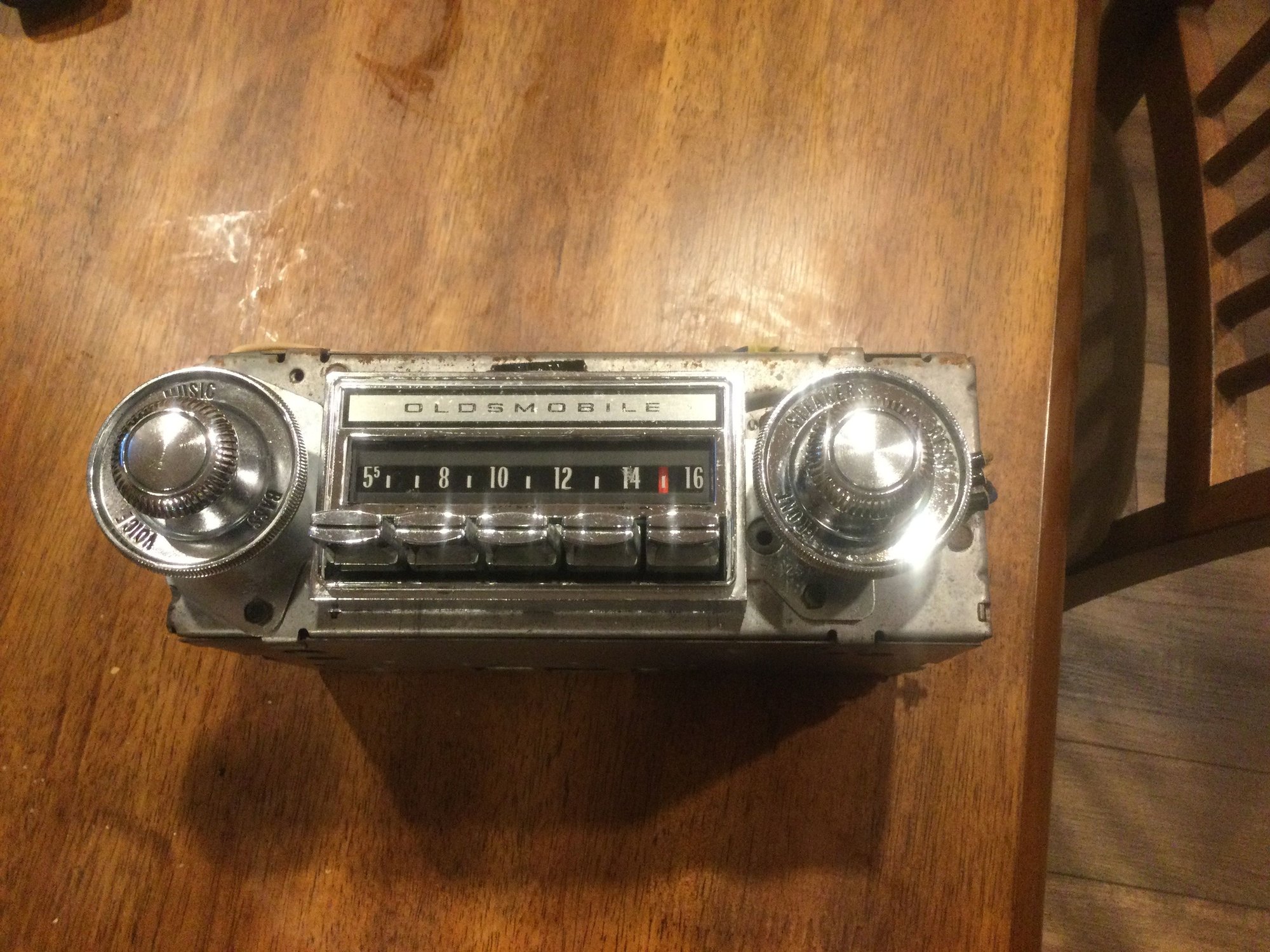

I found these on eBay. I have a convertible, and have found the blue wire that appears to go to the rear speaker. Speaker looks shot, so will need a new one.
Or is bringing this back to a stock condition just not worth the headaches? I would enjoy hearing other ideas.

It takes a new lower dash, unfortunately. And even the one in this photo has been filed for a larger stereo.

I would fill the repair/replace the dash and fill the hole with an in-op stock radio. I have several classics, with no working radios between any of them. I bought a dewalt jobsite radio that runs off my 20v batteries. Its roughly the size of a shoebox and offers killer sound. It Bluetooths to my phone. That radio goes between five cars, a boat, camper and the garage. Its one of the best things I've ever bought. I toss it in the trunk when parked. Soooo much easier than trying to mess around with the factory stuff and much cheaper. Not to mention far superior sound quality. I'm all in for about 150 bucks and the install time was roughly 15 seconds!

as has been suggested, you'd need to replace your dash fascia with a non-butchered piece in order to put an OEM radio back in with the least problems. There's also a factory mounting bracket for the radio body that you'd need to source if you did go back with the OEM unit.
It's possible if you filed away the rest of the **** recess mount areas in your existing dash that you might be able to install a modern full-face radio (i.e. such as a removable-face unit).

Well…..I’m in for an adventure! I bought a Delco unit off eBay. Nice man really. I explained the situation to him, and he included a wiring pigtail and a bracket. So, I’ll try to remember to post up the temp repair.

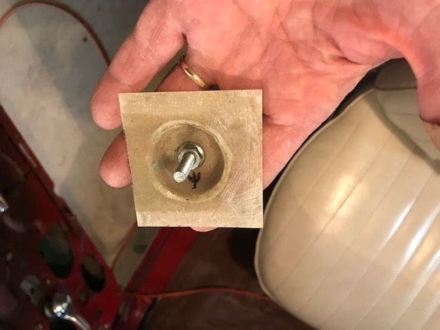

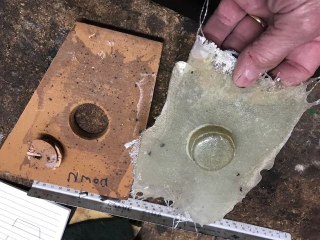

I got back to this task and have made some progress. I created a two piece wood mold and using epoxy and fiberglass cloth, made a left and right side control recess. I carefully measured control shaft centers. I finished cutting away the small remnants from the back side of the dash. Trimmed up the molded pieces and bonded them in.

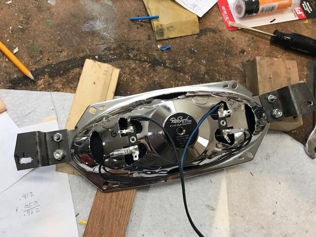

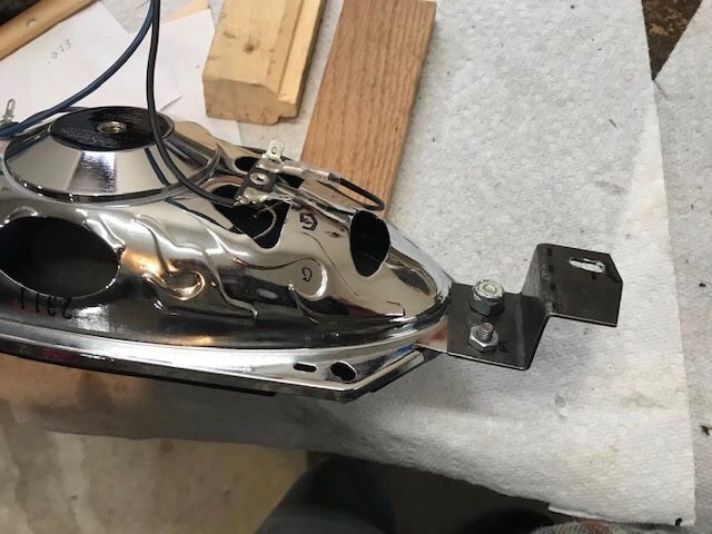

I bought a new 4 by 10 speaker and got it wired into the harness.
New speaker
New speaker
I had to bend up some new mounting brackets
Wired up for 8-10 ohm operation

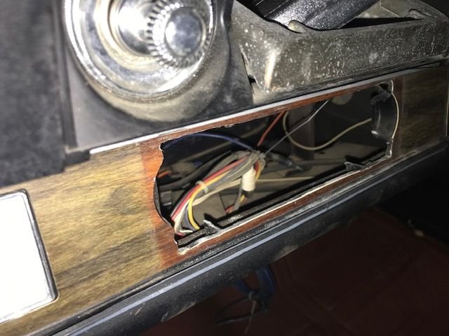

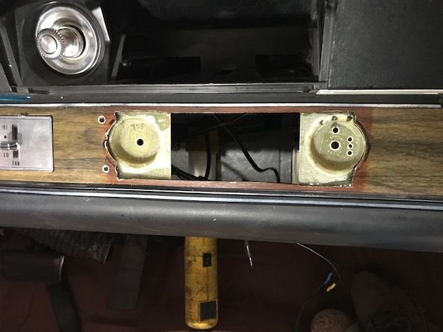

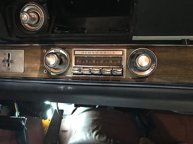

I now have the fiberglass patches bonded to back of dash. Have test fit the radio. Completed restoring the radio wiring harness. Installed a new rear speaker and connected it. Powered it up and it works!
Left recess is drilled for the front rear speaker fader control.
Right recess is drilled for the front rear speaker fader control.
With control *****, a lot of the ugly is hidden.  After this photo, I used body filler to get the surfaces planed out.
This has been a lot of uncomfortable work, under the dash with old man eyesight and aching bones. But I am glad that I didn’t just drop in another new radio. The original ones are pieces of art compared to the new ones. My feelings anyway.

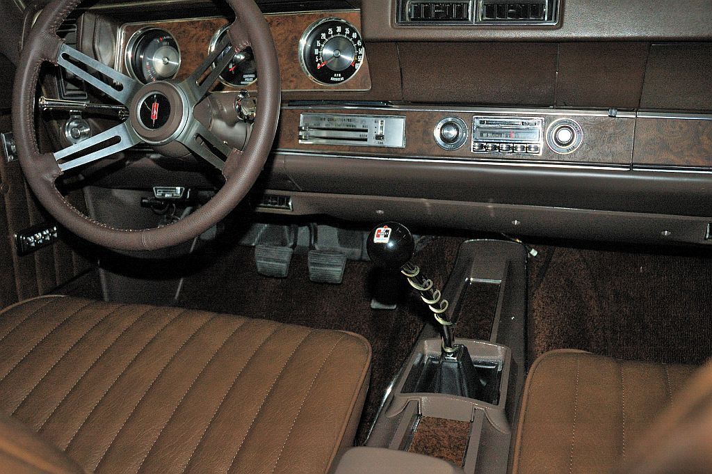

Here are some pics:
Old Dec 24, 2024 | 06:00 AM
OLdGreenPaint's Avatar
Joined: Jul 2024
Posts: 353
From: Iowa!
@71olds that is some nice work! To me, the original radios have an elegance that is worth returning to the car. You did a bunch of work to get it back.
Old Dec 24, 2024 | 02:53 PM
71 OLDS's Avatar
Joined: Feb 2011
Posts: 700
Thanks! This was done by Frank Trimble when he was doing some work on my 71 442. It's an original 8 Track car and when we put the 8 Track back on it just didn't look right with the modern looking stereo. We struggled on options to go back to stock and then I found the 68/69 bezel in one of the parts catalogs. We still weren't sure it would work with a 70-72 set up but were extremely happy when it did. To be clear it was LOTS of work. These few pics don't do it much justice but you get the idea on what's involved. So happy to have the more original looking stereo with the 8 track player back where it belongs even with my custom dash gauges and 6 speed white cue ball size shifter, I think everything looks as it should now.
