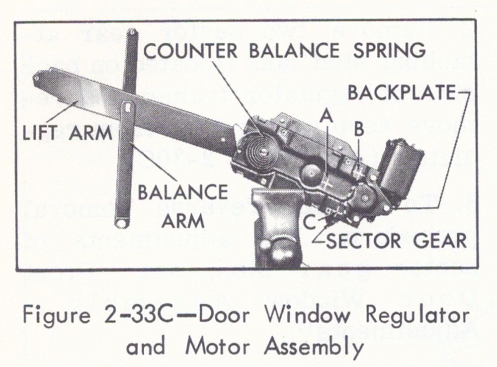

I dont own the Fisher manual and cant find the pdf online for free anymore. Do you have the page that goes over replacing the motors? It's a 68 Holiday Sedan and I need to replace the pass front and rear motors with a set I got from a member on here.

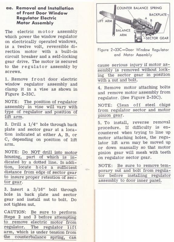

In regards to the comment about drilling a hole in between the two arms. Basically just drill a hole and place a pin in between while I remove the motor to prevent it from dropping the glass? Am I understanding that correctly? I don't have the body manual, just the assembly and chassis service manuals. Can you take a photo of page 6-26 for me?

No, usually I take the motor and regulator out as a unit after I slide the rollers out of the slide channels. The lowest channel is removed with two bolts, slide channel off roller, then wiggle the upper rollers out of the upper channel. Need to block the glass to keep it from dropping. Then, when the whole thing is out you drill a hole through the two arms where they intersect and insert a bolt (1/4") and nut to keep the counter weight spring from folding the unit up when you remove those three bolts that hold the motor in place. Hope this makes sense. No pics, my tech went to bed. She starts early AM and I don't have the app on my phone which also does not have data.

Four bolts hold the motor to the door. and when you get the assembly out, I think it's three bolts to remove the motor from the regulator. I don't know what is going on with this underlying problem. I'm going to sleep on it.

I took a closer look and I think I got it. Rear door is a bit different the motor is mounted on the bottom right of the door but shouldnt be hard to figure out. I'll give it a shot when I get some free time. Thanks for your help.

Started with the front and got it out. Got some nice cuts on my hands and wrist as well. It took a bit of manoeuvring to get it to come out, the motor that is in there now is a bit bigger than the original and made it harder to come out.
Which pieces so I need to drill and pin? I am assuming the black gear with the plate behind it?

I dug around some other forums and was able to find a scan from a Buick (63-65 Riviera) manual. If anyone was looking for it here it is:
