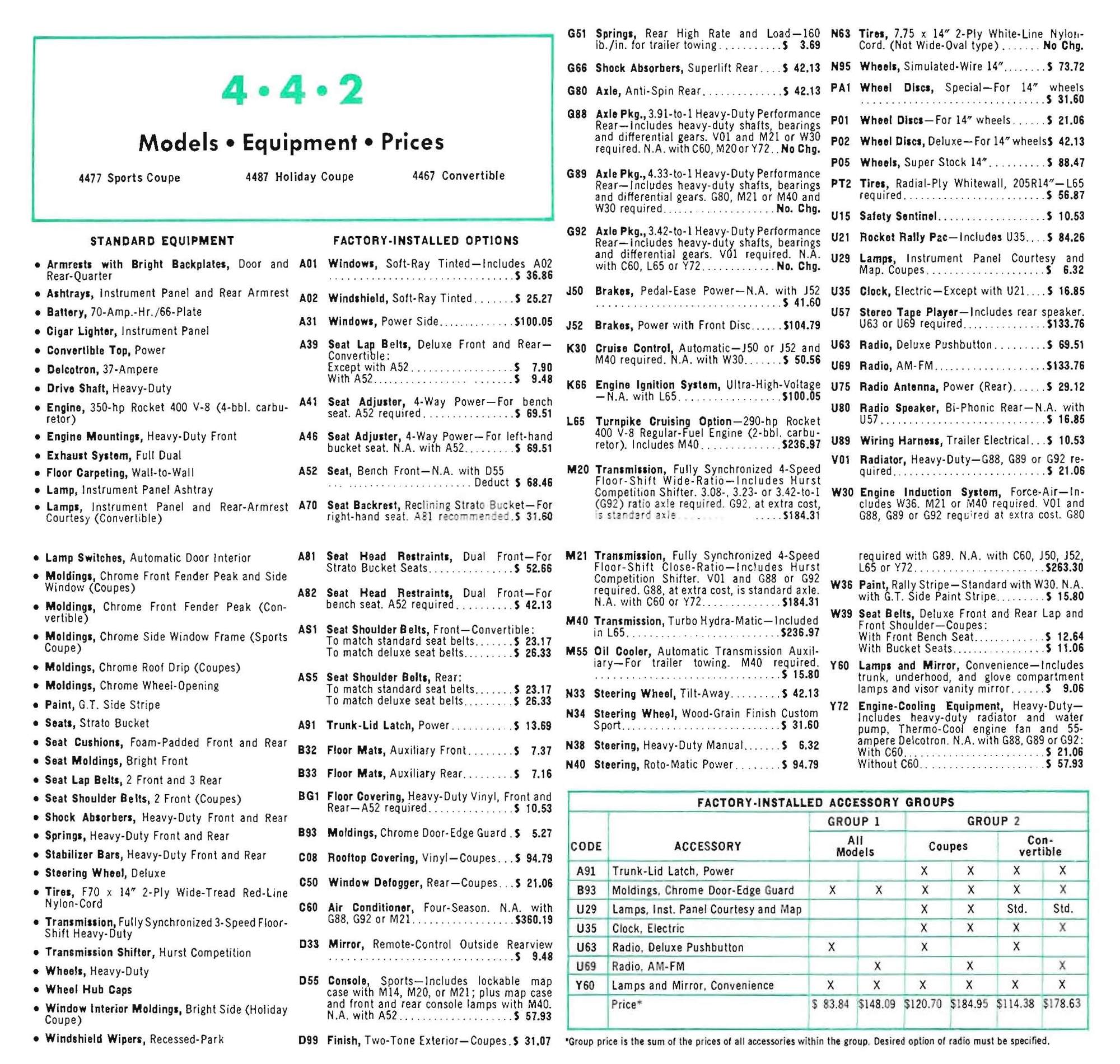

There is no "correct" location. Power locks were not offered on the 1968 442s. RPO A93 was first available on the 1969 model year cars.
From the SPECS booklets. 1968 top, 1969 bottom.

69 shows A93 n.a. with W30. That tells me 69 A car had vacuum operated power locks same as BCE car.
You are correct, Glenn. The 1969 power lock system was vacuum operated, as shown in the 1969 Fisher Body Manual.
