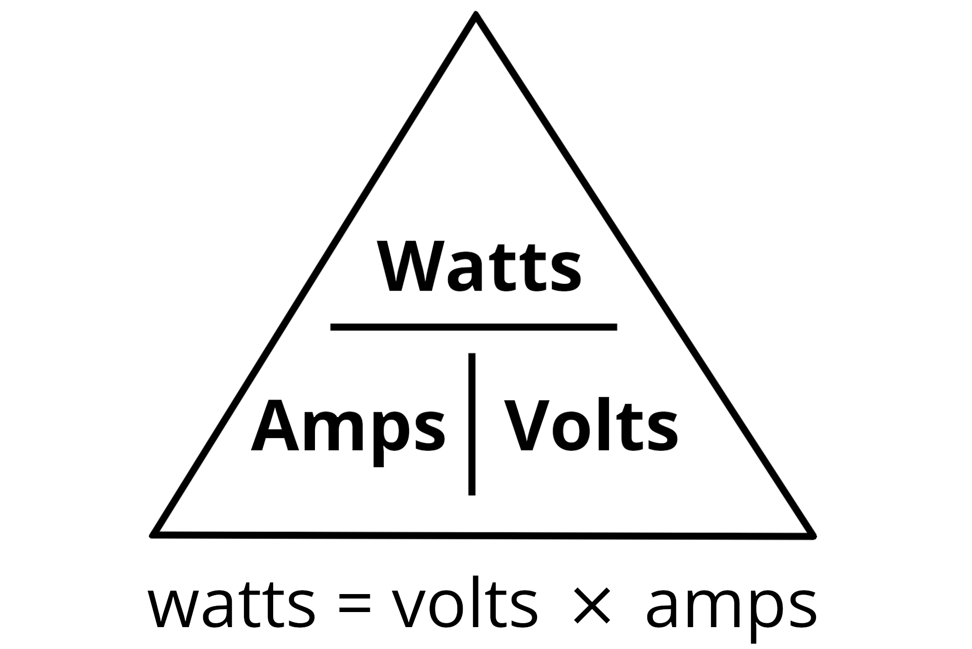

to calculate amps , you divide the wattage by the volts. So for a 10 watt bulb, you would divide that by 12 volts = 0.83 amps. Then just sum up all the amps you calculated for your circuit. The led's will list the actual wattage they consume (use that number, not the equivalent incandescent wattage) You will see they are very low wattage.
Old May 7, 2022 | 12:48 PM
Posts: 25,628

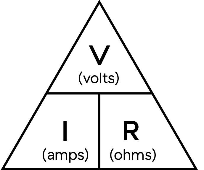

As Pat has already provided, two key triangles I find extremely handy which can be put to memory or kept in your folder somewhere:
