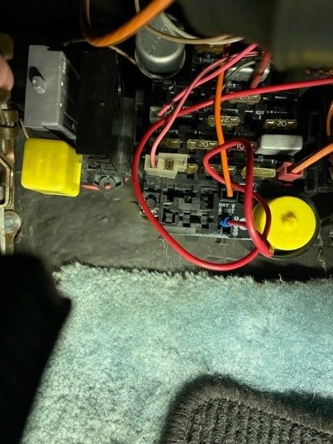

Hello, just want to give a little feedback.
Measring the voltage of the alternator without accelaration was about 12.4 Volt.
It seems a little less to me as it would mean that the battery would not be charged waiting on a traffic sign.
After changing the alternator things getting better, 14.4 Volt, but not good.
Still have the issue that if I switch on the lights, turn light stops working.
Switch off the lights, turn lights work just fine.
At least I could pass the german inspection and can drive for another 2 years now.
But the issue still exists and I will keep on investigating.
Any hints are welcome.
I would not replace the turn signal flasher.
Re-read post 12:
When the alternator/generator doesn't put out at least 14 volts the lights don't flash properly. The voltage draw makes the blinker blink. Not enough & it stays on solid. Sounds like you need to check the generator.
If the charging system voltage is only 12.4 at idle speed the charging system is not working properly. When the head lamps are turned on the voltage at idle speed will not be enough for the turn signal flasher to operate. Have you checked the alternator belt tension? A loose belt will not turn the alternator fast enough at idle speed but may work at higher RPM's.
If the belt tension is correct diagnosis of the charging system should be performed before replacing the alternator.
Re-read post 12:
If the new alternator is producing 14.4 volts, you are OK. The flasher might be a heavy duty unit for a trailer pulling car for example. Try a new regular flasher just for the heck of it. Cheap & easy to do. A bad flasher will act like you say. Change it.
