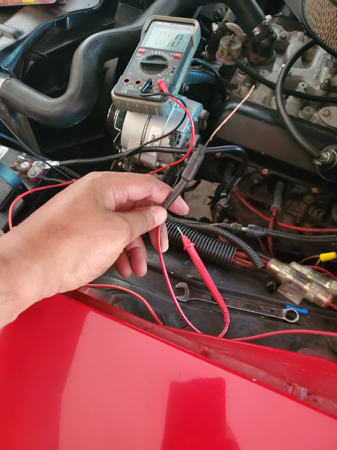

I am struggling to chase down this electrical issue on my 71 Olds Cutlass Convertible. I was driving one day and the car died. After investigating, I found that the main starter wire had grounded out against my headers. I took it all apart, bought new battery and starter, and rerouted wires away from headers. Got in to start it and...nothing! No dash lights, no clicking, no head lights. The horn and the top motor work though, so I started testing components and found that I had no power to the fuse box. I also ran 12V directly to purple wire going to the starter and it cranked up. That tells me that both my starter and my ground should be good. I have over 12V going through the fusible link, and 12V to the orange wire on the firewall which I believe powers the fuse box, but no voltage to any fuses. Because there is direct power the fuse box, I didn't believe there was a component that could fail and kill power to the box. Maybe I am wrong though, could the ignition switch or neutral safety switch cause this? or maybe the voltage regulator or module in the HEI? I tend to think not, but any help would be greatly appreciated.

I have added a couple of videos so you can see whats happening, and the tests ive run.
Video 1:
Video 2:

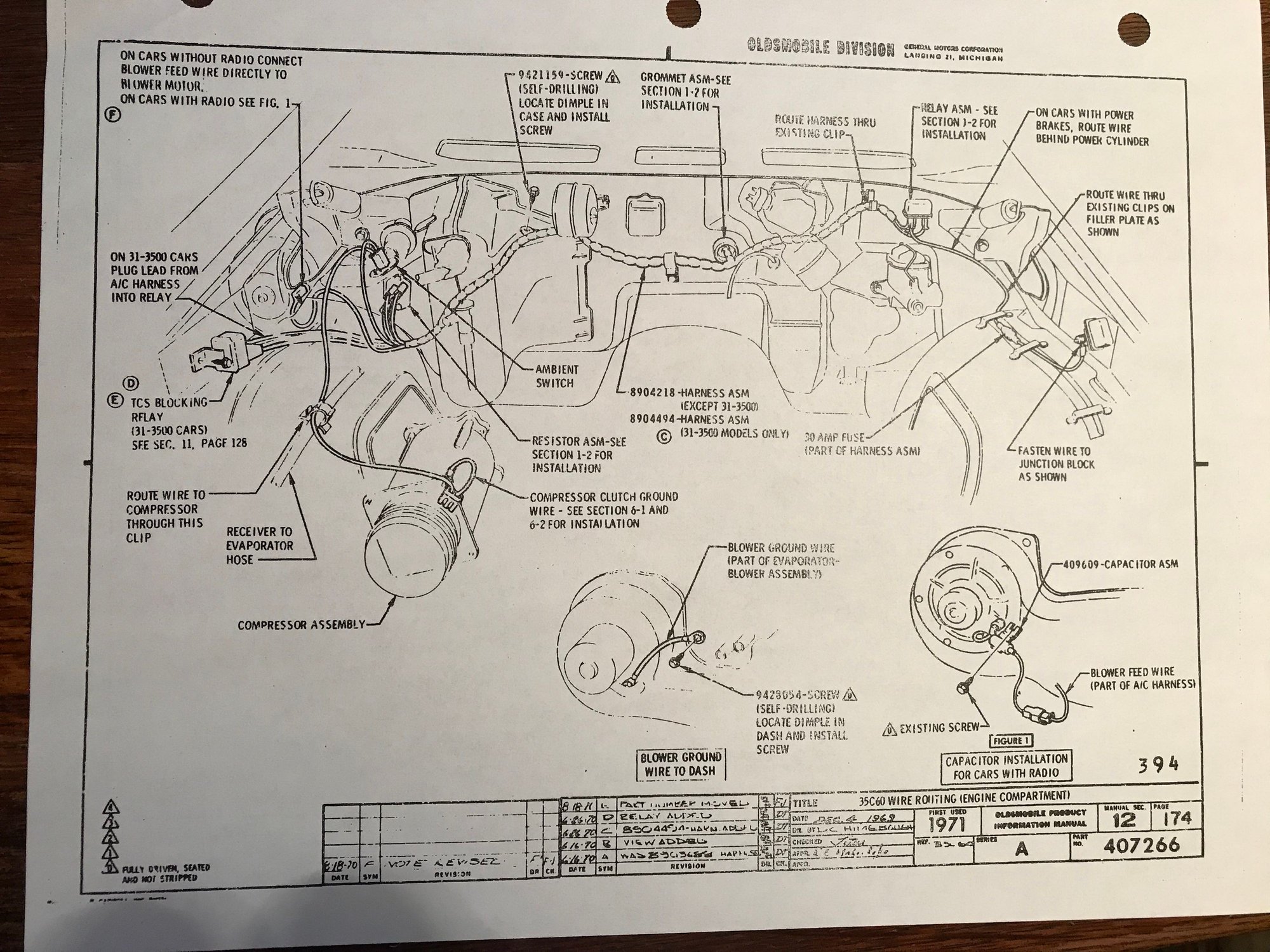

I don't know what additional wiring has been added to your car. If you look at the wiring diagram there is a fusible link that comes off the horn relay. You need to find that wire and see if the fusible link is bad. The circuit breaker you checked thinking it supplies power to the fusebox does not exist in the original wiring, it may be for the convertible top.

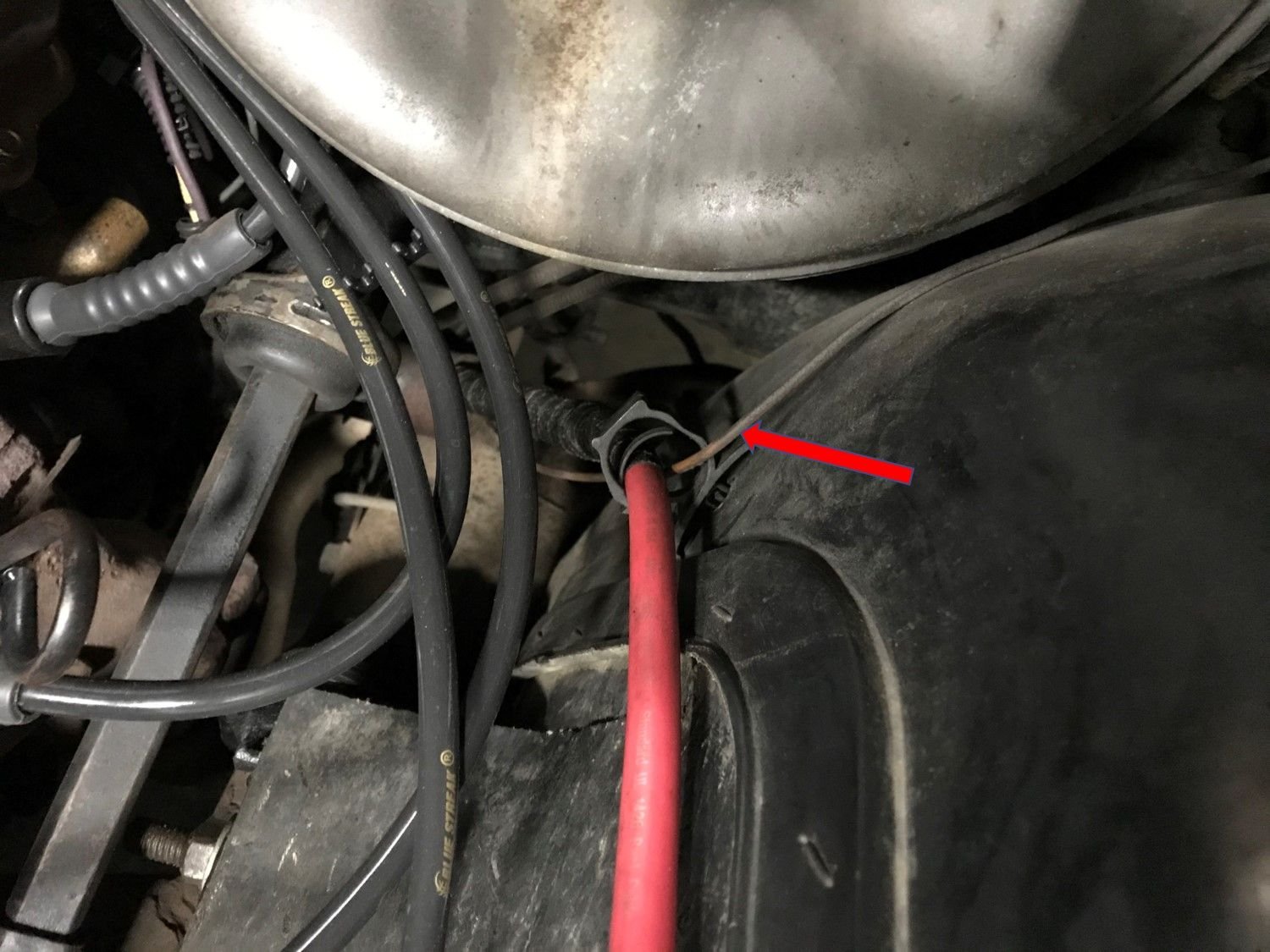

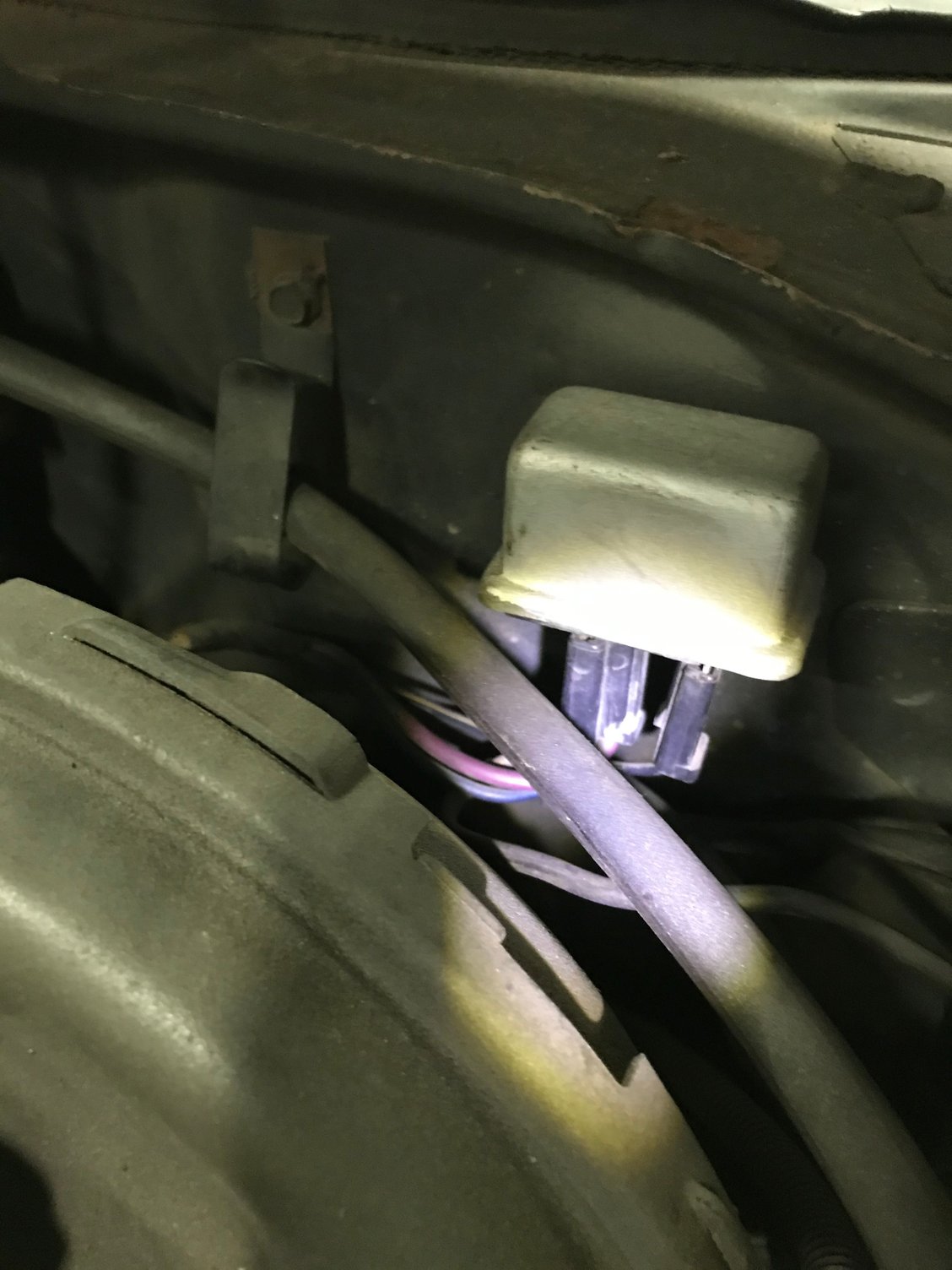

My fusible link is running from the horn relay to the wire identified in the pic. Is that correct?
Old Jul 13, 2020 | 05:56 PM
Posts: 26,014
I have a 1971 CS convertible. I just went outdoors to grab a couple pictures for you. I need to review them and transfer to my PC. Before I do this and before I review my CSM, is the picture you posted upside down?
No sir, the picture is straight...
Old Jul 13, 2020 | 06:12 PM
Posts: 26,014

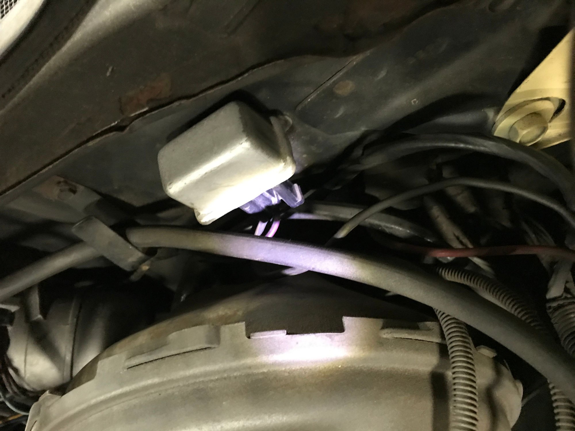

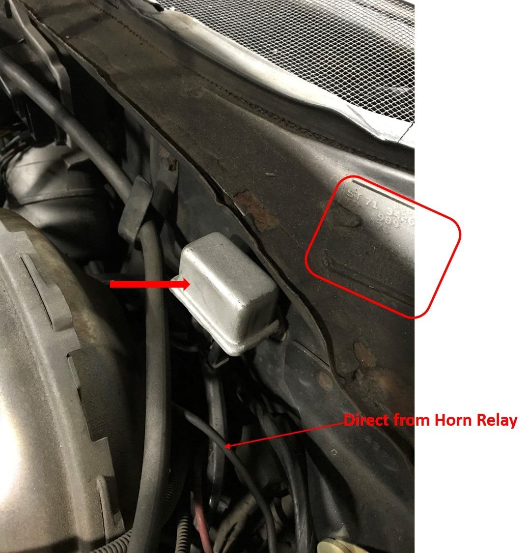

I think your VR is mounted upside down.
Old Jul 13, 2020 | 06:21 PM
Posts: 26,014
I think I might need to get another picture and re-evaluate my fusible link and wires off the horn relay just to be certain. I haven't had to work any issues regarding my fusible link. I have had to re-work some interior lighting on the car after I purchased it, but nothing regarding my fusible link (and I have removed my starter, solenoid, R&R coil, pulled distributor and rebuilt it, etc.). But, never had to evaluate my VR and/or the fusible link. At any rate, note my VR (below) and your image for discrepancies. I'll recheck my wiring just to be certain.

No. That's not the fusible link I have depicted. I'll post a picture of my fusible link. But, your VR is mounted upside down.
Old Jul 13, 2020 | 06:44 PM
Posts: 15,409
That is not a voltage regulator.
Old Jul 13, 2020 | 06:45 PM
Posts: 26,014
Is that the horn suppression thing? What is that thing Kenneth?
Old Jul 13, 2020 | 06:46 PM
Posts: 15,409
I think oldcutlass pegged it.

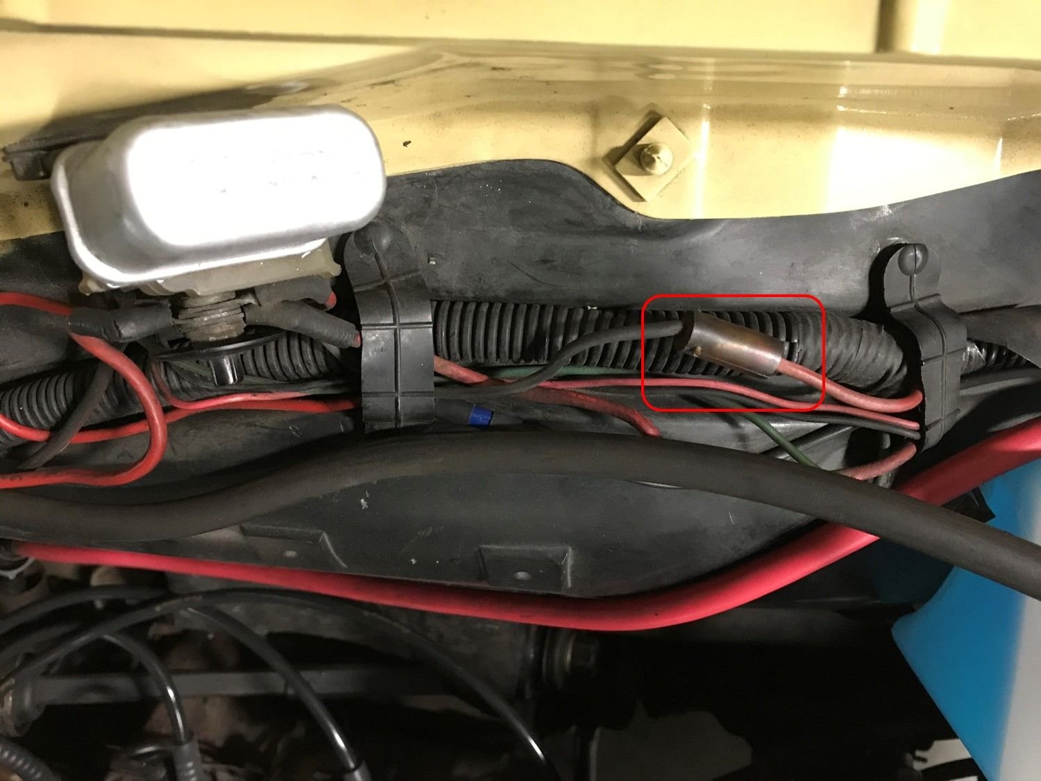

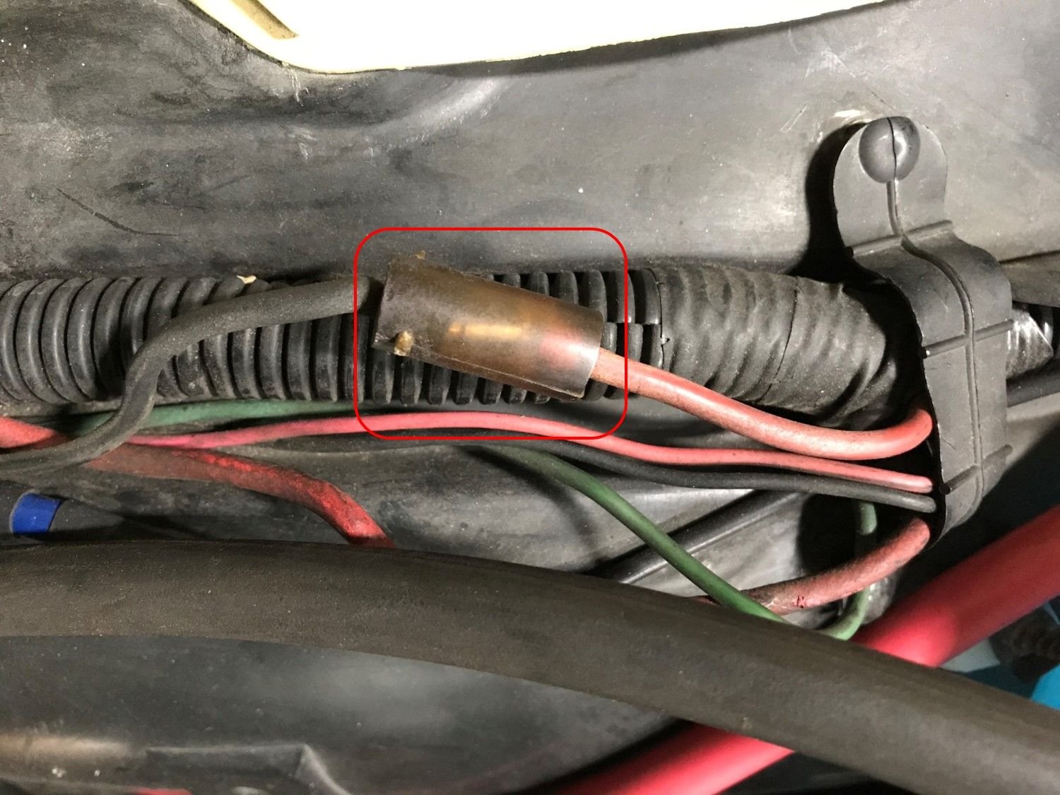

Here is my fusible link. I believe it's the original - not sure. Anyways, it runs into the plastic braided wire loom. I haven't change its routing other than ensured it ran down through the (+) battery cable tie when I removed the starter to change the oil pan gasket.

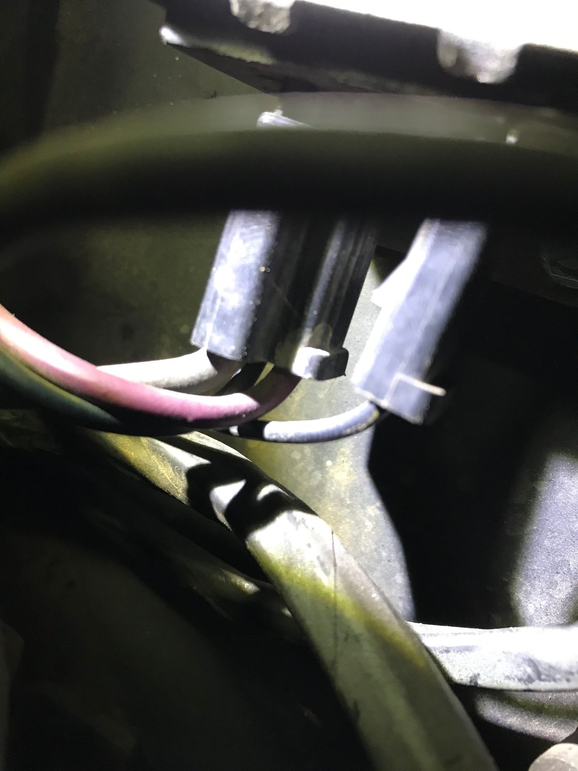

Images of that box which looks like a VR on the firewall and the black wire which routes directly from the horn relay post into that aluminum box.
yes, that is exactly where mine goes too. Im getting 12v at the black wire in the harness. If that is what powers the fusebox, I should have power. Should the purple wire in that harness get 12v too? Mine is currently getting no power.

I'm having to learn as I go here. I found one very small piece of the puzzle though. That aluminum box is a simple relay. It's contained in the Factory Assembly Manual.

As Eric indicated in Post #2 red wire w/ black end you can visualize my fusible link in Post #17 - follow that wire. It should branch/splice. I believe I have captured the essence of which Eric is referring in the wiring diagram.

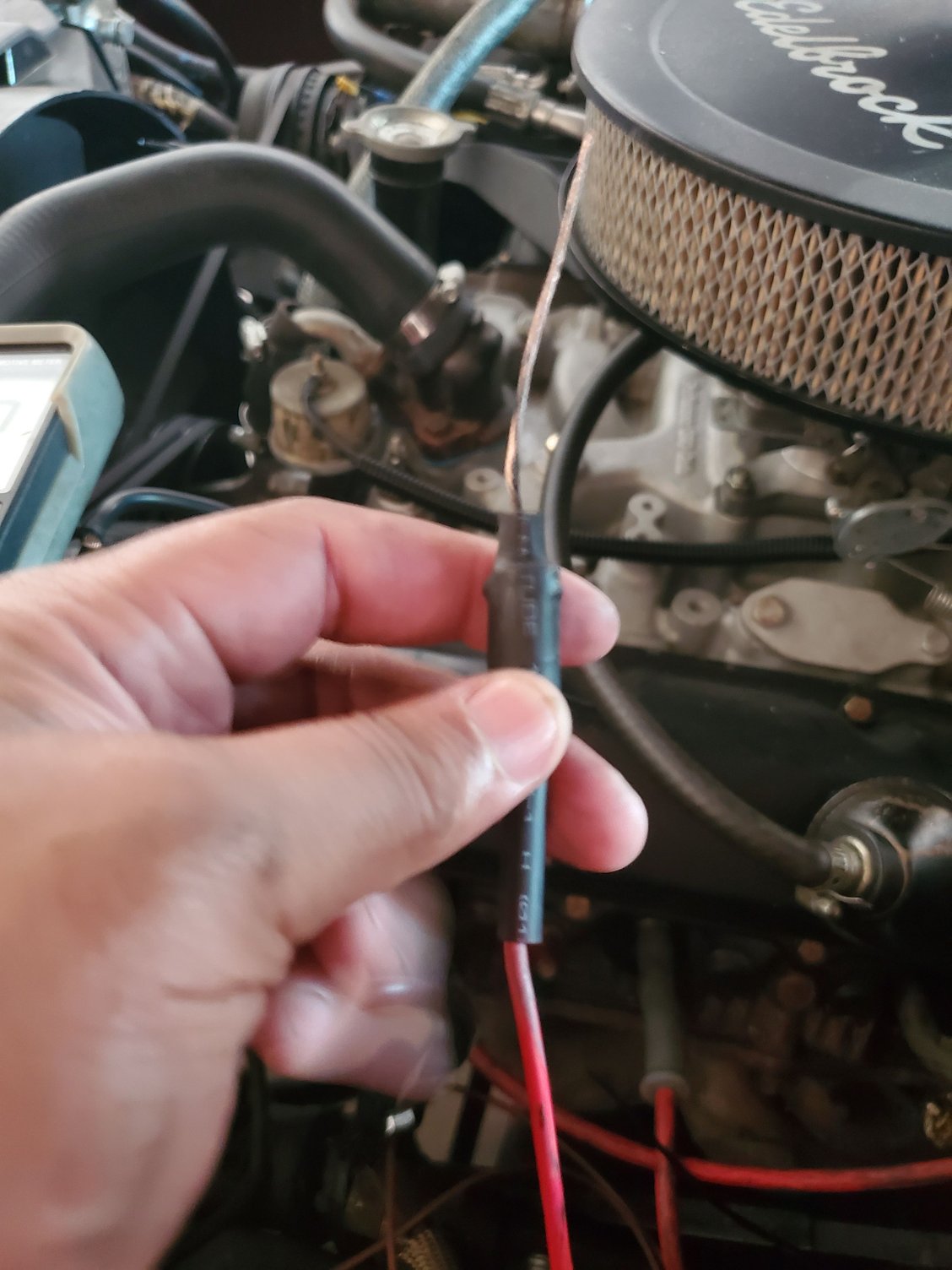

Update: All who said fusible link were spot on. I couldnt see the fusible link because i ran it from the horn relay block through the gap between my wheel well and fender. So I went to the firewall, identified the red wire and started pulling. Immediately there was no resistance so i kept pulling and this is what I found at the end.... Thanks for all your help guys!

So, I can't tell completely but appears someone replaced the original fusible link since I cannot determine exactly what's going on with the wire you're holding. At any rate, hopefully you're reviewing how to make a fusible link. I'll provide you a couple links (1) for creating a fusible link and another (2) for the wire size dimensions to create a fusible link. I'll have to look the wire size chart but it's generally going to be on the order of whatever the normal wire size is (look at the wiring diagram) you will create a fusible link I believe two gauges higher than normal wire size. So, if the normal wire is a 12 AWG you'd create a fusible link piece two gauge sizes higher (thinner), say 16 gauge. I'll try to find the chart or you can look it up yourself. They do, in fact sell fusible link wire - it has a thicker insulation wrapping than normal wire of the same gauge to reduce the chance of fire (albeit thicker insulation).
Your fusible link would be a short piece of wire off the JB (unlike the link below) but the creation of the fusible link is the same:

Reviewing the wiring diagram it demonstrates the fusible link is black 16 AWG and the remaining length of wire is red 12 AWG. As I suggested, the 16 AWG should be of a thicker insulation than a normal 16 AWG wire - this to prevent the black 16 AWG from burning through the insulation to reduce the chance of catching fire. Review the wiring diagram. My black 16 AWG fusible link is ~6" in length off the JB.
