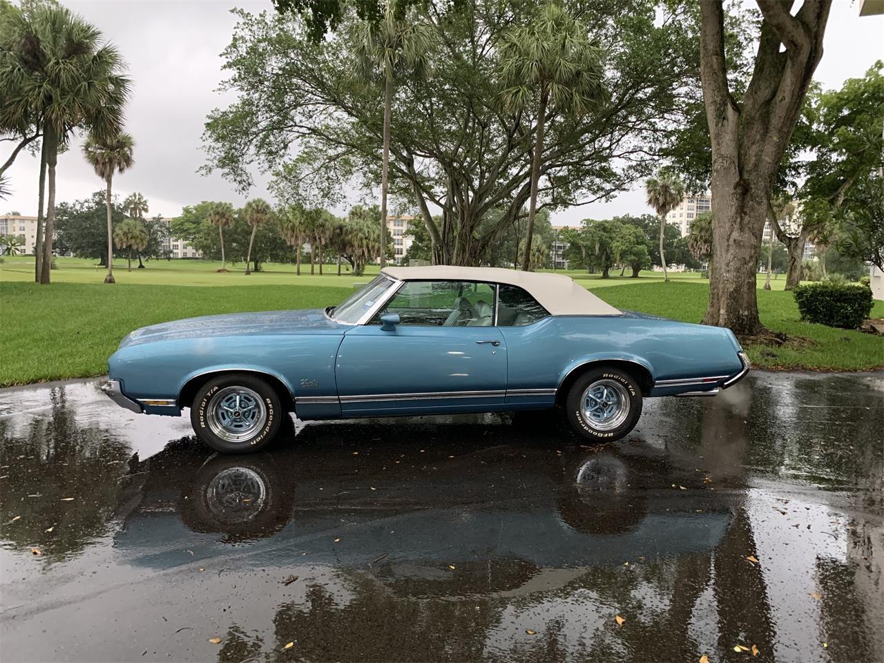

Just picked up this 1971 Cutlass Convertible last Tuesday. Florida car last 3 years. Spent it's life in Texas. Good condition runs great. However did find one issue. When the engine is running all the lights flicker. There is also a clicking from behind the dash traced to the voltage regulator you can hear. Clicking is the same rate as flickering. Everything works. Car is charging, holding voltage overnight etc. I tried another alternator, w/ same result. I installed a new Delco regulator, & that one caused the ENG light to come on w/ key OFF. It also got warm smelling. Any ideas?
